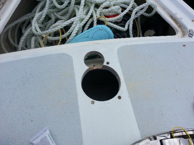

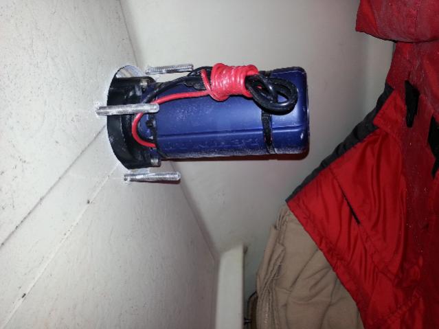

I am just installing my Lewmar V700 windlass and need to buy a dual direction solenoid.
My question is . A Lewmar solenoid runs over 100 dollars .
Has anyone considered using the same solenoid from a winch that is mounted on the front of a truck.
They sure look the same
