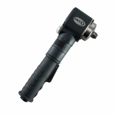

Must remove the drum and gypsy from the shaft in order to remove the motor. I think a Proto 3/8” drive SAE drag link socket 11/16” straight bit will do the trick. https://www.mscdirect.com/browse/tn...kets & Socket Accessories Ad Group - Supplier

The right angle impact wrench with the drag ink socket as per @Terry Cox would do the trick. You'll also be surprised were you would find uses for the right angle impact driver. Its like having a backhoe attachment for your tractor, you wonder how you did without it before. If you don't have the compressor I'd opt for the electric but make sure it is an impact driver, not just a regular electric socket wrench.
