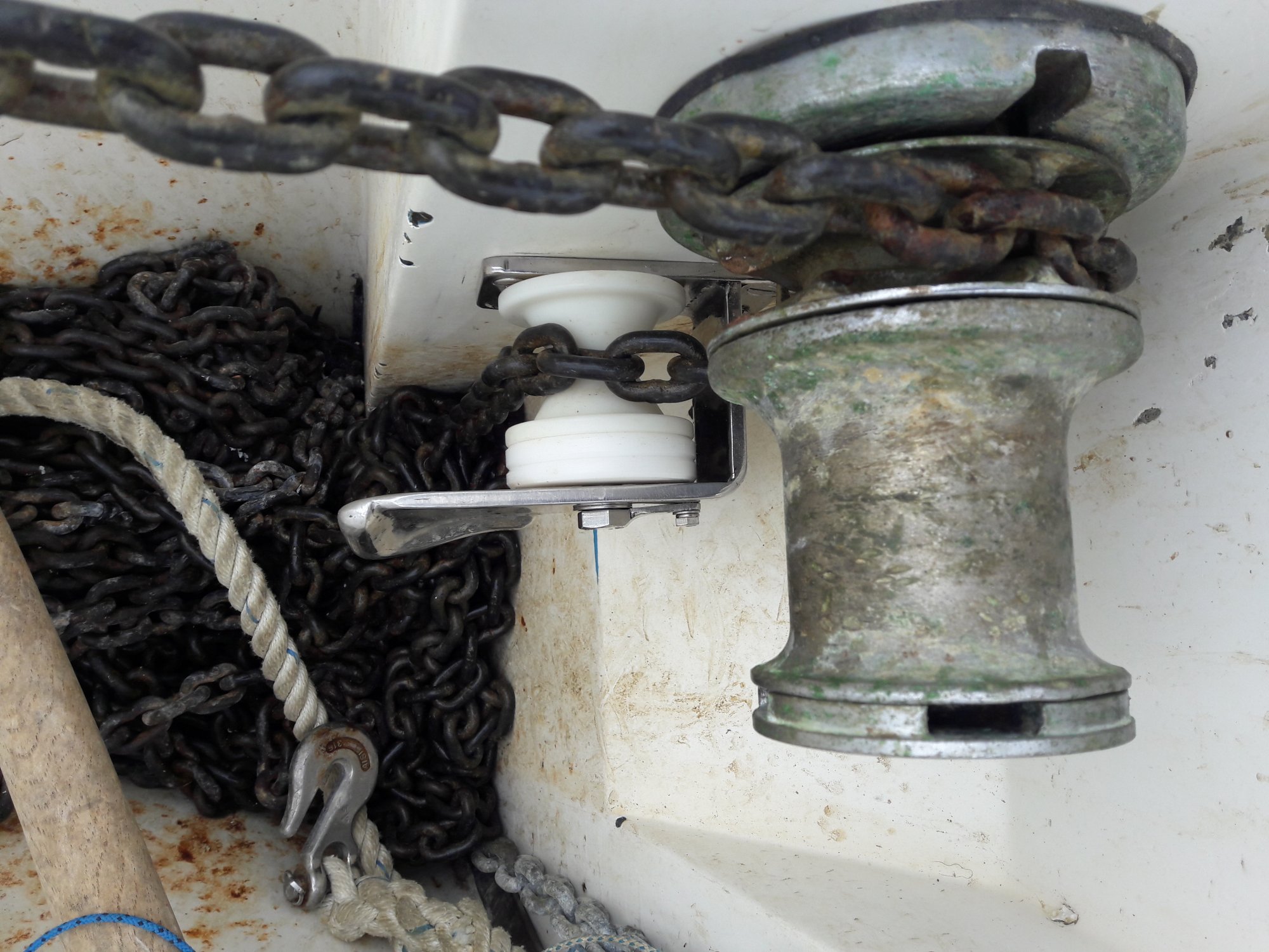

Hi again. Just an update for anyone who might search for this thread. We've solved the problem. The chain was jumping off the gypsy when letting out the anchor because there isn't sufficient drop in the chain locker with the amount of chain the boat carries. Or to put it another way, there isn't enough weight to hold the chain on to the gypsy.
The problem was solved by putting a wheel below and slightly forward of the windlass. When letting out the chain, the chain is threaded over the wheel. This adds about 90 degrees more wrap on the gypsy in much the same way a derailleur works on a bike.
When retrieving the chain, I first pull the chain off the wheel, then get my hands well out of the way before using the electrics on the winch. The chain drops straight down into the locker.
The idea for this came from this link (go down to number 3): maxwell windlass
Here's the rig we made up. We added an extra flange, which ensures the chain won't come off the wheel. The wheel is just a standard one used on bows of small power boats.
