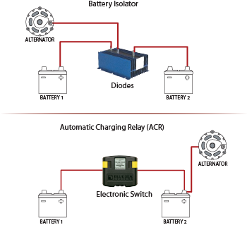

Good question. As suggested by Mainesail, the BlueSeas ACR is a system structure link to charge the start battery. Your House batteries are primary charged in parallel and balanced through the DC Positive busbar. No need for separate circuits. Full charge from alternator of other sources.
"What is an ACR?​
An ACR is nothing more than a fully automatic, voltage triggered, BOTH/PARALLEL switch that closes when charging voltage is present and opens when charge voltage is no longer present. by Mainesail"​
Your start battery is isolated behind the ACR and is saved/used for it's primary purpose the starting of your engine. Limited or no voltage drop.

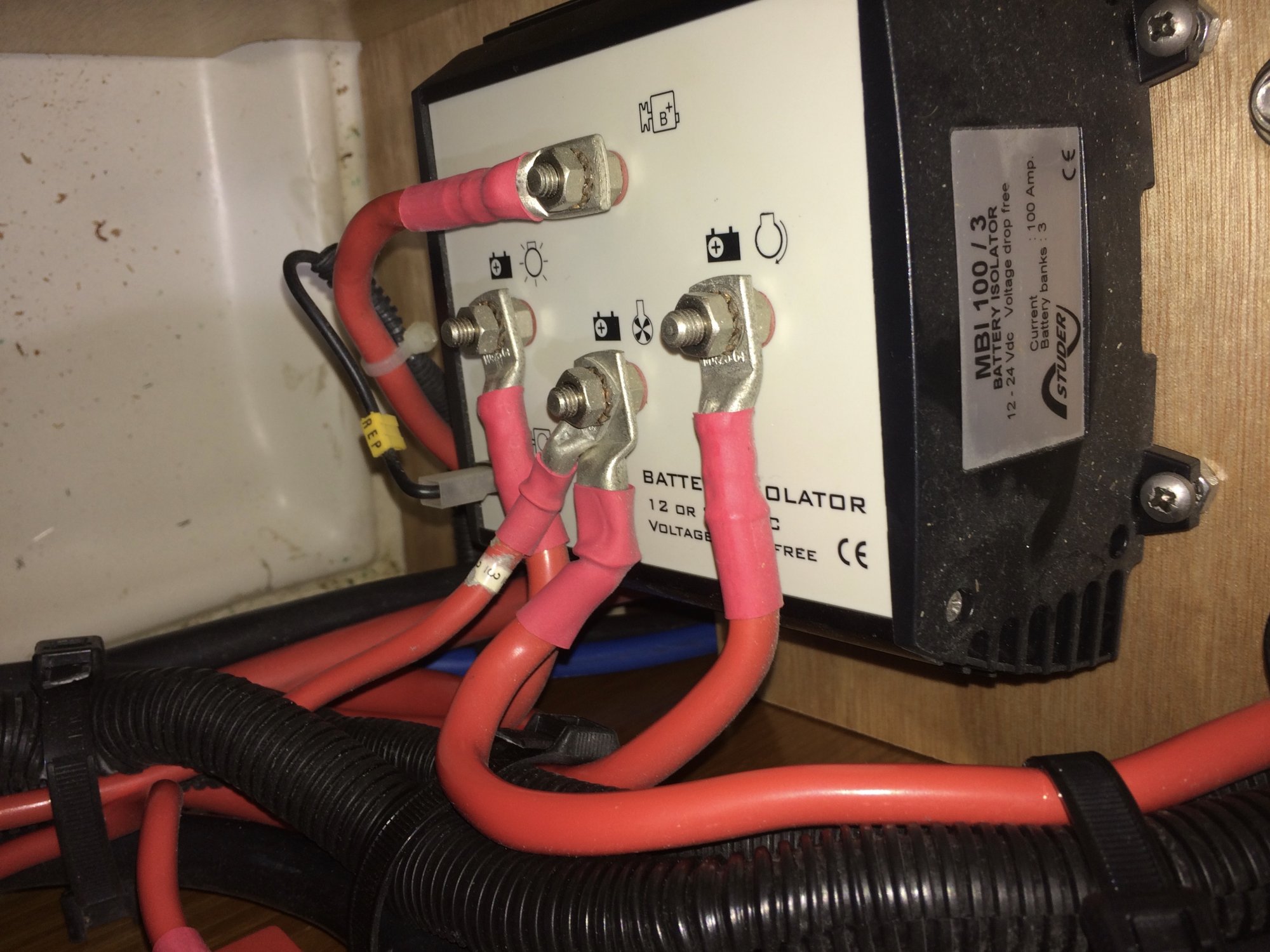

This is my battery isolator. It takes power from the alternator(when is running) and distributes to the three banks evenly. It says "voltage drop free"
Thanks for the photo. While the box says "voltage drop free" that is not exactly accurate according to their website. The website says the voltage drop is less than .4v at 100amps. Better than diode based isolators.

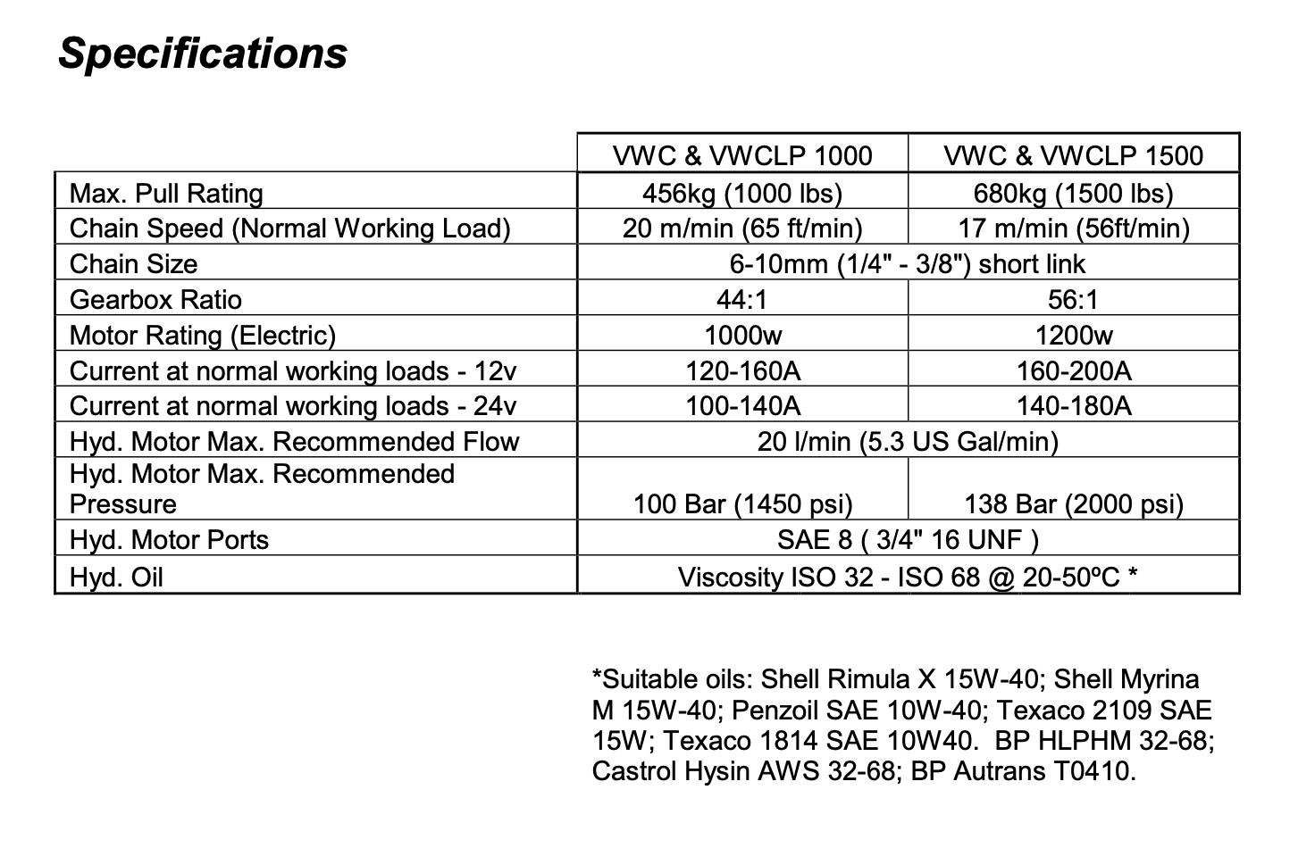

I just got my first boat with an electric windlass and I've been worrying about that very thing, so I did and estimate and you're right, it's much less drain than I expected. For a 5/16 G4 chain lifting a 10 kg anchor from 100 m at 80 percent efficiency it's less than 3 A.h for a 12 V battery. I expected something at least in the double digits.
The motor on our windlass (Maxwell VWC 1500) will draw up to 200 amps at normal working loads. The chain retrieval rate is 56' per minute. With 112 feet of chain out, it will run for 2 minutes, which (if I did the math correctly) works out to 6.7 ah.
The battery issue is delivering that much current in a short time period. Unassisted house banks may not be able to provide that amount of current without a significant voltage drop.

The OP’s isolator, like mine, is FET based rather than diode based. Diodes introduce a relatively high constant drop (around 0.7 V). FETs introduce a lower drop that is variable with current flow. As battery charge increases and current flow decreases the drop becomes negligible.
