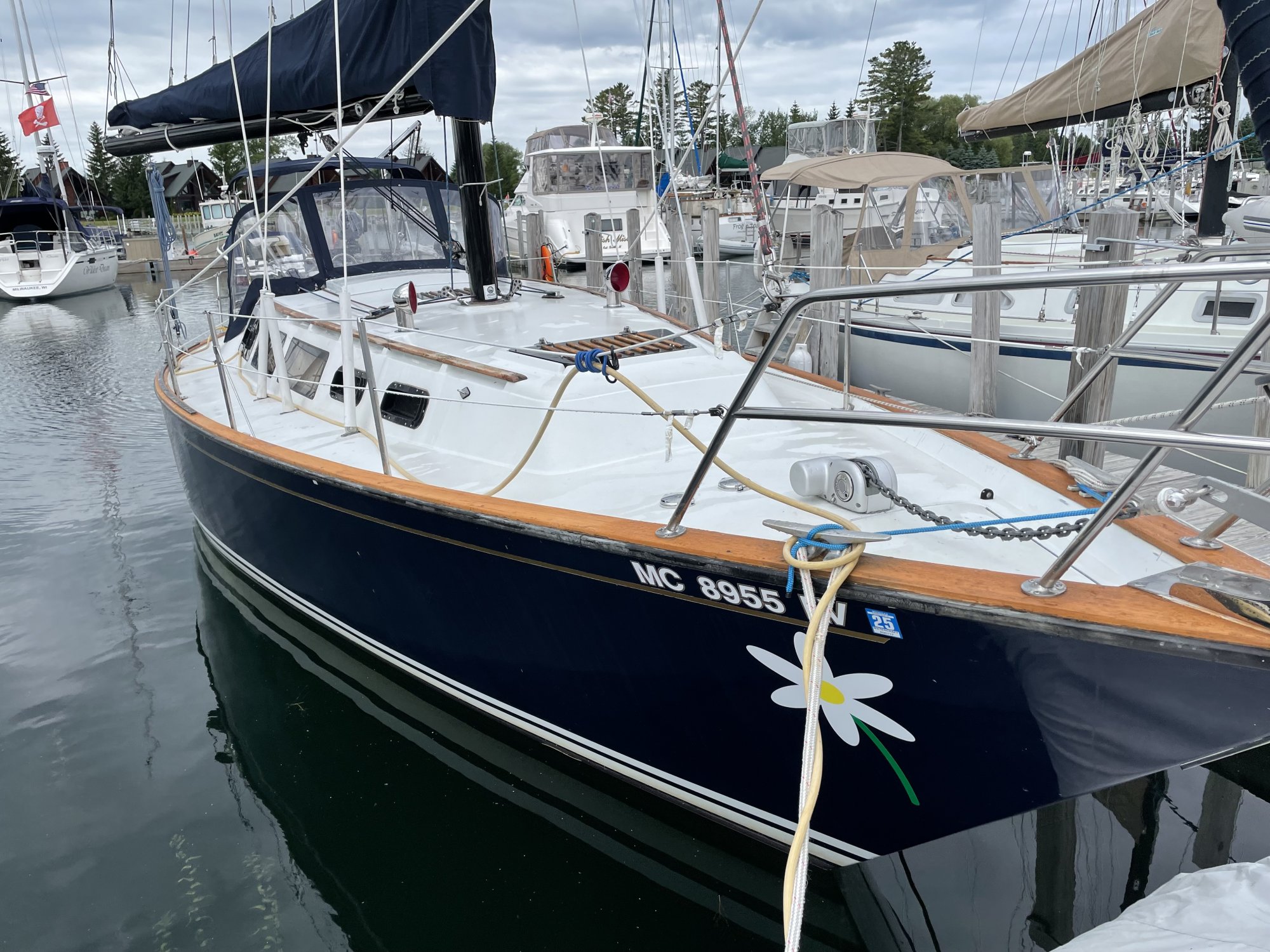

Yes..i split mine fore/aft. The stbd side was glassed into the deck along with more layers on the door. Looks OEM and I can stall the windlass with absolutely no deck movement. I do have to flake…one of the reasons for splitting this way was so I can get access to everything underneath on both sides all the way up.

I put mine behind the anchor locker and it feeds through the deck forward into the locker pretty nicely.
