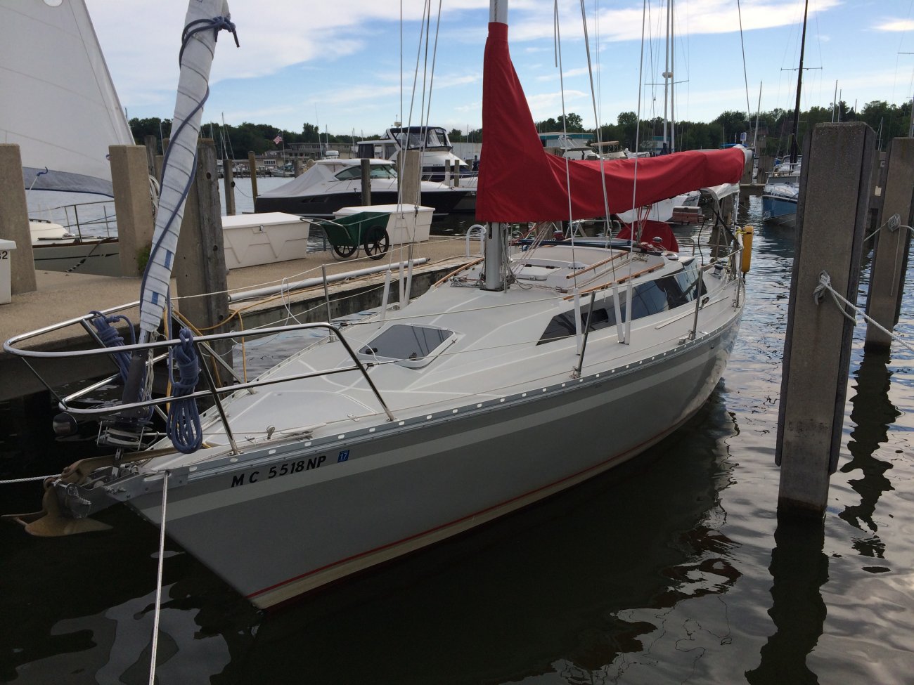

I don’t have a good foredeck photo, but you can zoom in on this to get an idea of the foredeck on the 322.
There is a double anchor roller on the bow. But the anchor locker is a very shallow “pan”.
I don’t think you could mount a windlass without significant reinforcement. As the OP suggested, he would have to create a path to drop the rode down the inside of the bow (I assume to storage under the V berth).
The anchor locker hatch takes up a large portion of the foredeck, and there is precious little room aft of the anchor hatch and in front of the foredeck hatch.

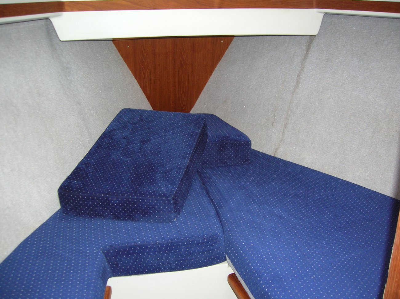

Here are some photo's to assist your discussion. Yes, looks like significant reinforcement needed, and as Greg says, not much space in the forepeak, behind that bulkhead for the chain drop. Maybe you could squeeze a little one in in front of the anchor locker panel but not much drop room below it. I have seen some other boat designs, split the anchor locker door, rebuilding the front half as a sturdy permanent platform, with the back half still a hinged door to store incidental stuff.
Also see "Windlass on ODay 35' in the bigger boat section for several ideas.
