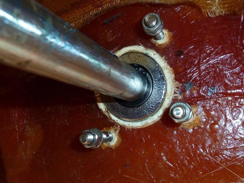

The fix sounds easy just 4 nuts under the bottom plate and than it drops down off everything and a locking clip on the bottom main shaft comes off and than lift the main shaft up and out so can replace the bearing seal and wiper seal.

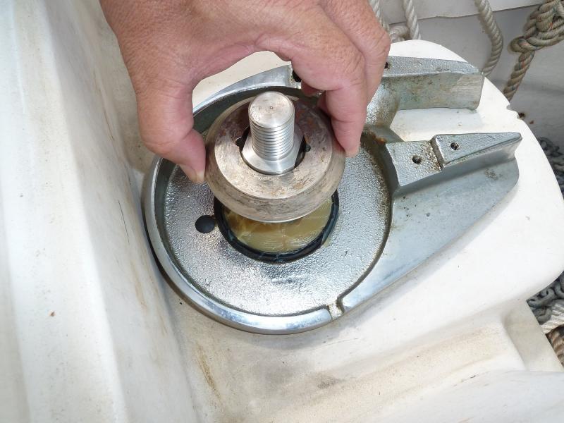

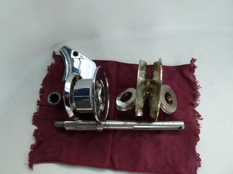

Seadaddler, it's easy to take the shaft out. Remove all parts at top and the motor from bottom. There is 1 C-Clip just above the cage bearing at top and another at bottom (see picture) of bearing holding the shaft. Remove the clips and you can draw out the shaft & bearing. May have to use a mallet/soft hammer to tap it out. Replace the bearing and clean up the shaft. Assemble back and stuff enough grease at top to seal it, preventing water from slipping through.

no problem. let me know should you need more photos or guide to taking it apart. all the parts fitted quite loosey so its easy. most difficult part is the two c-clips. you'll need an inside and an outside c-clip pliers for this.
