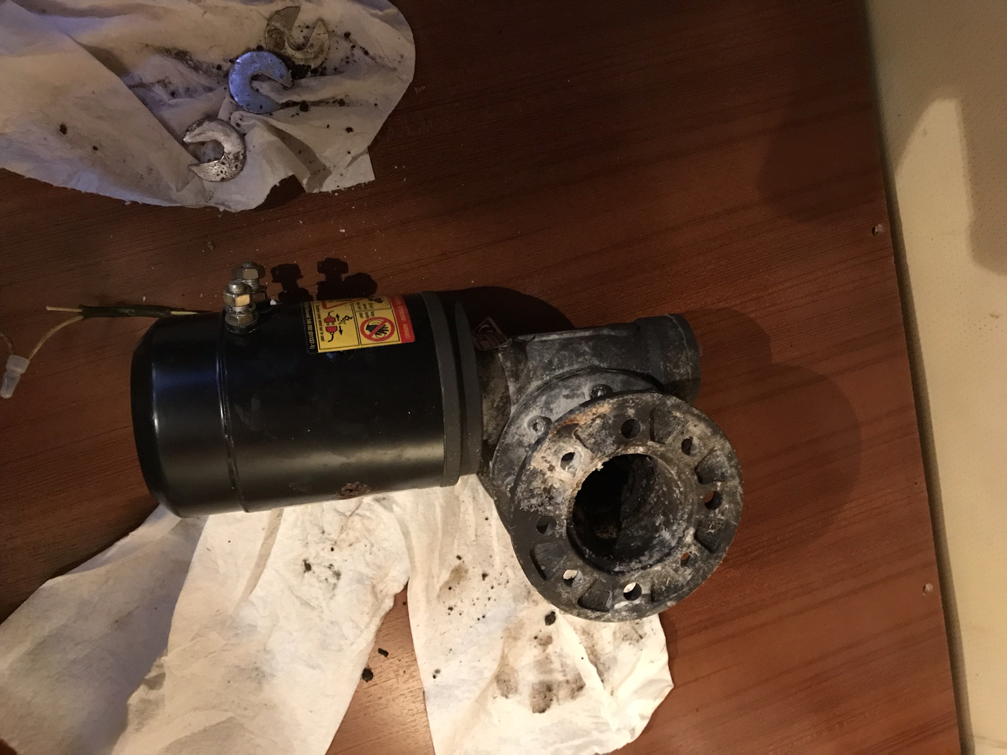

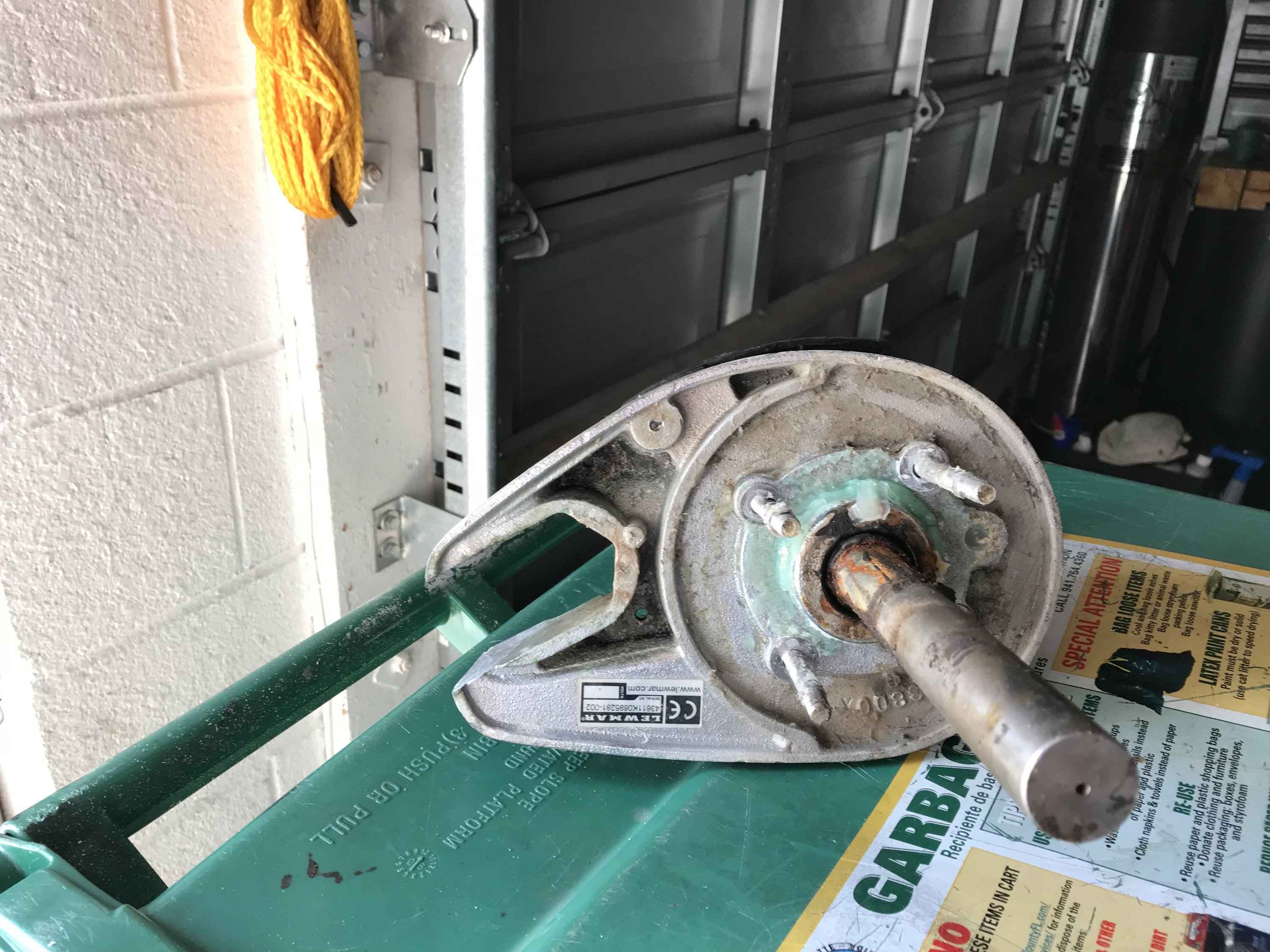

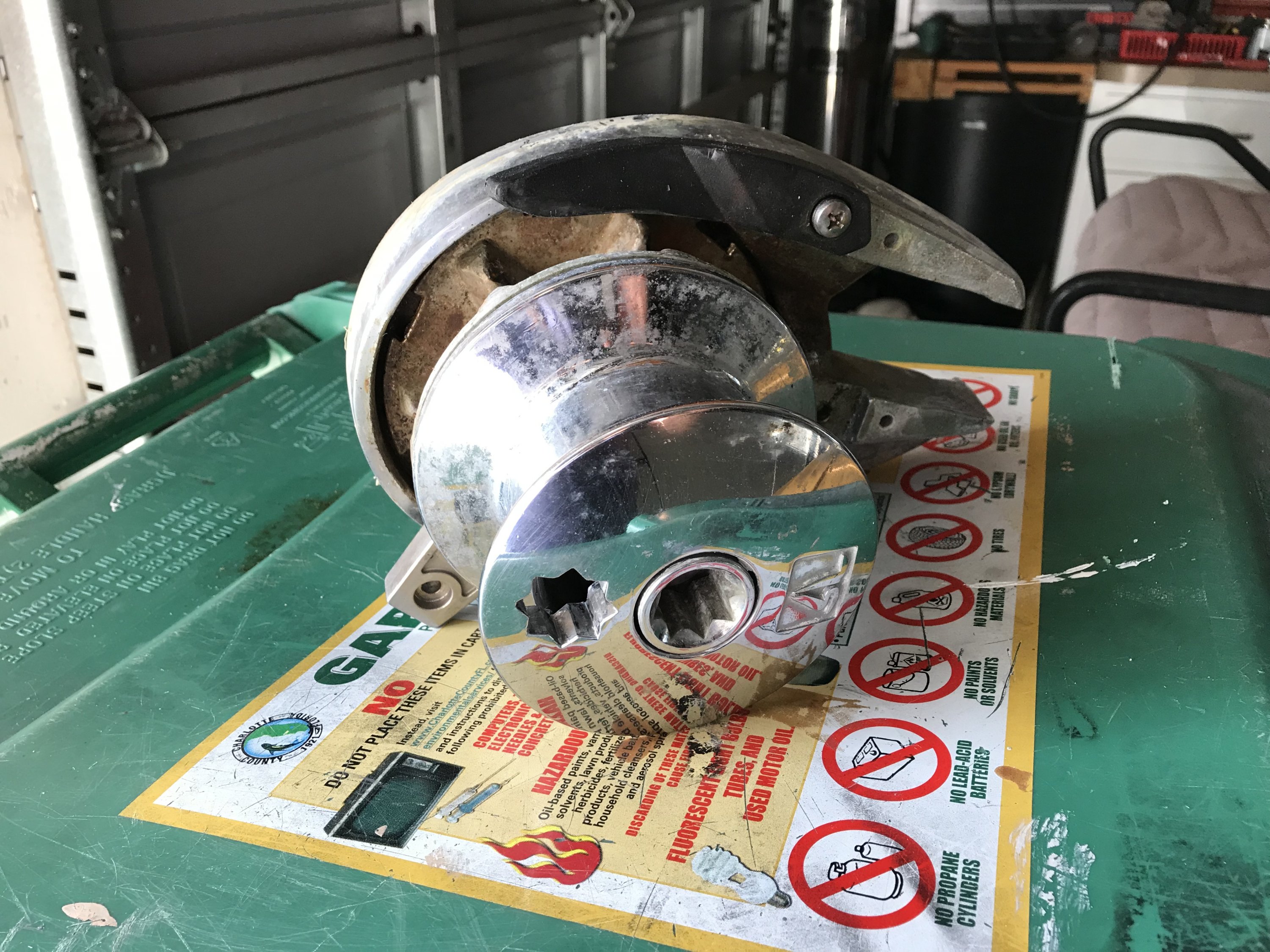

Well I took apart my windlass and now have the 2 parts out of the boat and Home and need to remove the shaft from the upper part and get at the bearing and wiper seal.
I am thinking the shaft with crud and a little what looks like rust is stuck to the bearing and think of putting in a vise up side down and hitting the bottom of the shaft with wood block and hammer forcing the shaft to drop out and than replacing the seal and bearing,
but want to be sure this is the right way to do this and so any body want to jump in and
add advice.

Thanks to Ken 15559 from some past posting by Ken really helped out and found out that there is a C clip
holding the shaft on the top plate.
Mine is really dirty with crud so need to clean around to get at that C clip and thanks again to Ken for
photo's he showed on a past post and he has also helped out with other helpful post so thank thanks Ken
and now I will soon order the kit for my windlass with the new bearing and wiper seal from SL Spares.co.uk
