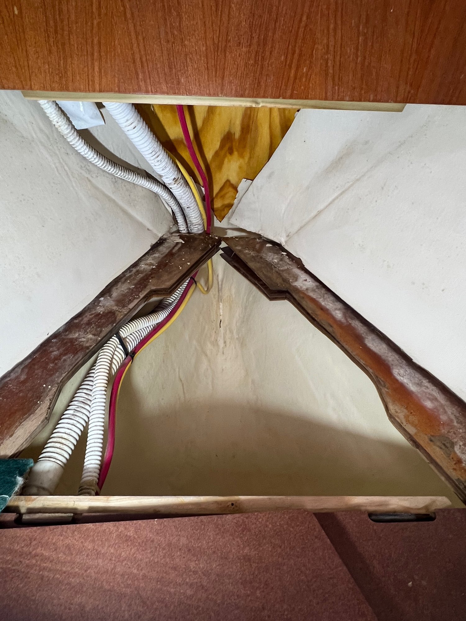

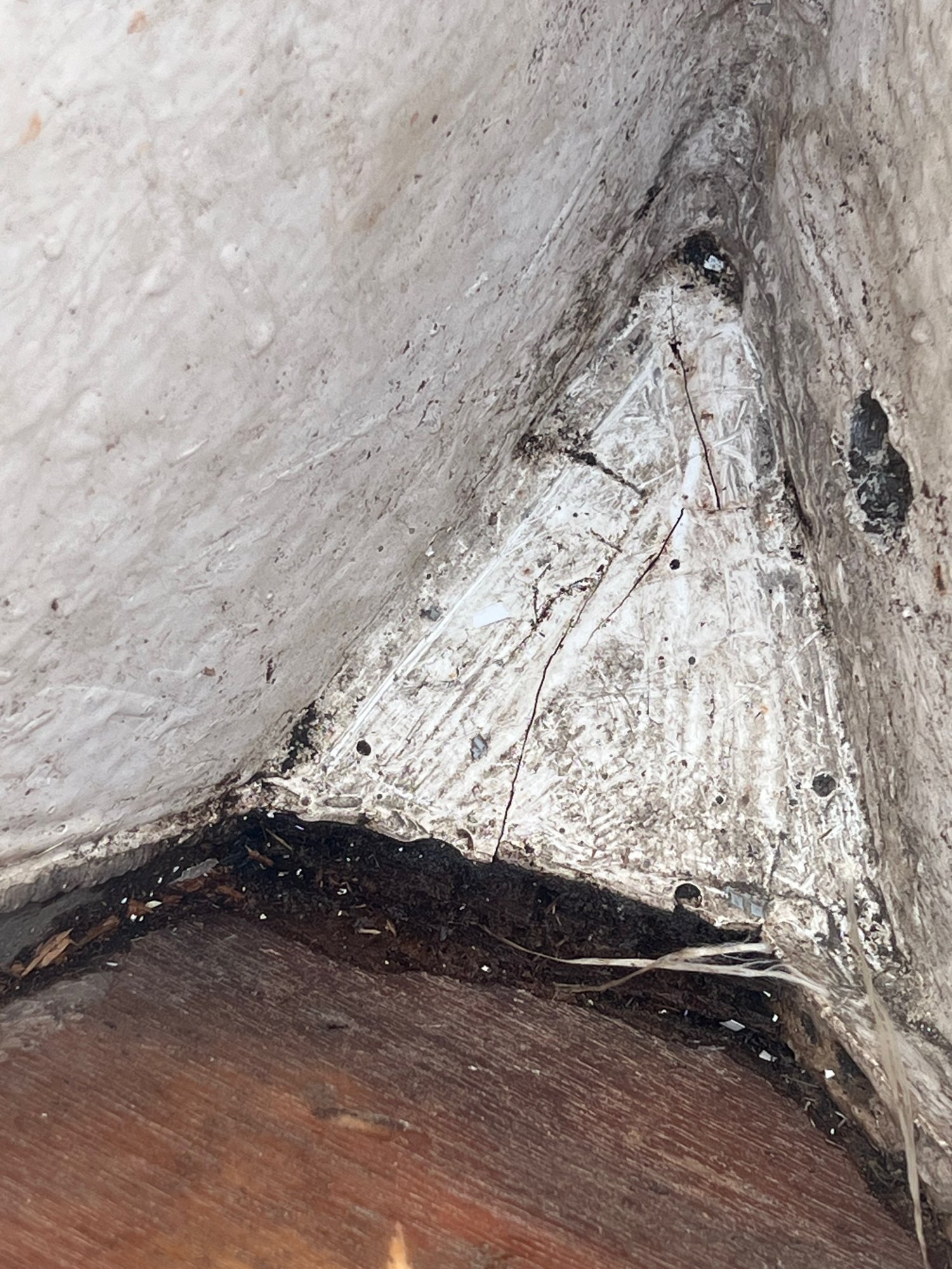

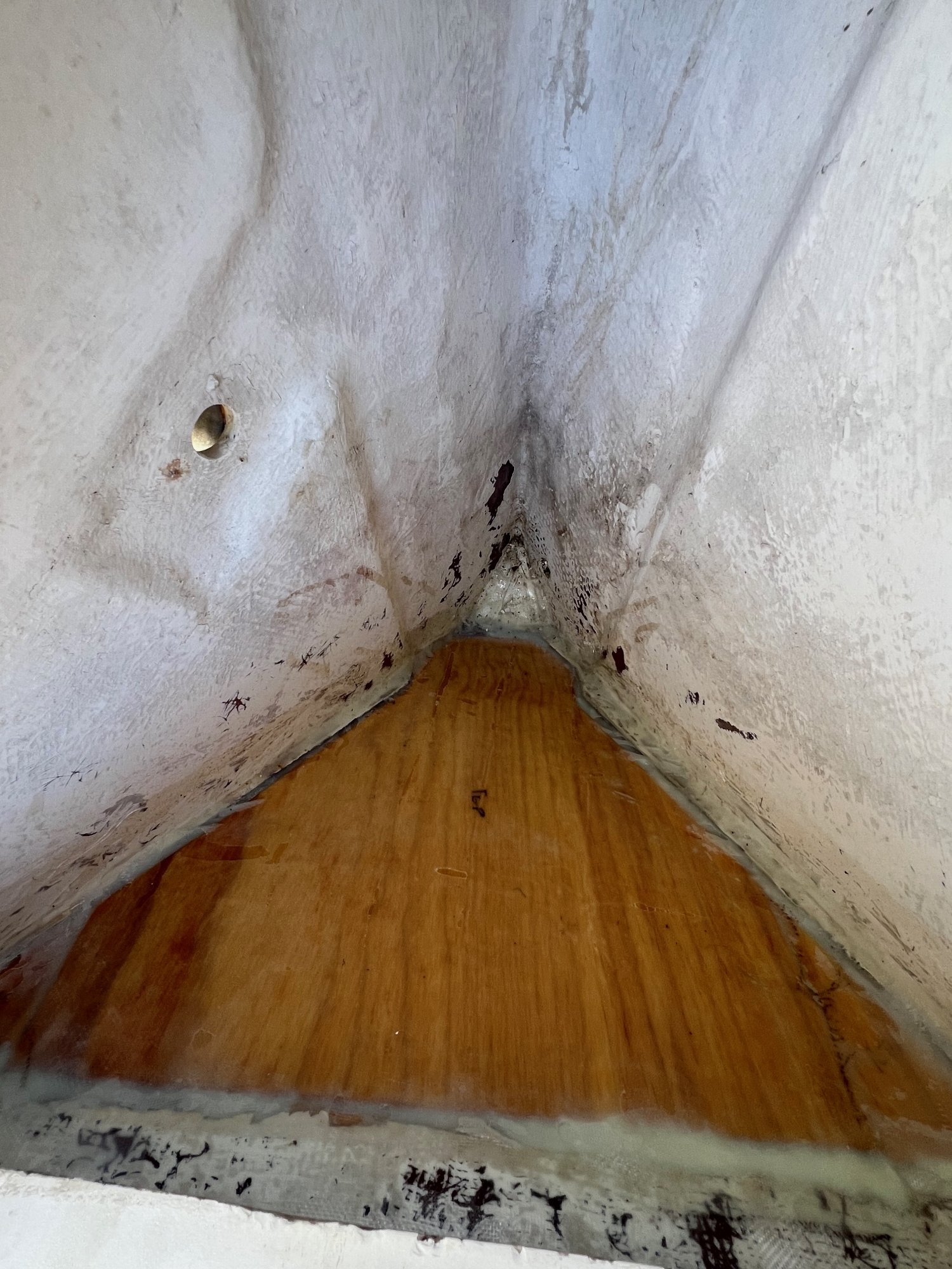

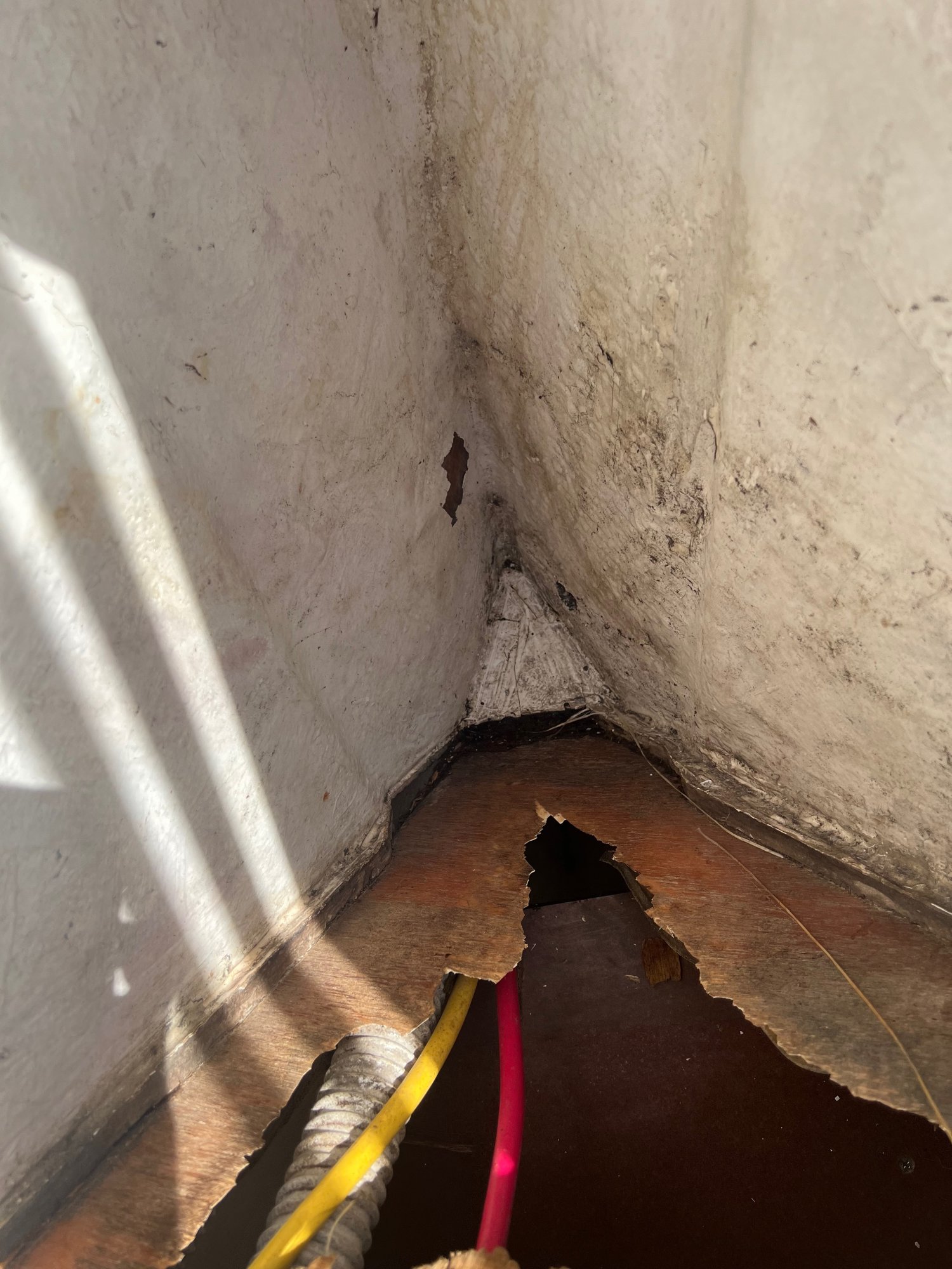

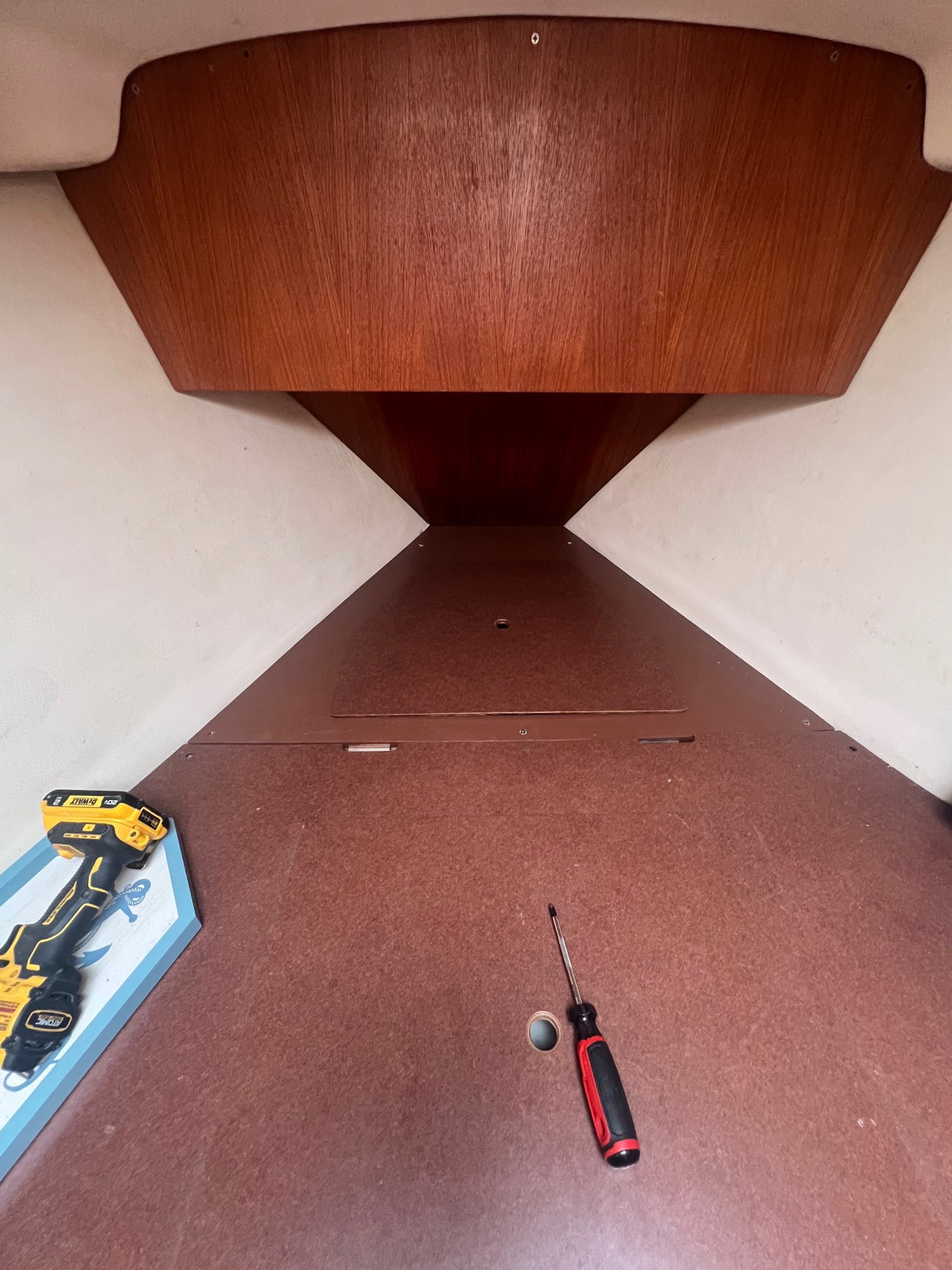

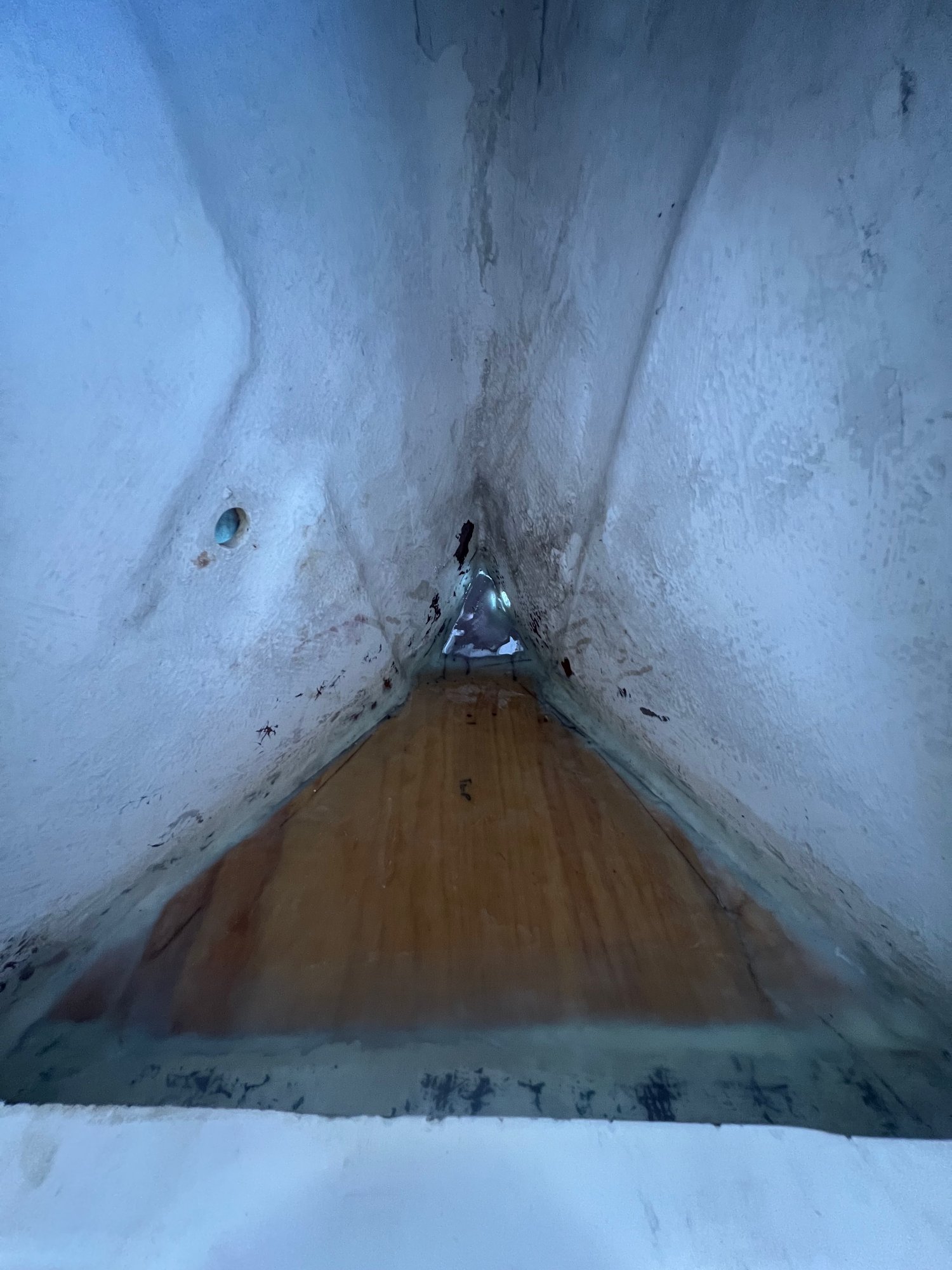

Yes I think there has been a few of us with the problem. I had it on my hunter 326 and fixed it last year. Seems like in the anchor locker they never fiberglassed the plywood , only gelcoated so a scratch lets water in and we know the rest. Mine was pretty well rotted out so it was easy to remove. I may have used a multi tool to clean up the edges on the side but I dont recall, it was easy to get all the old plywood out and on the backside there was some fiberglass backing that I was able to lay new plywood on. It was my first fiberglass job and it was easy and turned out well. Here are some pics. After glassing I used rustoleum topside paint for the interior. also the plywood under the vberth was in bad shape at the point so i traced it and made a new one. Some of the vberth supports that were tabbed in were delaminated so I added wood glue and clamped that up.
LMk if you have any questions

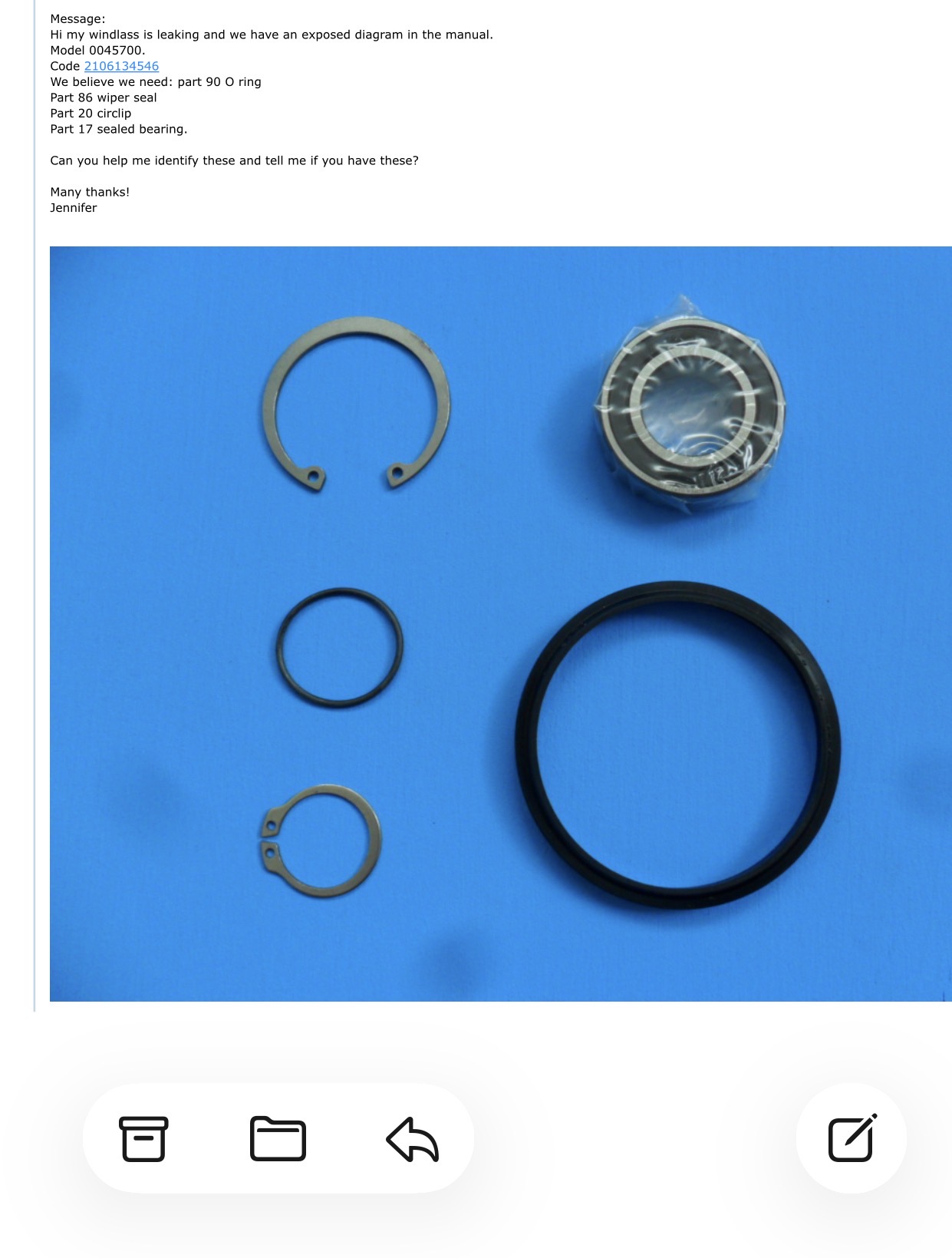

I had the same issue. Very carefully I determined it was not the seal around the windlass but the actual windlass itself. If I poured water directly into the center opening, water would enter the v berth.
Looking at the Simpson Lawrence manual, we ordered these parts from SL Spares in Scotland. I recently ordered a new control arm from p2 marine, so keep them in mind as a potential resource as well. Lewmar took over simpson Lawrence, but does not have their parts. 2005 Hunter 33. I needed to look up anchorman Sprint 900 and Sprint Atlantic which seemed to be the model.
