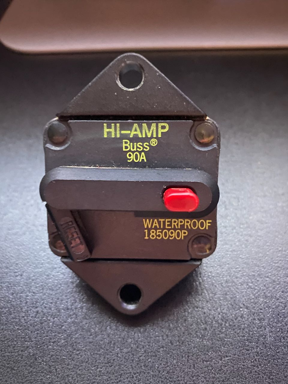

Unfortunately my windlass breaker is shot and needs to be replaced. Our owner's manual calls for a 90A breaker - however windlass draw is 1000W @ 12V ~83A. Shouldn't this then be a smaller 80A breaker? The original breaker is discontinued with now only available options 80A or 100A if I am to maintain the original Lewmar mount. I am thinking the 80A is appropriate?
Of course I don't have the exact model of our windlass as I'm not at the boat. I suppose it can wait until the weekend.

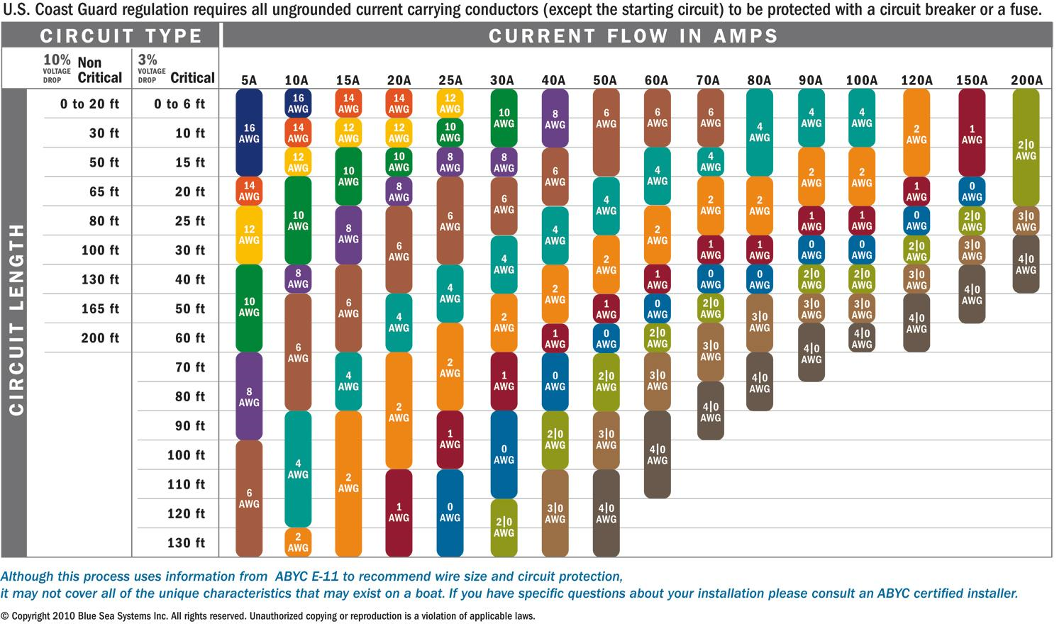

The coast guard tables are super helpful - thank you - book-marked! I need to check on my specific windlass current draw. The 2AWG cable length should be <40ft round trip, so the 80A may do it. The replacement bussman 285 series is ~$60 for either the 80A or 100A and the original discontinued bussman 185 series for 90A is $147.
