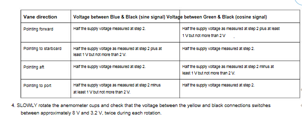

Ha! Excellent question. Let's assume it is. In general, the speed outputs on these things are simple pulses. In your case, you have a fancy one - 2 pulses per rotation. It looks your wind vane has a 5-conductor cable, and I'm guessing those are run down through the mast into either your display, or something called an iTC-5 converter. Have you checked that connection? I found some simple tests in the unit's service manual on pages 7 and 8. Here is the link. https://www.manualslib.com/manual/962657/Raymarine-Wind-Vane.html?page=9#manual
Here's an excerpt (sorry it's tiny, but the manual wouldn't download, so I just snipped it).
You need step 4.
Good luck.
