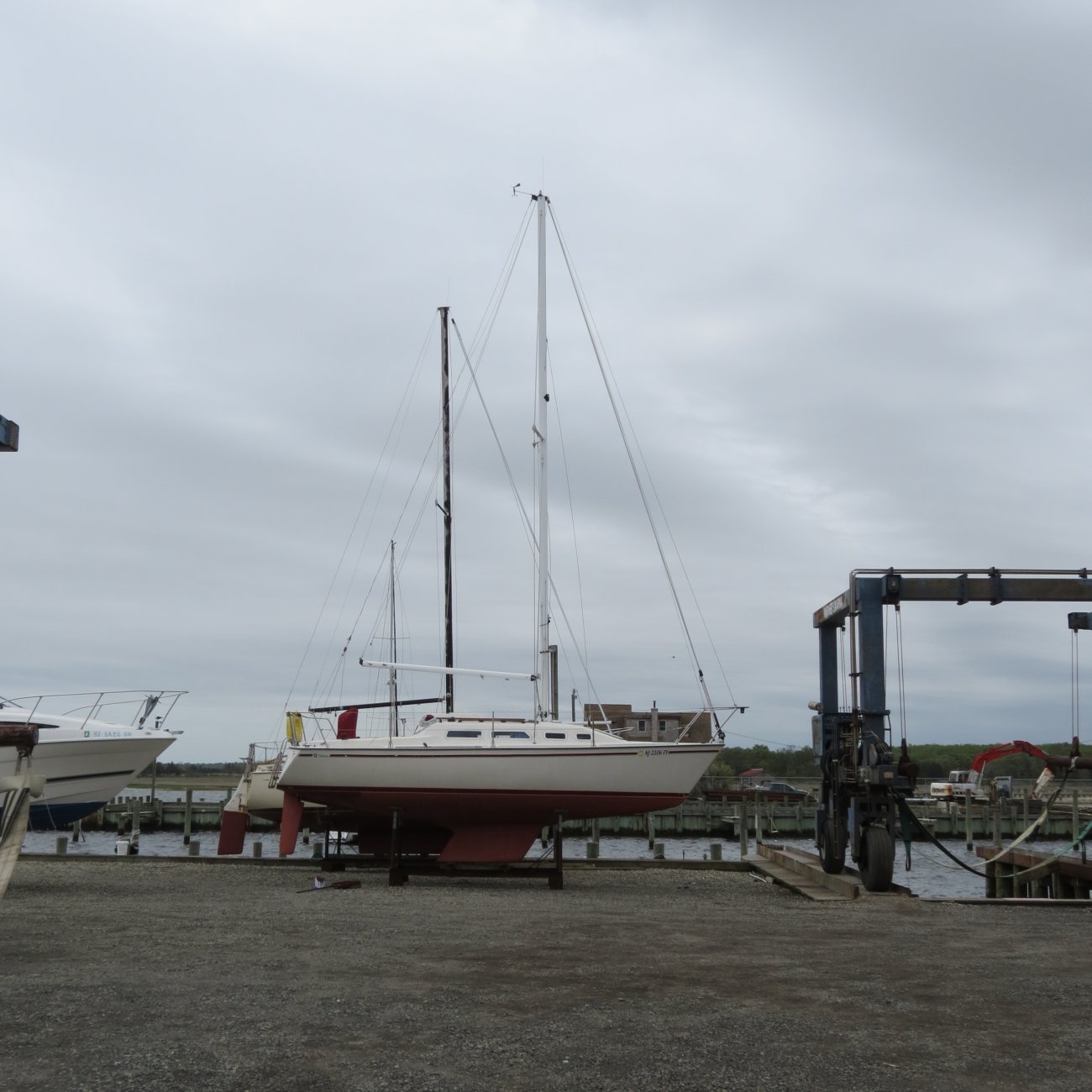

I did a survey here at this marina, all the sailboats have them facing forward. Four ospreys in the trees across the creek but not interested with sitting on mastheads. I just did a list for repairs when we haul next week and transducer fixing is on it.
