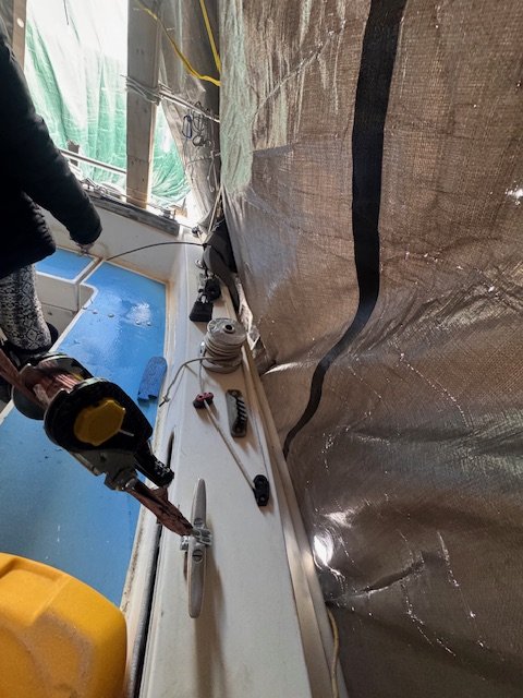

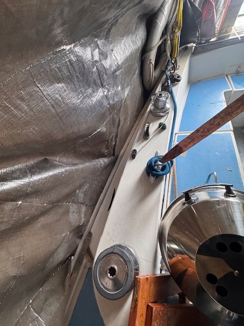

My Pearson 30 has 2 sets of winches.
The ones fore for the head sail and the aft ones for the spinnaker.
They both are the same, so do I really need 2 sets?
I am trying clean up the cockpit and get a clean running rigging set up
I am also trying to get the best line routing for the aft traveller lines.
I will resize my pictures and post them later to show what I am working with at the moment.

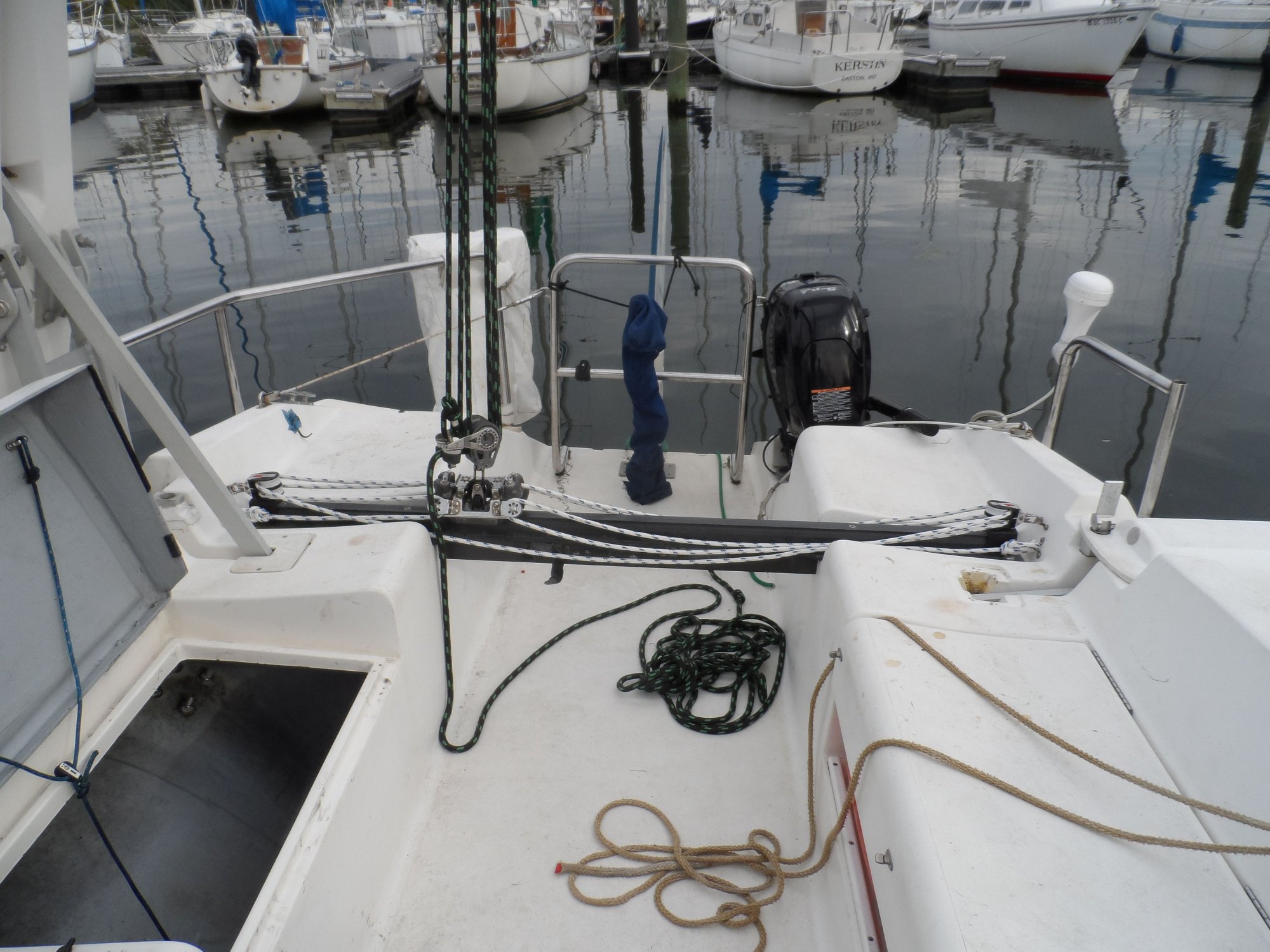

Now how about the traveller lines?
Mar 26, 2011
4,049
Corsair F-24 MK I Deale, MD
Ok, all very good points, thank you all so much
What is the question?
If you would like to do relaxed sailing using just the sheet and the vang, center the traveler, coil them up, and leave them out of the way.
Additionally, many travelers can be rigged with a continuous control line, such that there are no tails. I have done this on every boat I have owned. Depending on the set-up, you may need to add a pair of blocks to direct the line. You will have a loop of slack in the middle, but no long tails and no tangles.
(Continuous traveler, no tails.)
If you want better control of sail shape and easier adjustment in breezy conditions, uncoil the traveler lines and use them.

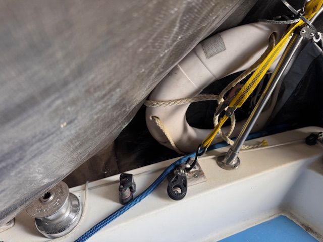

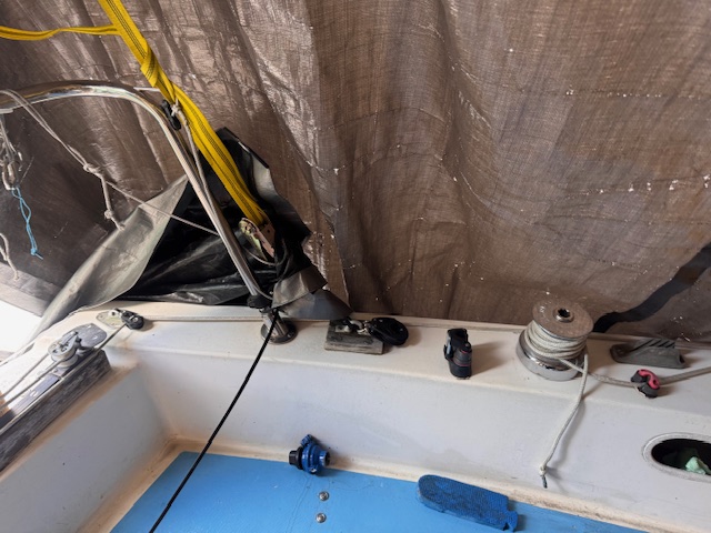

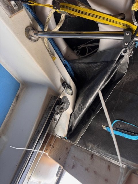

I bought and used the boat for the last 4-5 years, I am just wondering how to make her better, easier to sail.
My wife is new to sailing, so I am really trying to make it fun for her as well and for her not to loose interest; so I am kind of solo sailing.

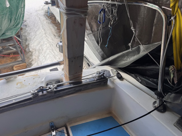

My boat has been retrofitted by a previous PO to a wheel instead of the original tiller, so the traveller has been moved to the transom, so when at the wheel I have the back stay and mainsheet around my head at all times (fun) so that is part of the reasons I want to modify the routing of the lines, so I /we can enjoy the boat more.
I thought of going to mid boom sheeting, but too much investment to do. So I am open to suggestions

That bit of context helps quite a bit. And, it helps me understand the photos.
You've already thought about mid-boom sheeting and ruled it out. I get it. And, I'm betting the sheets near your head are more than an annoyance and you've already considered the danger of that. A couple of things aren't clear from the photos. First, I can't tell where your wheel is. Second, I can't tell where, on the boom, the sheet is attached.
Since you mention the sheet is near your head, that suggests the wheel is well aft, relative to the end of the boom. But, looking at pictures of P30s, I can see why it would be configured that way. It looks like the end of the boom would be right about where you would want to put a wheel. With the traveler on the transom, I can see your dilemna.
Have you considered an adjustable mainsheet bridle and doing away with the traveler? This would put the mainsheet in a much safer and less annoying position. Possibly (but not necessarily) combined with a vang, you would still have good sail shape control.

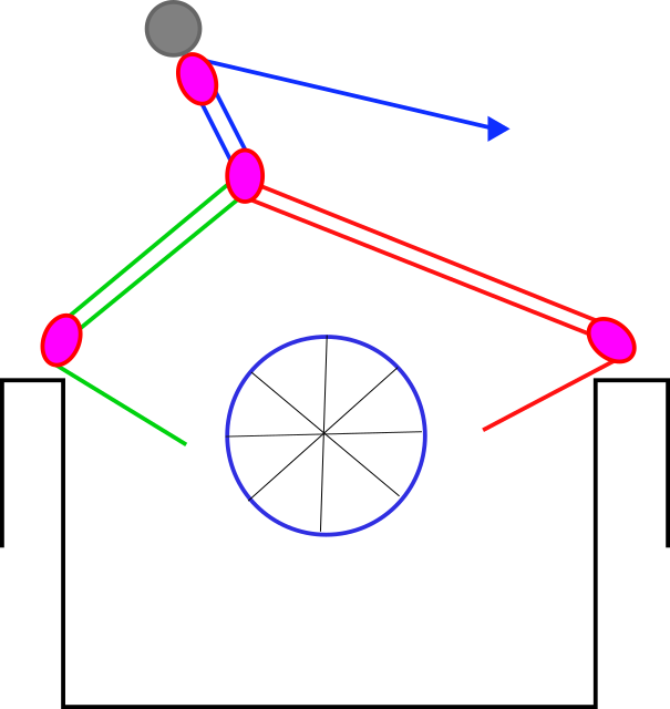

You might have a hard time finding much info. It is more common on some sailing dinghies, but I have seen this on a P30 and some larger boats. It isn't a common solution because I think the main use-case is to get the mainsheet out of the way and controlling sail shape without the clutter of a traveler and/or vang - more of a problem on smaller boats, typically. A variation on this that combines the bridle with the mainsheet is sometimes called a "Crosby rig". This gives you less control but is wonderfully simple. Probably not what you want, but it might help you visualize this.
There are several variations on the idea, but basically you have an upside-down "V" that forms the bridle. One line runs from the top of the "V" to either side of the cockpit. At the top of the "V" is usually a block and the mainsheet is rigged overhead. You can independently adjust either side of the bridle to effectively perform the same job as a traveler. Some people have them rigged cleverly so that they can adjust the tension of the "V" with one control and the port/starboard position with another - which makes adjustment more user-friendly, but does the same job as two independently-tensioned lines.
The reason I suggest this is that you can position that bridle anywhere - forward or aft, provided you establish strong attachment points.
Here's a simple diagram. The grey circle is the boom. The pink ovals are blocks. The blue line is the mainsheet and it just goes to wherever you want to route it - lots of options there. In your case, I would use a single bridle line instead of two independent lines. In that configuration, the length of the bridle is fixed, positioning that overhead block at a fixed height. Adjusting the bridle line just allows you to move that to port and starboard - like having an overhead traveler.

Agreed. If you go back and look at his photos, you'll see (probably) why he asked. The transom location and the way the sheets come out pointing overboard look like they are a bear to actually use. As you point out, there are many other better ways to make this work, involving hardware. My post was for anyone with dumb traveller layout and/or hardware who wanted to use it without any upgrades. Most folks, for example, say "It's so hard to pull it uphill." OK, so drop it first... These come from folks with old Nicro curved travellers or Garhauer 3:1 before they go to Garhauer 6:1. :biggrin::biggrin::biggrin:
