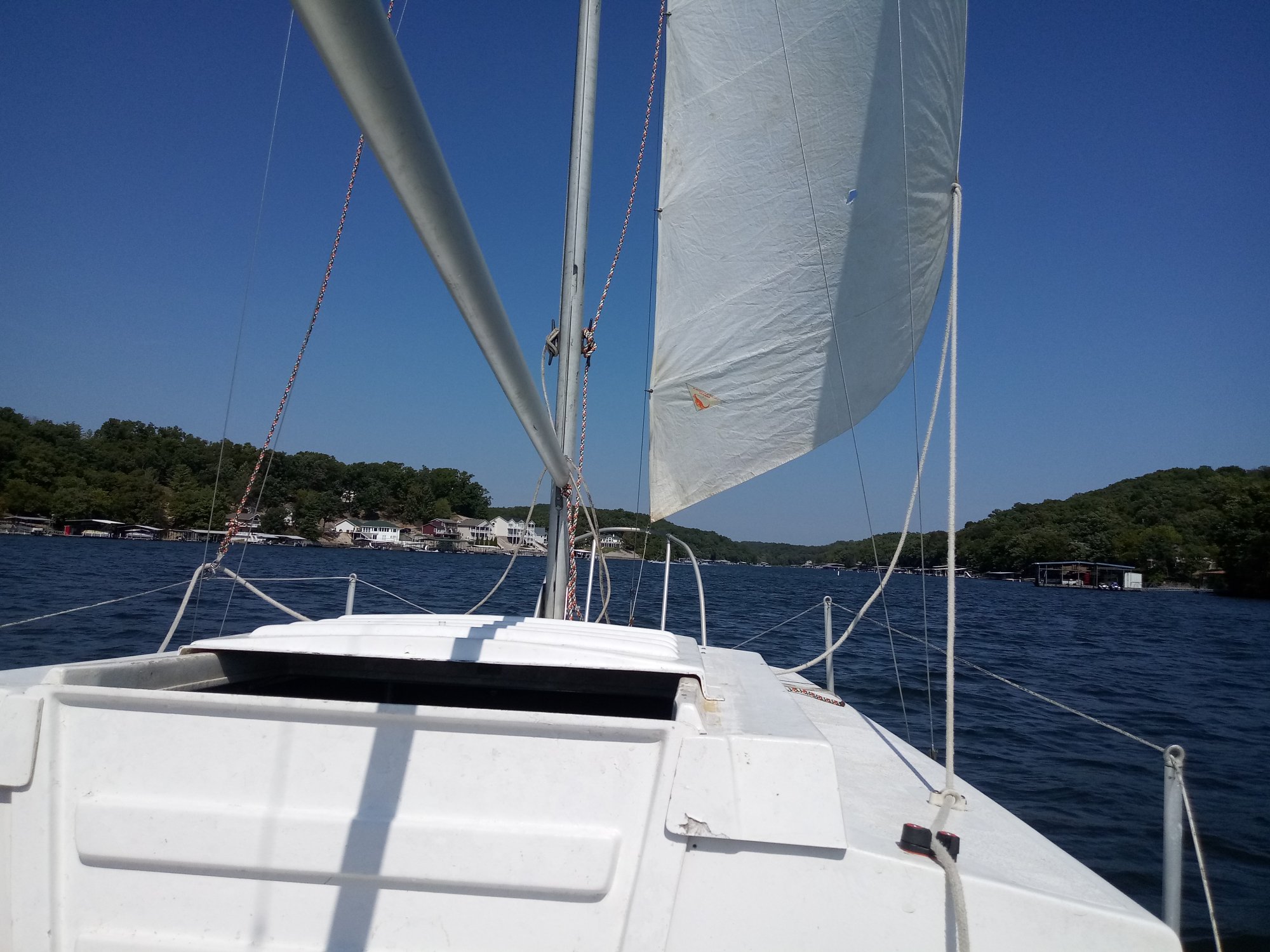

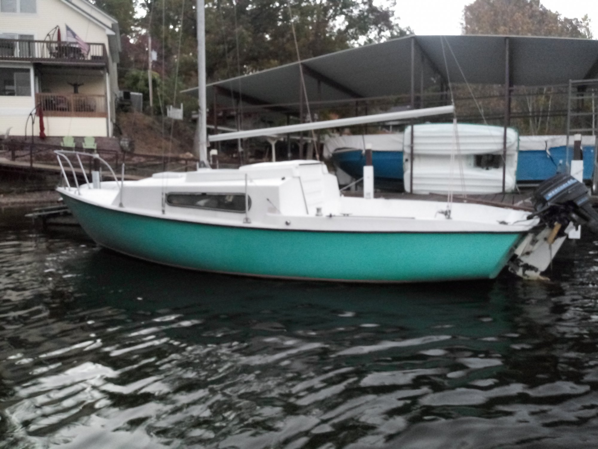

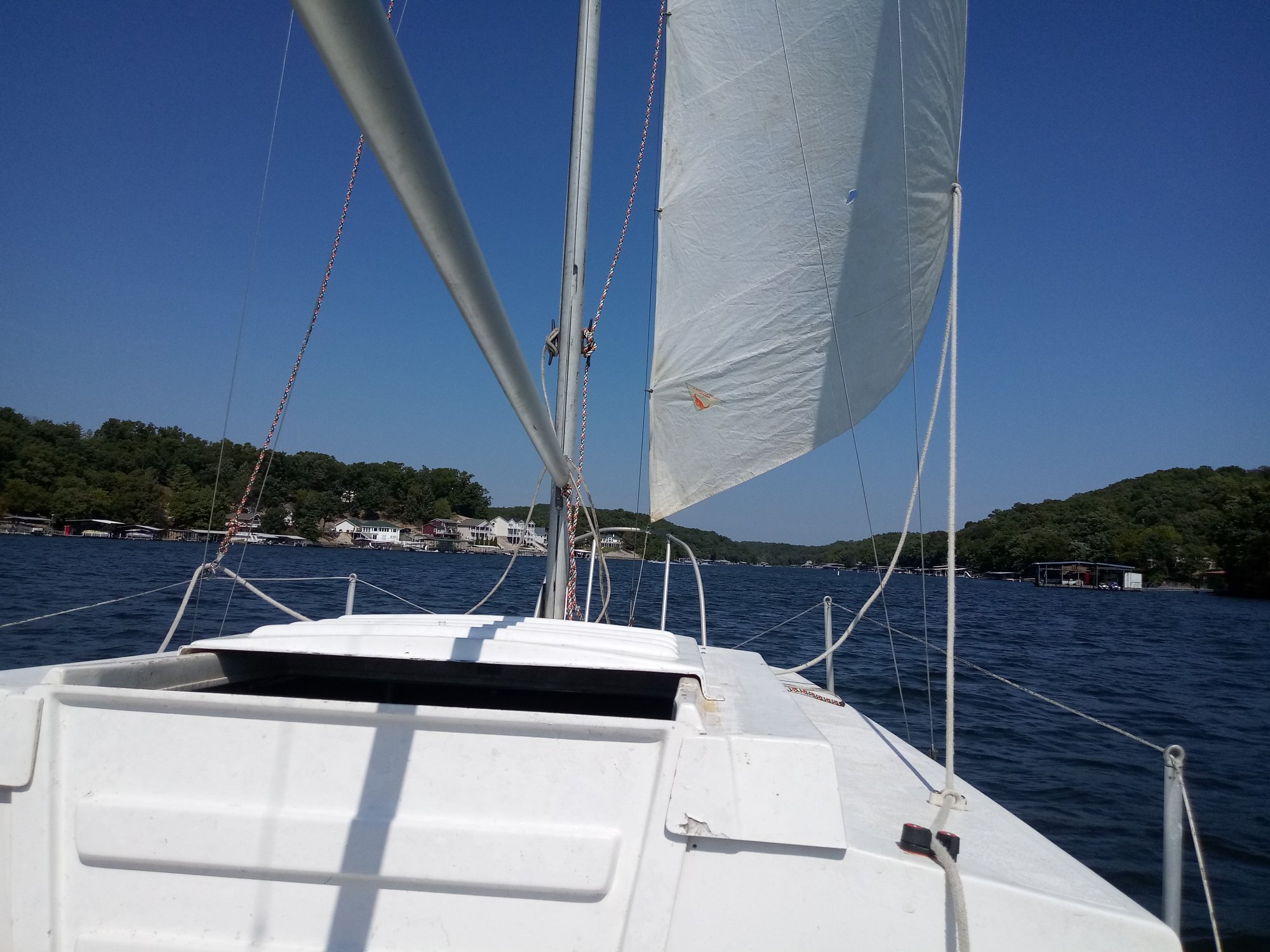

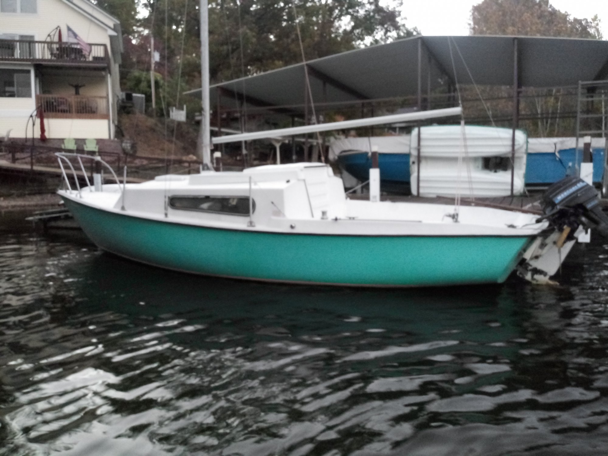

My South Coast 22 has winches on the sides and tracks with blocks for a head sail. I assume these have been added as I see very few pictures out there with the same boat with winches.
My question is why? The jib sheets run through fairleads to cam cleats on the cabin roof. I have also never found a time that the jib couldn't be trimmed by hand.
Would these be for long lost Genoa or huge jib? It seems overkill, and I've never used winches. Am I missing something?
Pics should show winches and how my sheets run.

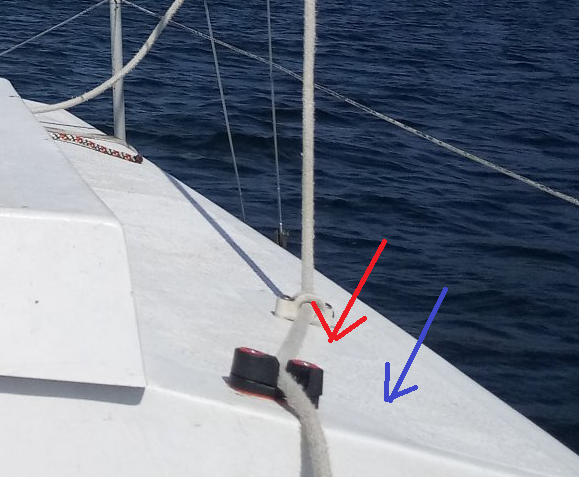

I see what you mean. It seems like the winch should be where the red arrow is and your cam should be where the blue arrow is..

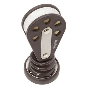

Also, your fairlead is going to take a lot of stress and IMHO is not designed for that. The fairlead should be a standing block like this

It's a tortured lead for sure, needs to be remounted as a RGRANGER pointed out it needs a proper lead block.

That would have been a very large genoa. PO probably found out it was too much.
I agree with the previous posts. That fairlead/cleat combo could be improved. Make sure it has a good backing plate or large washers.
