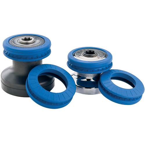

Hi there Joe,
You touched upon something that I wanted to ask you, have you by chance seen or heard of anyone using the rubber self tailing add on's? I saw these at West Marine a few days ago and apparently they turn a normal non-self tailing wench into a self tailing. They're like a big rubber grommet you place on over the top of your drum as seen here (I also attached a photo) They aren't cheap but I'm just wondering if they work or if anyone happens to know anyone who has used these.

They're called winchers and they work just fine if used correctly. The "jaws" between the top and lower rims shouldn't be used to hold line. The lien simply builds up on the bottom of the lower lip. Compared to the cost of a real self tailing winch, they're a bargain. Many people also do not like them, some because they don't get them to work, others just because.:) Do a search on "winchers" and you'll find lots of previous discussions. I used them for 12 years on my C25. Thought they were great.

I also have 4 vintage barlows on my boat. The two speeds are 25 years old the single speeds are 35 years old. I used to clean them every year until I started using synthetic waterproof grease. It last much longer. Now I leave them alone until they get noisy or start sticking. About winchers they are an old product. I dont see them around much any more,
in my area anyway. A friend of mine had a pair on his boat about 20 years ago. He didnt care for them. I didnt either. Ive never owned self tailing winchers. Im kinda used to cranking with one hand and tailing with the other.
