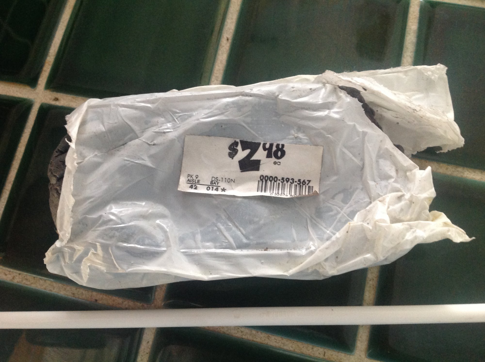

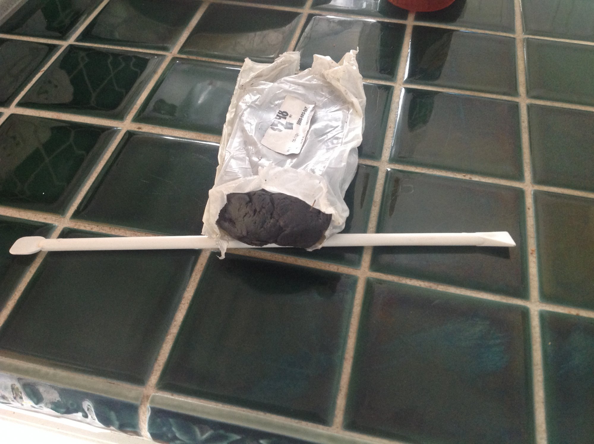

Karen,
You have a small problem but it's not insurmountable.
What you need is a couple of basic items (see photos)....1st is a product called "Duct Seal" (available at Lowes/Home Depot/Hardware Stores/Plumbing Supply Stores), now if you ask for it by Duct Seal they may not now what you mean. Most know it as "Monkey S;$t". Just a plumbers thing I guess.
It's in the "Electrical Section" of Hardware Stores not the Plummbing Section.
And a long Plastic/Metal tool to get down to the bottom of the shaft.
This stuff is form holding, never hardens or dries out and grabs things tight, but not forever. Put a ball of it on the end of the metal tool and like "capta" and "fdl" said get it to hold the pawls away from the shaft. You may need a lot of it to do the trick but it cleans easy and holds.
I have this stuff on my boat and have given some of it to others. I have a friend who looses the screws to his in mast sail car every year trying to get the screws back in a 3 inch area to hold the sail on. A small amount in the allen head hole holds the allen head tool in place and the screw backs out while holding everything together. You pay a little more for it than the picture shows, but that will give you an idea of how long this stuff will last you.
It's going to involve some time and effort on your part but it will work. If you can see the bottom and the pawls it will hold them out of the way.
Take your time and Let us know how you make out.
