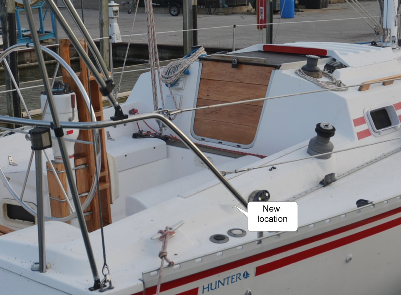

I'm posting a picture to better show where I would like to move them to. It's a bit difficult to see, but there is a molded in pad for a winch.
Up until now I've only sailed tiller boats. If this was a tiller boat - and she should be IMHO - location of the winches would not be an issue for me. As it is there is also a brand new 24" wheel to replace the 36". Should make moving around easier, I hope.

Have you considered that the winch handle is going to hit your pushpit?
How long have you had this boat?
Nov 4, 2018
155
Hunter 28.5 Catawba Island, OH
Happy that you point the handle/pushpit potential conflict. And now that you brought that up, it just occurred to me that I might also have a conflict with the bimini stay.

I am almost 99% sure that the new location for the winches is backed with an aluminum plate that is glassed into the decking.
That's the way most of the hunters were built back in that era.
My h34 has backing plates molded into the hull so like I said I'm almost positive yours will be also.
The location you are like to remount the winch I believe was to be used for a spiniker set up. Like others have commented make sure you have the clearance.

Ditto here. It appears from your photo the jib winches are in the right place. If it were my boat I would leave them as is. And as Capt. Robbie stated, the winch pads aft were designed to handle spinnaker sheets.
