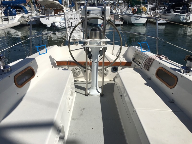

Has anyone ever placed a winch in the aft part of the cockpit. I have a Catalina 34 and its really hard to get up front past the steering so I thought I would place a winch on either side that I can operate from the stern perch.

I can always set the auto pilot and jump up front ..I was just thinking of how this could be way easier. As far as room ..winch would have to be slightly smaller or I could build a platform for a larger one..and yes there is room

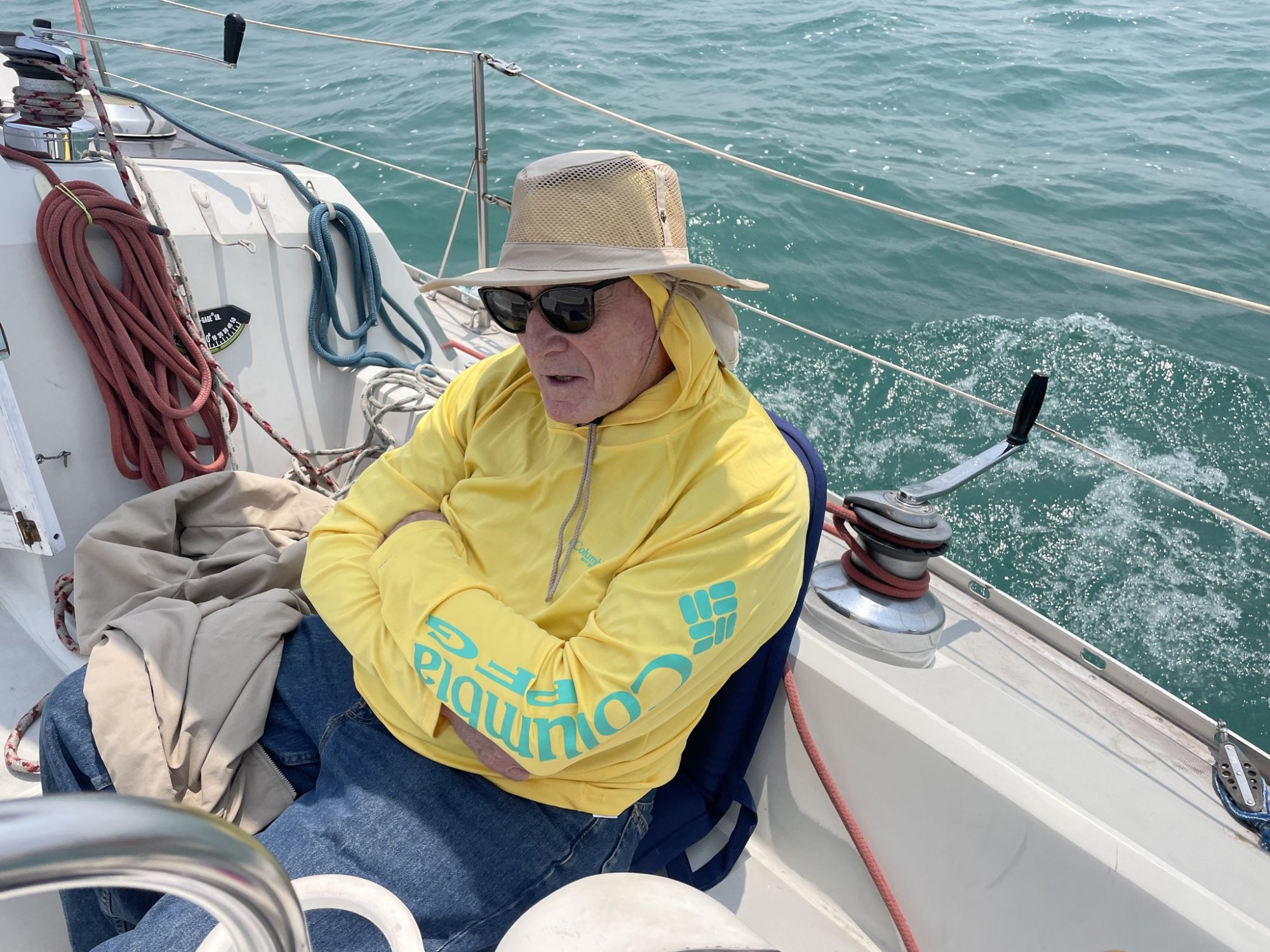

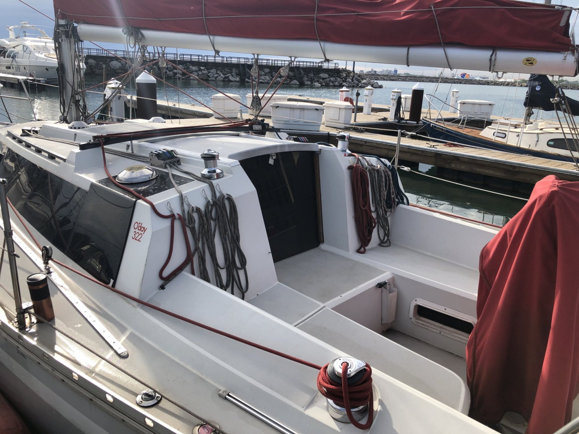

I have a different boat, so I cannot comment on mounting specifics, but on Tally Ho, my primaries are bit farther aft on my coaming, and I can reach them to crank on the winch, or let a sheet loose for a tack, without getting in front of the wheel…. And that makes single-handing easier and more enjoyable for me.
here ate a few shots that give you an idea on placement relative to my helm…
first, an overall view that shows how far back it is placed (but note, still slightly forward of my wheel.
Ignore the old guy….my FIL on a sail last year. Lent him my dry fit shirt because he is worried about cancer and was wearing his jacket on a90 F day)… but notice where the winch is,aced, and I am shooting this picture standing behind the wheel. I can lean over and crank the winch or let the sheet go for a tack.
This last one again shows proximity to the helm…just slightly forward of the wheel.
i have upgraded winches since this last shot was taken….notice the larger winch in the middle picture.

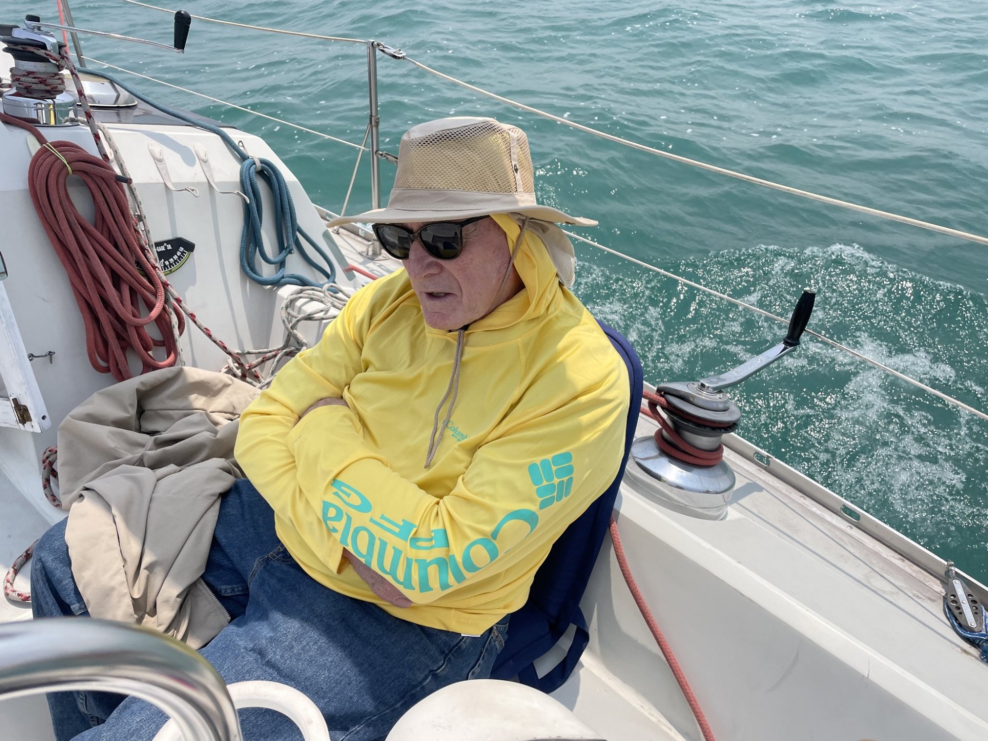

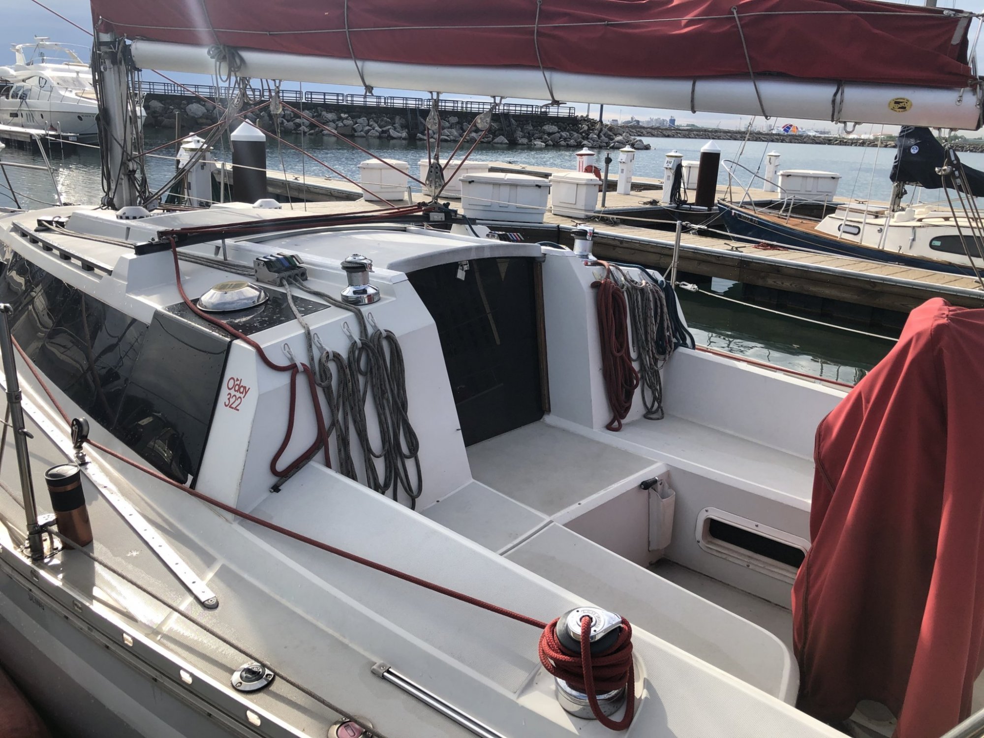

Thanks for the input ..my goal was top leave the forward winches for when crew was available but also have further back for me which is 90% of the time.
