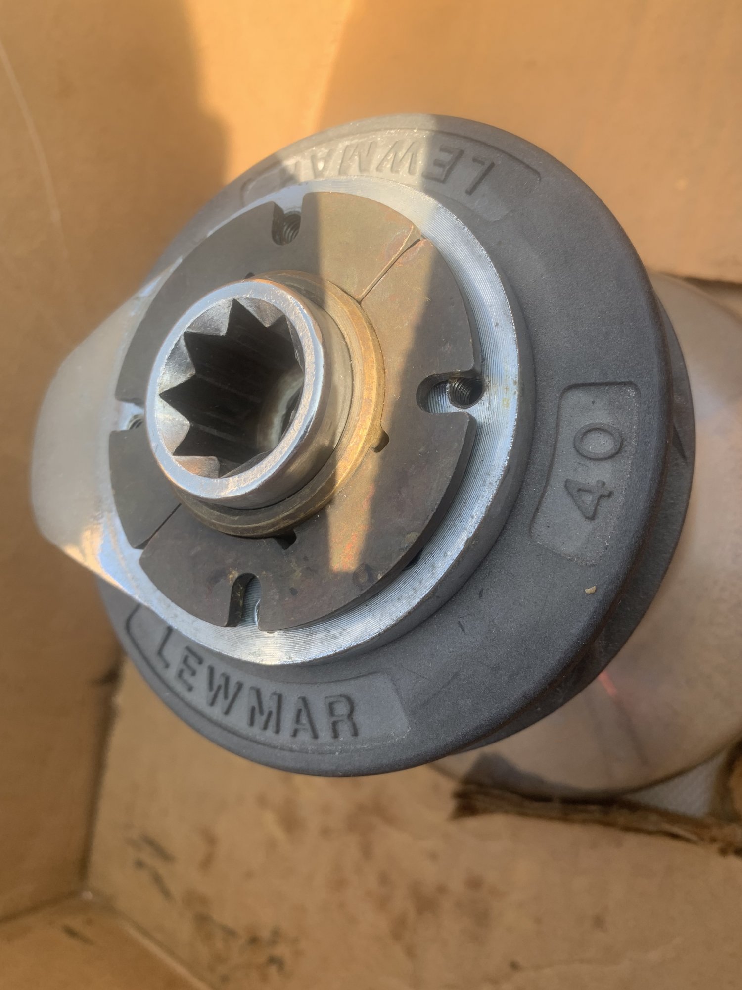

Greetings,
I am repacking and regreasing my Lewmar 40 winch. All done, expect I can never get these pins back in place. Not enough room. Any suggestions.
Thank you
Trixster
Glen Cove NY
23,950
You may need to rotate the stripper until the pin slots line up.
13,611
IIRC, the collets have an up and down. Try turning one over at a time. The collets aren't marked.
