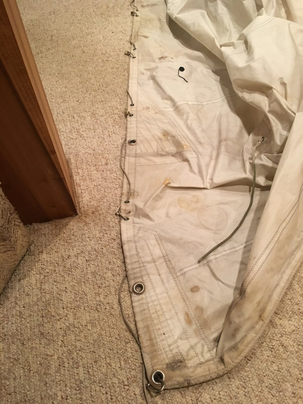

Not sure if you have a set up on your sail like mine: see picture. If so, you might have made the mistake of tying it to the cleat on the mast before raising the sail all the way up and then hauling the line down and cleating in place. Don't know, just thinking out loud. I think its called a cunningham.
Do you mean the line that the sail slides are attached to? That’s not really a Cunningham, it’s a jackline for the slides. It lets the slides sit against each other on the mast when the sail is down, so it takes less space to flake. You could probably tie the jackline through the tack of the sail and leave it there. A Cunningham would be a separate control line from the mast or boom to a ring a few inches above the tack.
