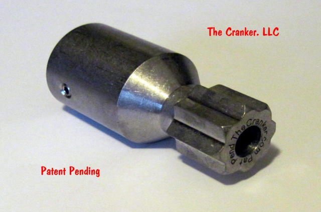

I use the Ultimate Cranker bit on a Milwaukee 1/2 inch right-angle battery operated drill. Raises my full-Batten main very quickly.
I wanted to use it to crank me up the mast, but not enough power to do that using my small cabin top winch. Plan to try to reroute the halyard to a primary winch at the end of the season...
I had issues with my chuck “unscrewing” on my drill, so I went with the Ultimate Cranker which replaces the chuck Completely.

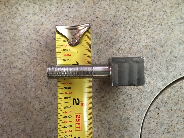

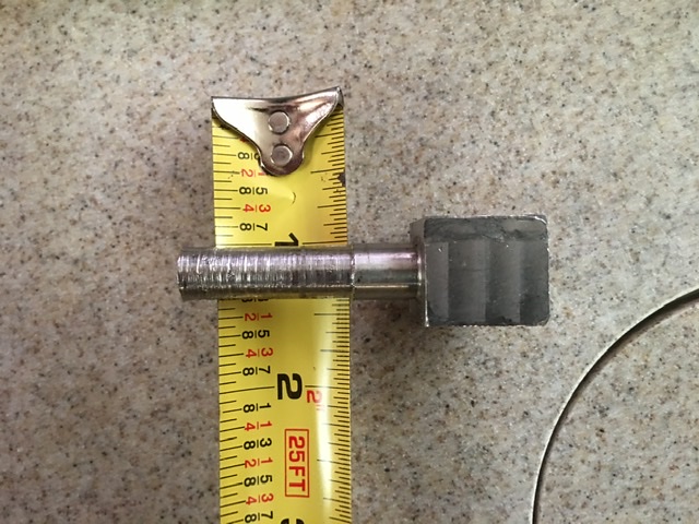

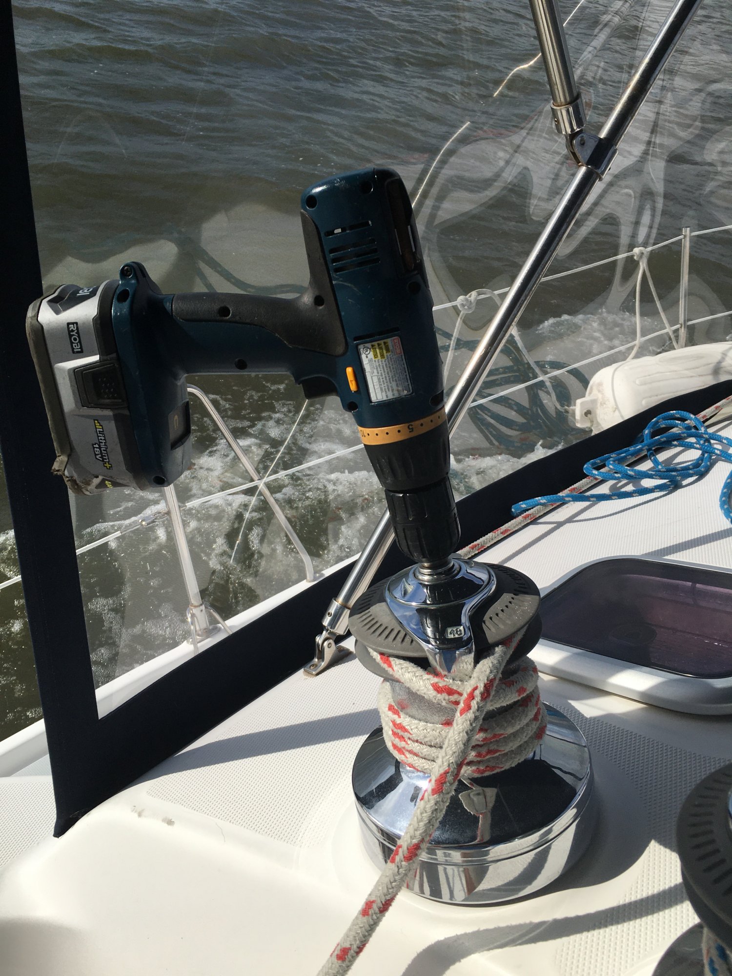

I know that there are many Sailor’s that are getting a little help raising their main sail or themselves up a mast from cordless drills being used on their winches. Looking for recommendations for a winch bit for a 3/8 inch right angle drill. What are you using?
Wish I could remember where I got this thing, Danny, but it’s probably been 10 years (I don’t know how I haven’t lost it). If it was still available, the Google searches I just did and I’m sure you’ve done would have found it. And the drill has enough power and leverage to handle almost everything that goes up on my 34’ boat.
8,050
Beneteau 323 Annapolis MD
View attachment 184556View attachment 184557
Now THAT's what I'm talking about in my post #2. Though the above needs flats to go in the drill chuck. Alot easier to start with a 3/8 drive shaft with flats to prevent slippage/spinning , and a 3/4 inch square drive ground down.
Greg
I have the 28 volt Milwaukee RA and have the same problem with the chuck lossening. Do you have details on the Ultimate Cranker?
Greg
I have the same set-up. My original Cranker fell out of the chuck, and now lies at the bottom of Lake Michigan.
I replaced it with the Ultimate.
