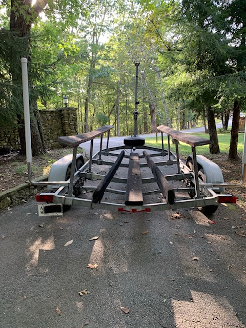

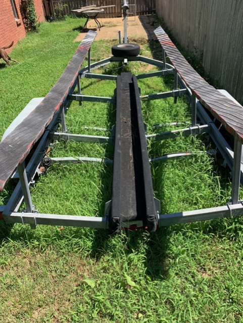

I'm getting ready to purchase a used trailer for my 2001 Catalina 250 Wing Keel. The trailer I'm looking at was used for a Catalina 25 swing keel. The trailer has bunks vs. individual supports with pads. I think my draft is a little taller than what this one had. Maybe 12 inches or so taller on each riser. I'm buying this one because the price is right and I think I can get it to work with some simple modifications. I would like to remove the bunk and use the screw jack pads. Any thoughts on whether this will work or not? Any experts? I have a welder friend that will help me modify if needed. Thanks. See pictures attached.

I’m definitely no expert so... unless you can buy a trailer made for your boat your stuck with making something work which is probably doable in this case with what you have. I’m sure there’s going to be some costs but probably less expensive than sourcing a trailer ready made for your boat, especially if your handy with metal cutting and welding.

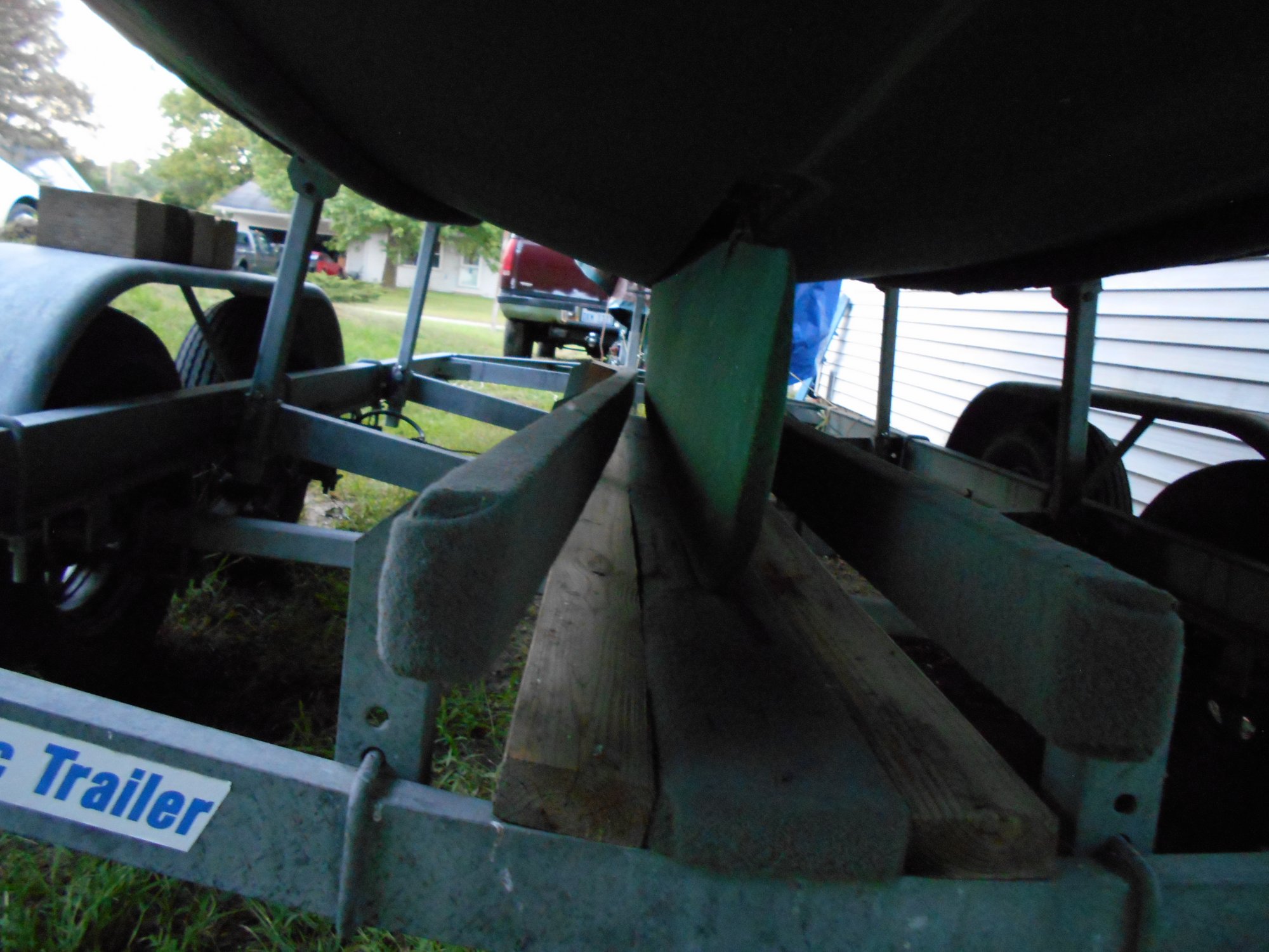

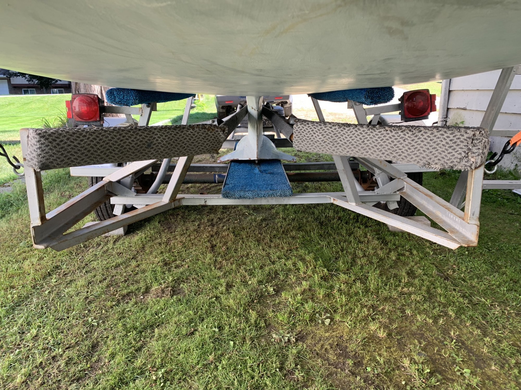

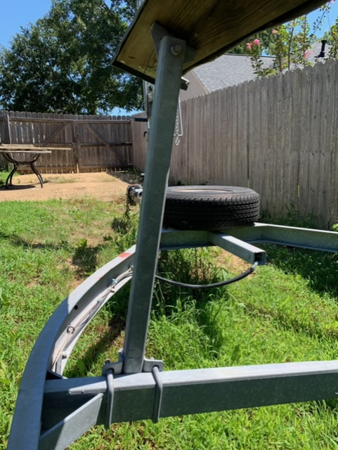

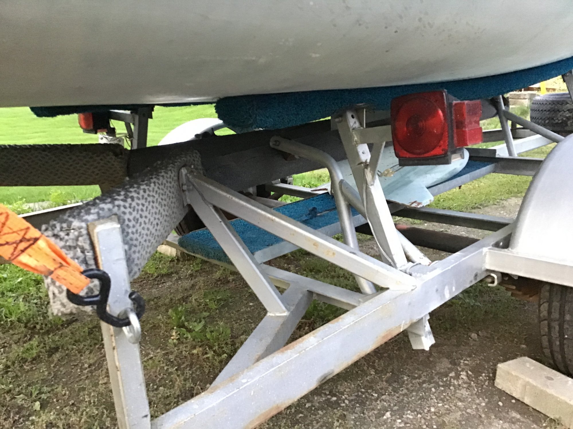

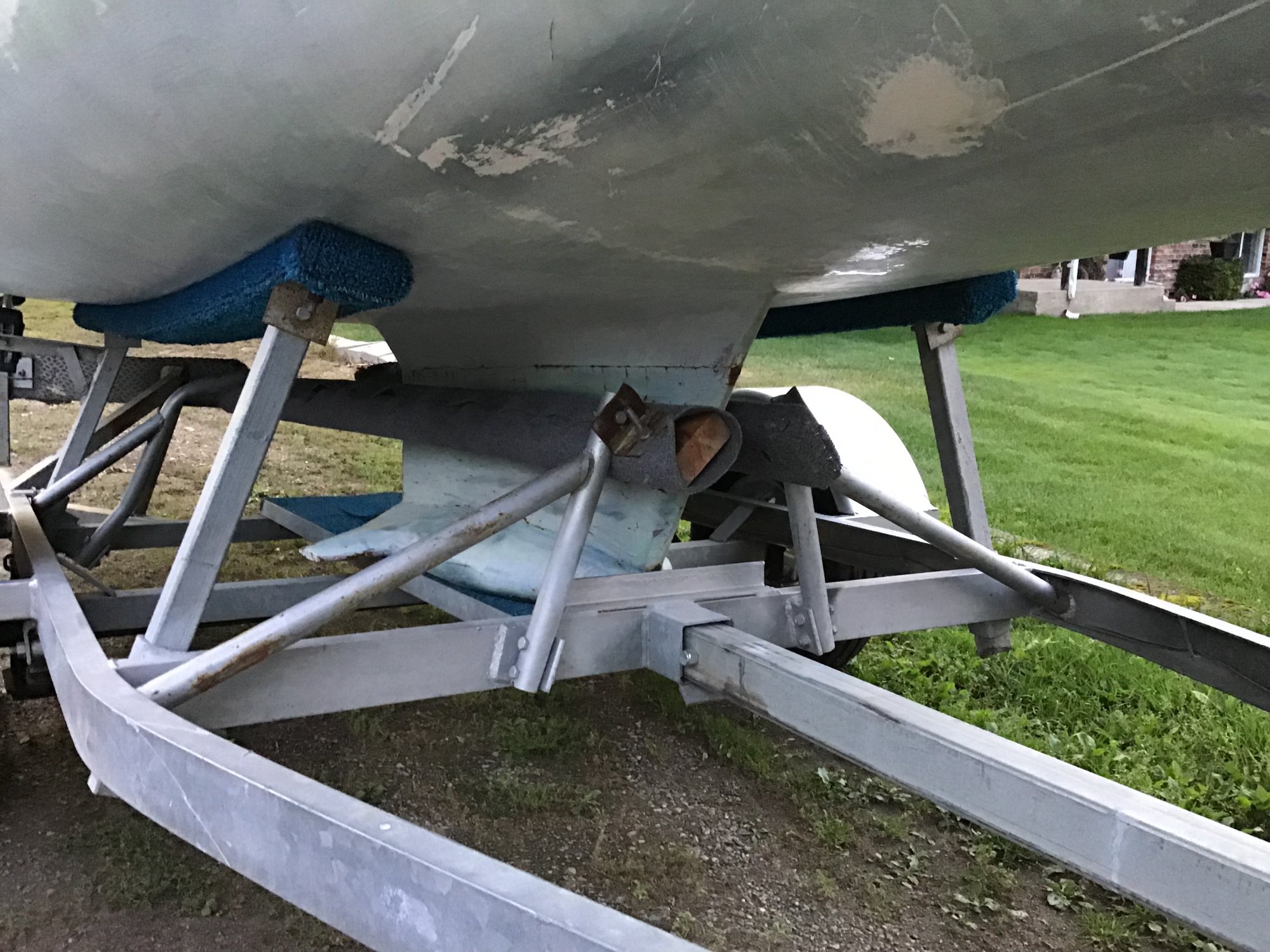

My trailer looks like it started out like yours and was modified and it seems to work fine. I don’t know the history of it. Here’s some photos of what they made work, let me know if you need more detailed pics and I can do that next time I put it in the water.

This definately helps. Thank you. I like the keel guide.

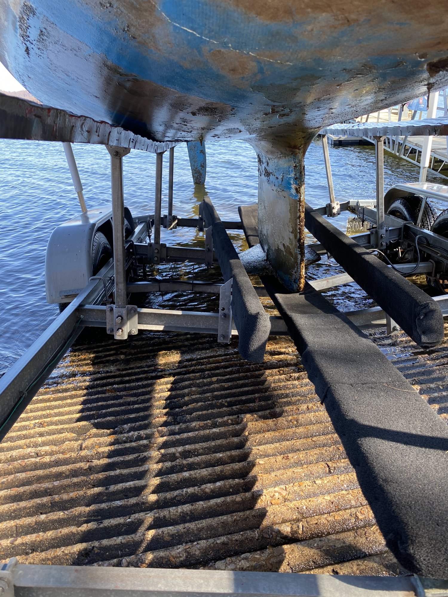

Just one thing to point out. My previous boat had a lead in and centering guides for the keel. The problem I had was with the angle of the trailer, and the water being level, my keel was always well above the guides. I always had to recenter the boat as I pulled it out of the water. Otherwise the keel was sitting on the guides, rather than in between.

Makes sense. Something to think about. Maybe it needs more of a trough that connects to the base and is a little wider than the wing. I don’t know.

I would keep the bunks as opposed to the adjustable pads . The bunks support the hull over a larger area. The pads need very careful alignment to the inner bulkheads .It can be done ,just need to be much more diligent.
I also added goal post and keel guides to help align . huge difference ,especially in a cross wind

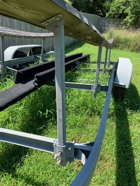

This is what I think is also important, notice the big V for the keel and how they taper it all the way to the front of the keel..... really helps it glide into position. I’m with Tim R in having bunks that support a larger area of the hull.

My thought on the pads was that if I need to paint the bottom, it would be easier with pads. Any thoughts on that?

Id rather have the hull support and jack it up for the occasional paint. When you look at trailers built for your boat do they have bunks or pads?
The bunks or pads neither one should support the boat. The weight of the boat should primarily rest on the keel. The bunks are there to keep the boat from rocking side to side. Otherwise you can warp the hull. Even bunks sag under the weight of the boat, such that the high point is under the bracing. Even standing on a bunk, you will see it sag quite a bit.
Yes goal posts help a lot, especially on a windy day.

All good points. I can purchase a couple jacks to lower one bunk at a time when painting I guess. The pictures I've seen for the Catalina 250s on a trailer seem to be pads.

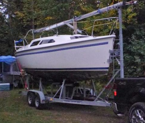

I'm currently in the market for a trailer to fit my H26.5. If that trailer came up at the right price in my area, I would happily buy it, adjust the bunks & fabricate a keel guide/support to fit my wing.

Thanks Jim and Lloyd, I've raised the bunks as high as possible. Not sure if it's enough yet, might have to get longer posts. I've replaced the lights and wiring and added goal posts to each side. I've also separated the keel guides to work better for the wing keel. I've added a picture to this post.
I'm trying to figure out what you mean by using the tongue jack to raise the boat off the trailer. Not making sense to me. I need to make a trial run to see if the boat will fit the trailer. I'm not sure on the width of the wing keel or the height the bunks need to be.
