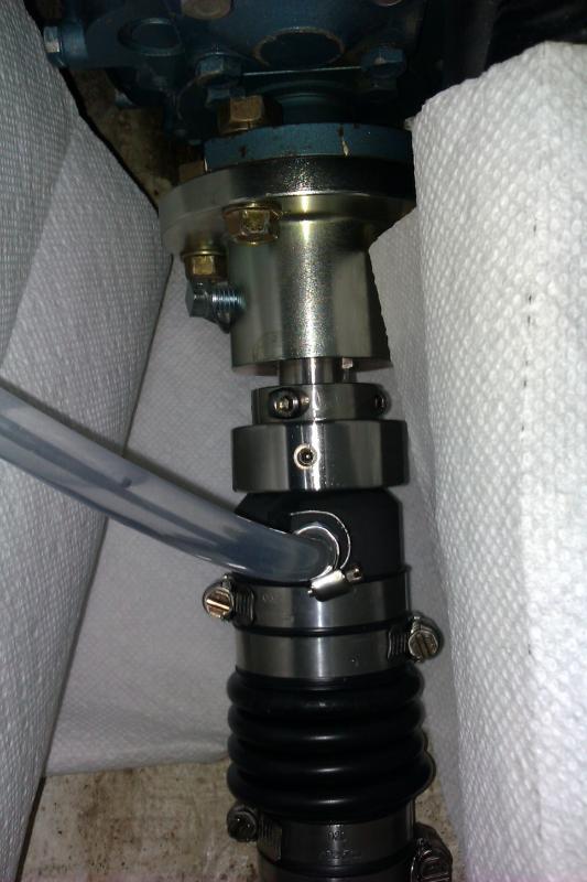

Ordered shaft and coupling, "faced" from CD last year. Fit like a dream.
I'm 800 miles from any kind of boat yard (besides my garage) and parts really need to go together the first time.

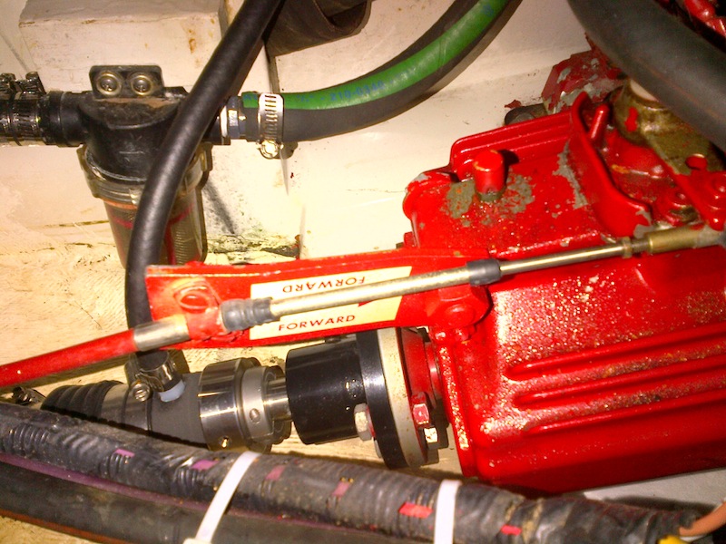

Thanks for the encouragement Gary & TLW. I wish my transmission/coupling/etc looked as clean as yours, Gary. It doesn't. This is how it looked to me when I first checked on disconnecting the coupling:

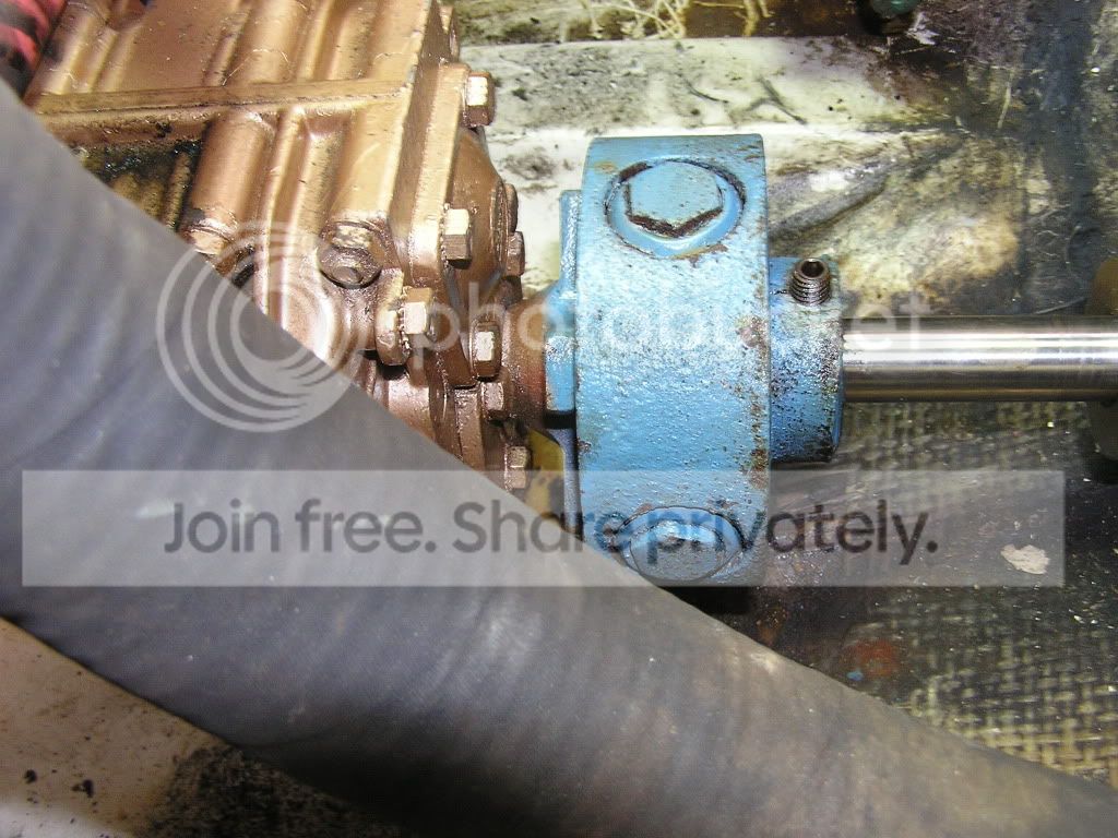

The mechanic I am working with looked at it and said it was about the worst he had seen in 20 years, although he allowed as he had worked mostly on new, or at least newer, boats. In Gary's photo, the coupling parts look just like the pictures on CatalinaDirect.com and like the diagram in my handbook for the boat. The mechanic cleaned a lot of the rust off after this picture, and the parts are more distinct. But it does not look like the coupling shown in the manual, or in the CD photos. It looks like this:
...but it is very rusty. Does anyone recognize this coupling? I probably need to find something different to connect to this transmission if all can be cleaned up enough to use.

Thanks again for thoughts & advice. The coupling on my shaft looks like a flexible coupling, and looks a lot like a federal coupling. I'm guessing that sometime in the last 33 years, this was a replacement for the original equipment. Otherwise, the transmission side looks like dziedzicmj's lovely, clean coupling. I'll be discussing this with CD and ordering once I have the shaft length. Once the parts are in, everything will be new, including the stuffing box.
