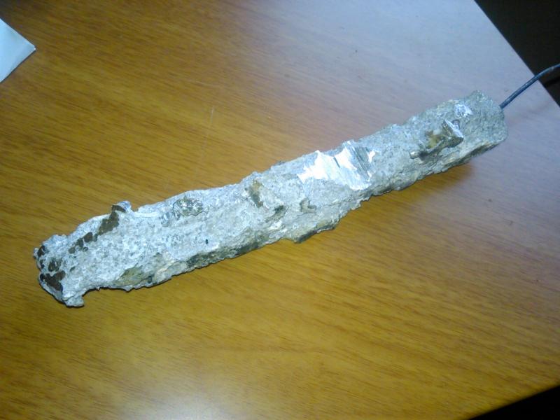

Picture of the removed anode attached. (I did replace with a new one.) The small shiny section in the anode is from a hack-saw cut I made after it's retrieval from the water to see how much good metal might still remain below the surface pitting. Looks the same to me as the surface of new anode I hung in its place. The anode is a military spec Al alloy type. I put the anode pictured in my bench vice and bent it almost 90 degrees. Then straightened it out again. The Al alloy remained pliable. To me an indication that inside, the anode still hadn't sacrificed all its electrons.

I am always surprised to look at aluminum alloy anodes after they have been in service
awhile because they do not look at all like worn zinc. You would swear by the the appearance of aluminum that there something is big time wrong.
Then you measure the hull potential and you find out that that weird looking aluminum anode is in fact still quite active and things are actually just fine.
An actual hull potential measurement is probably better than guessing by anode appearance - at least it is in my shop. And - doing so is both cheap and simple.

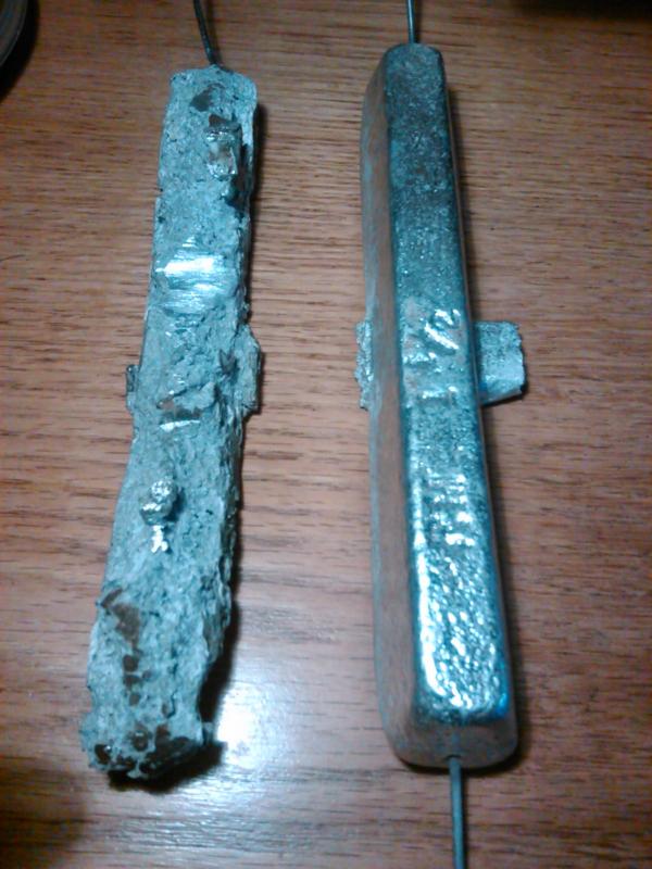

Not that it really adds anything to the discussion, but attached is another picture of the 8-month anode and a brand-new one. Weight of the new is 9.5 oz. Weight of the eight month is 5.5 oz.

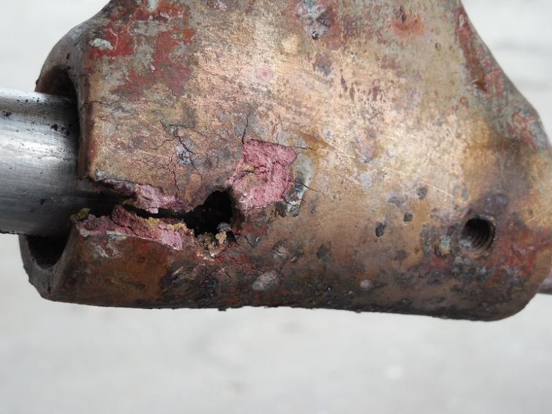

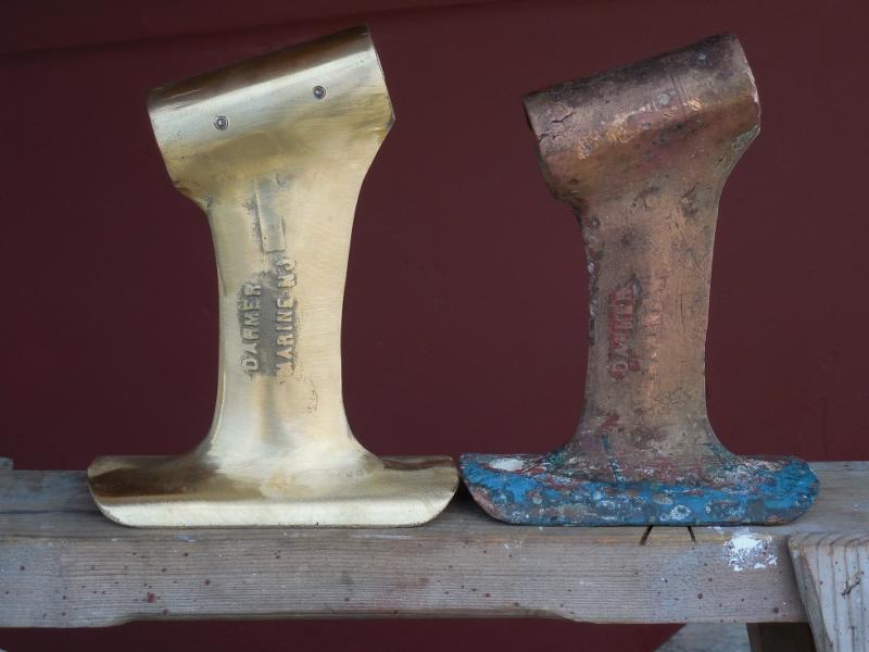

Inboard Yanmar I have. So yes a strut. The 34 year old 1980 OEM strut was an issue at the last haul-out when I and the yard attempted to press out the in-need-of-replacement cutlass bearing. (pics attached of what is looked like after the attempt.) Hunter originally bonded the strut with a wire to the engine block. Many years before I bought the boat the wire had galvanically corroded away from the strut mounting bolt. I didn't reattach because 1) the bolt was unreachable and 2) I figured that since the strut was electrically isolated by the rubber bearing it was probably best to leave as is. Anyway, the the replacement strut now is wire bonded to the engine block as per the original OEM configuration. It was painted with several coats of non-conductive underwater primer. Then painted with copper-based hard anti-fouling paint.
