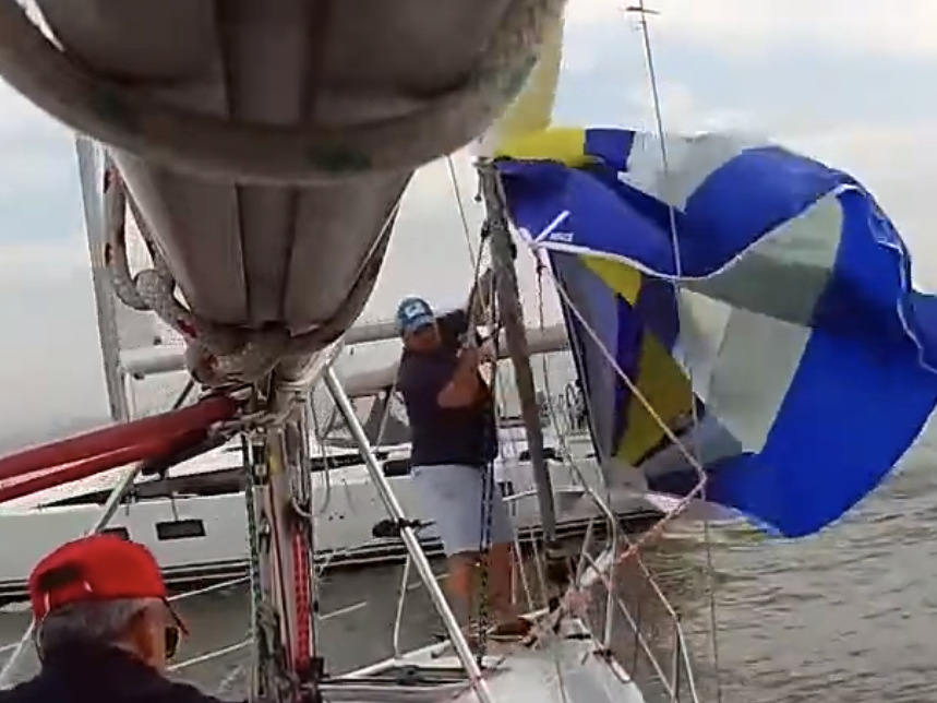

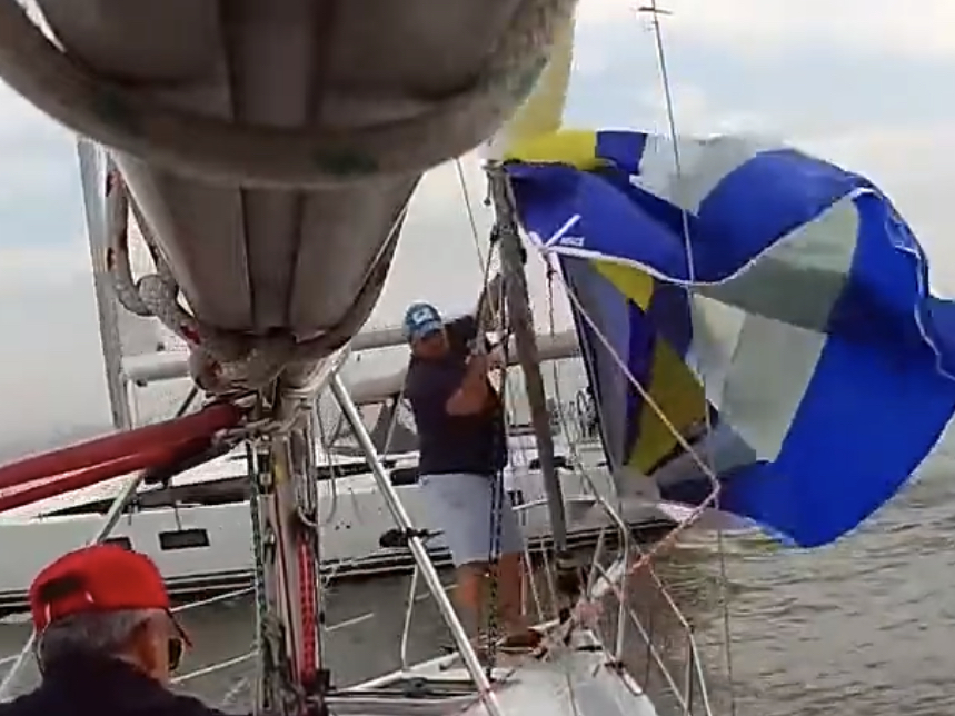

And a sock jibe is real easy for two people
Well it is when one of the two is built like your buddy ;)
I would point out that even he was exerting himself when the chute was partially deployed. If you compare that effort with the guys in the video Meriachee posted, that’s one of the benefits of the top down furler.
766
Hunter 340 Baytown TX
We were socking and dousing in a hurry, had to get back to the finish line. In this race, winner had to record next four finishers and they were about a minute behind. So, we were rushing everything trying to get around the big Jeanneau and get back to the line.
I have never used a top down furler myself though.
Yes it looked like he was getting hollered at by the captain to hurry up ! ;) Great video BTW!
I guess my point is when you look at the two videos it really highlights the different techniques required for douse and deploy.
Sock is crew on foredeck manhandling the sail, furler is crew in cockpit managing lines.
I assume by the posting on this forum that most cruising is done by a retired couple and racing is done by a crew greater than 2 who are really invested in making the boat go as fast as they can. IMHO a top down furler is a good option for either environment - totally ignoring the cost differential between a sock and furler however ;)
