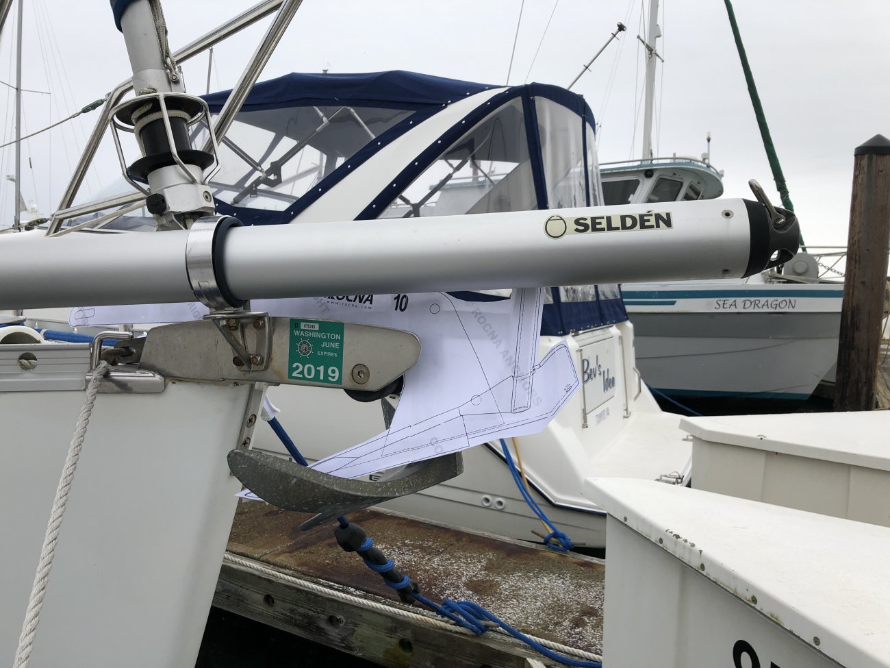

Will a rocna 10 kg fit on a beneteau 323 bow roller?

Make sure your re-tractable sprit works with the anchor.
I just checked that and it won’t work. So I made a cutout of the rocna Vulcan 12 and I’ll see if that works with the bowsprit.

@Paul8 I have been under the impression that you can slide the selden sprit all the way back to the collar. It releases from the secure point on the foredeck and retracts to a stored position when not in use. Granted it could be a hassle but it would get the sprit out of the way. No conflict with the anchor during deployment or retrieval.

The sprit would not interfere with the anchor but the anchor would make it impossible to extend and use the sprit due to contact with the roll-bar. I guess that if you have the sprit for a fashion statement that wouldn't be a problem but if I had such a wonderful tool I would want to use it every chance possible. :)

The problem is I would need to remove the anchor to deploy the sprit and spinnaker.
