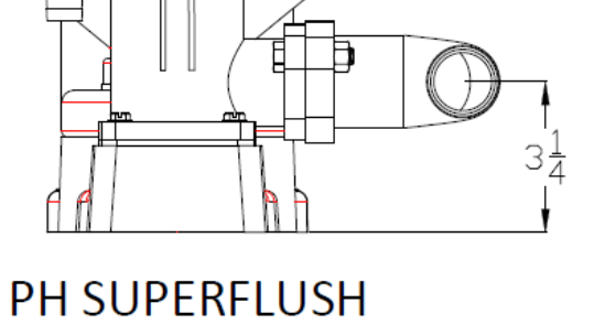

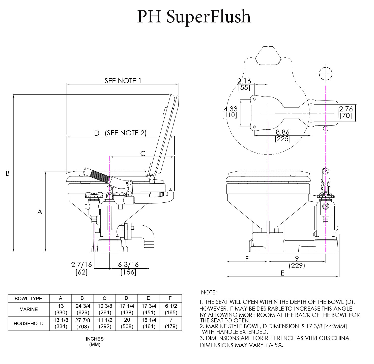

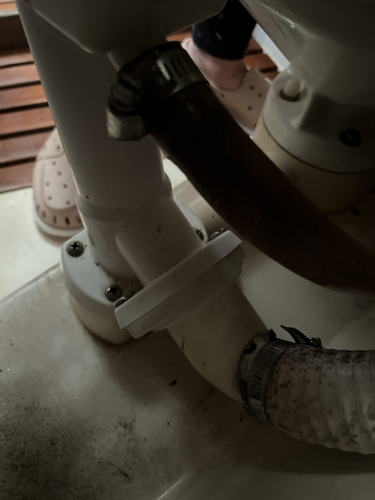

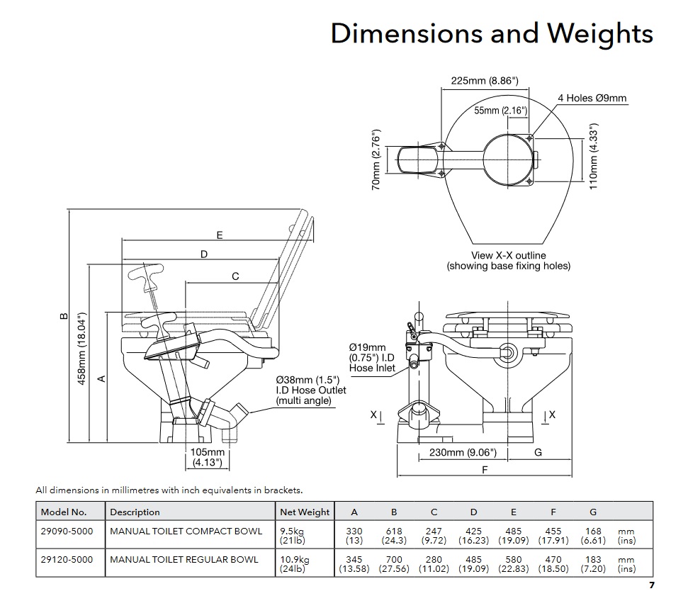

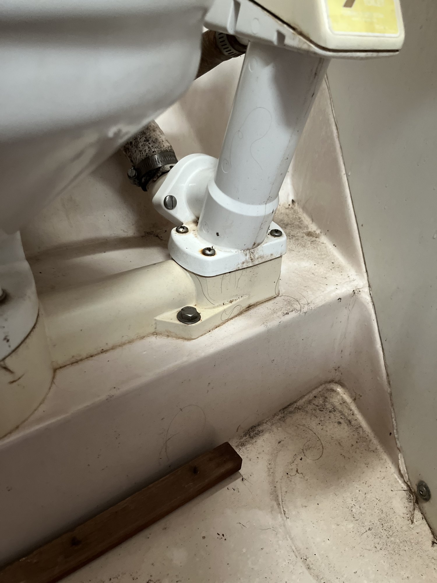

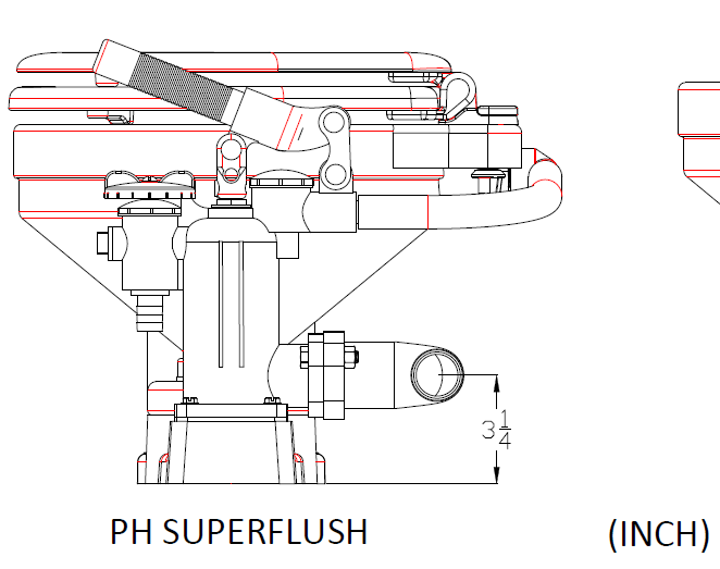

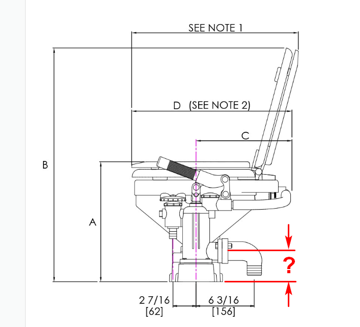

I'm getting around to fixing the head. I figure all the seals are shot and am not going to bother with trying to figure out what's wrong with the current head. I'd like to put a Raritan SuperFlush in, but don't know if the discharge will physically fit. The Jabsco is nestled quite nicely as it is. First off, if the 90 deg elbow on the Raritan discharge can't be flipped and pointed up, it's a no go. The discharge protrudes 2" further back, but is higher so I think would work. All other dimensions I believe would work, even with the large version. What do yall think?

Perhaps if someone could provide this dimension, you'd have your answer.
If memory serves me correctly (and Peggie will definitely correct me if I'm not) the discharge will rotate continuously through 360. degrees. Long time ago that I replaced my Jabsco with a Raritan.

After extensive research (scrolling past the page showing dimensions), I found a schematic which suggests that you are correct . There's also a straight outlet that can be installed. I'm betting that this will fit. When the Jabsco discharge is positioned up, it is a good deal longer than down. On top of that, it appears that the Raritan discharge is higher. I'm going to ask the local shop if they'll accept a return if my fit-up doesn't pan out.

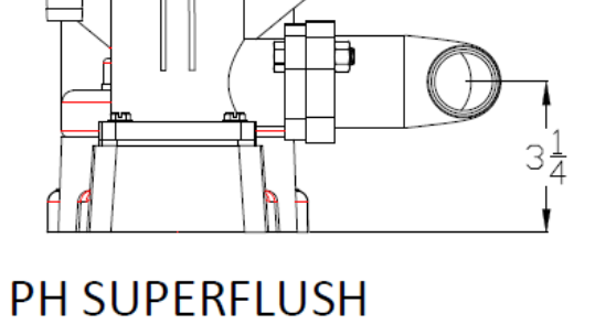

I emailed Raritan about it and got a reply in 46 minutes. That’s an exceptional turnaround time! Answer is 3.25”

What's the height on your PAR.
At 3.25” from the floor, I have a tad over 7” to the back. I’m going to go for it. The household size’s inlet to the bowl protrudes too far back, but the marine size will fit.

Are you saying your PAR is the same height as the PH Superflush at 3.25" ?
I notice the PAR slopes down at the pump exit. With the Superflush having a horizontal discharge from the pump, looks like you're safe.
The par is about 3,1/8” to the bolts on the flange. I’m trying to track down a marine size though. I’ve forum a couple for 300-320, but one is a household and the other doesn’t say. Waiting for a reply from the site.
