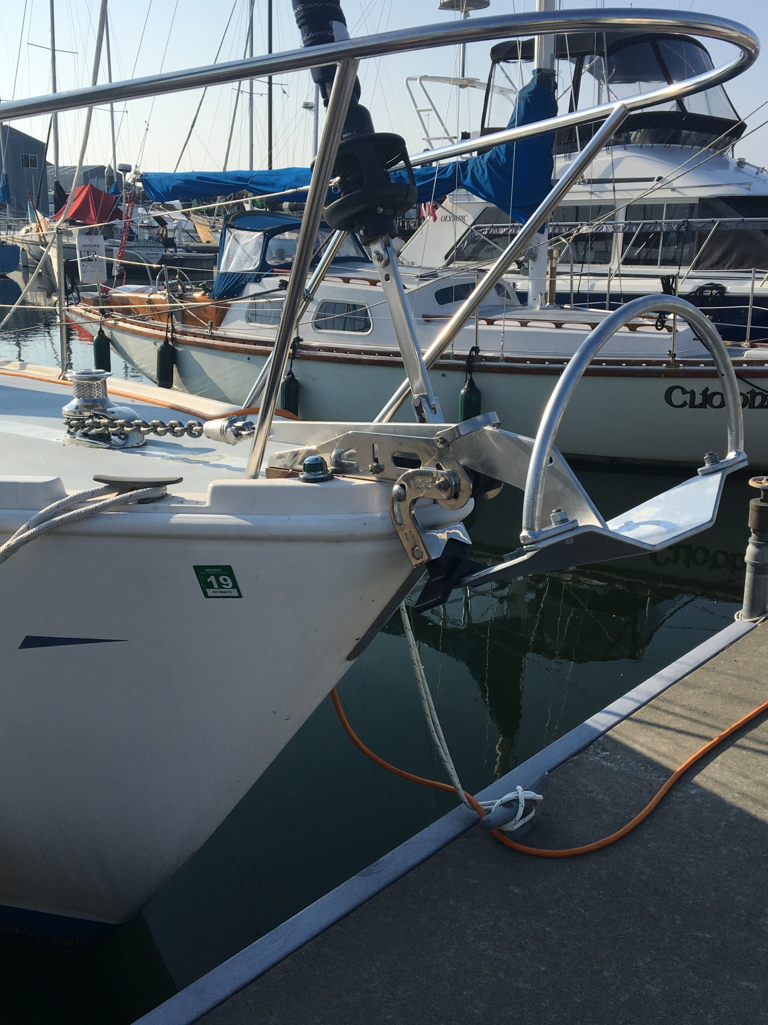

Will 35lb Mantus anchor fit 1999 Beneteau Oceanis 381 bow roller
24,503
Possibly? What does your bow roller look like?
Here is what my Mantus 35 looks like on the Mantus bow roller I installed on my 1974 CAL.
If you have a Plumb Bow then your will want the roller to extend far enough out to get the anchor tip away from the bow. Mantus makes a good anchor attachment to help stop the anchor tip from swinging about. (I installed it on my bow roller).
