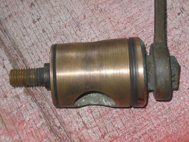

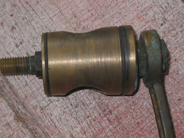

I have 2 Wilcox Crittenden 1-1/2" seacocks that I would like to rebuild. These seacocks are 1995 vintage and have rubber 'O' rings at either end of the tapered plug. I can't find replacemets for the 'o' rings and I wonder if they are even necessary? Ideas/suggestions?
See attached photos

go to the auto parts store like a NAPA they have o ring assortments you can go through...if no luck there try a bearing industral supply house like Motion Industries or a plumbing supply house or HVAC supply house....hope this helps...

A good hardware store will have O Ring's and pretty sure you need the O rings from leaking into the boat,I think it took 3 o 4 hardware stores before finding the size for my sea strainers and had a great assortment of sizes.

Lowes had the oring for my groco 750 strainer. It was in the plumbing department in an assortment package.
You can probably measure those orings and order them online for nothing if you can't find a match where the other guys here suggest.
Other than that, Wilcox probably has them for $17.50 each plus $18 shipping and handling.
