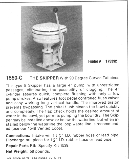

10-12 years would have been a good run for a Groco compact (HC, HE or HF depending on when it was made), which is what your first toilet had to have been. As for your W-C, it couldn't have been anything but their compact Headmate, which was discontinued at the same time the W-C Skipper was. Your Raritan PHII is far superior to both those toilets. It should give you 20+ years of reliable trouble-free service if you keep it well lubricated, replace the joker valve at least annually and put a rebuild kit in it every 5-6 years
However none of them have anything in common with the W-C Skipper, which is an all-bronze "throne" made to last upwards of 50 years that had $1000 + price tags 25 years ago. The Groco Model K is only toilet like it that's still made in the US...it currently has a price tag of about $1700. See the attached photo of a W-C Skipper catalog page
