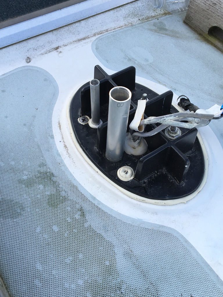

Danny. Take a picture of your mast at the deck. Include any wires that come out of the mast and plug or disappear into the deck.
If there are no wires on the outside of the mast, then they are located inside the mast and go straight through the deck.
CAL built mine like this. We used the pipes to pass the wires through the deck into the cabin.
Likes: DannyS

I'm just not sure how the connection at the deck level works; our mast is deck stepped. I haven't found any information on that connection.
That would just be a normal deck step thing. Ours has a swan neck that leads the wires inside. Our previous boat was like the pic above with the wires leading through inside the mast step. Others use glands. I would not use an external electrical bulkhead connector for this though.
Mark
Likes: DannyS

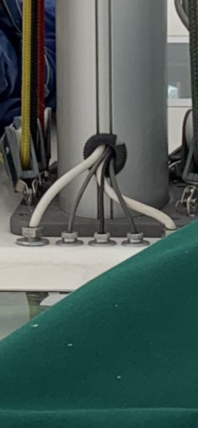

DannyS
May 27, 2004
933
Beneteau 393 Bayfield, Wi
I think I'm overthinking this, I've never had a deck stepped mast before so making the connections was always done down below. This is the first time our mast has been dropped and I wasn't there for that so I didn't see the process. I was thinking that the connections were made on deck but after looking at this photo, I'm realizing that they're just deck penetrations and in fact, the connections are still made below. I should be able to use the existing cables to pull the new ones and hopefully use the same deck penetrations. Thanks all!
