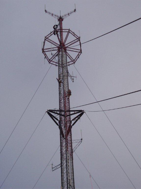

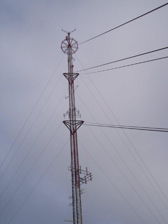

The attached pictures show me on 1/9/2006 @ 350 ft up on a 410 ft tall communications tower installing the equipment shown in the last picture. Most of the equipment installed that day is still on that tower and in use to this day, and was purchased from Streakwave.
