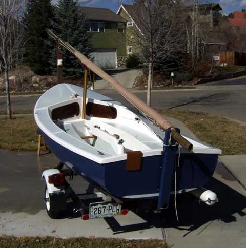

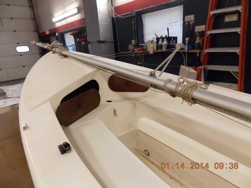

Basically, the whole volume under the forward deck is open, so if you added access hatches like the O'DAY optional ones, you would have pretty good stowage! I would suggest adding a tray or floorboard in there (I guess it would need to be i npieces to get through the hatches?) but anything that goes into that compartment will be sitting in an area open to any bilge water...so might not stay dry without some kind of tray/floorboard to keep gear above any bilge water. I have the dimensions and locations of those optional hatches, as soon as I can scan them I'll post them.
I assumed that your boat was an early (1963-70) model when you mentioned no stowage space, just assumed that if you had a 1971-83 model with the forward deck that you could use that. Oh Well!!
As I say, other than some foam that should be glued to the underside of the foredeck, the entire volume under there is wide open space.
I'll scan that drawing as soon as I have a chance! In the mean time, I have included a few pics of Widgeons with those hatches and even found one showing the space under the foredeck! Not sure how helpful that one pic if, but....... at least it is a clue!
