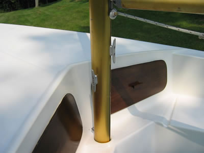

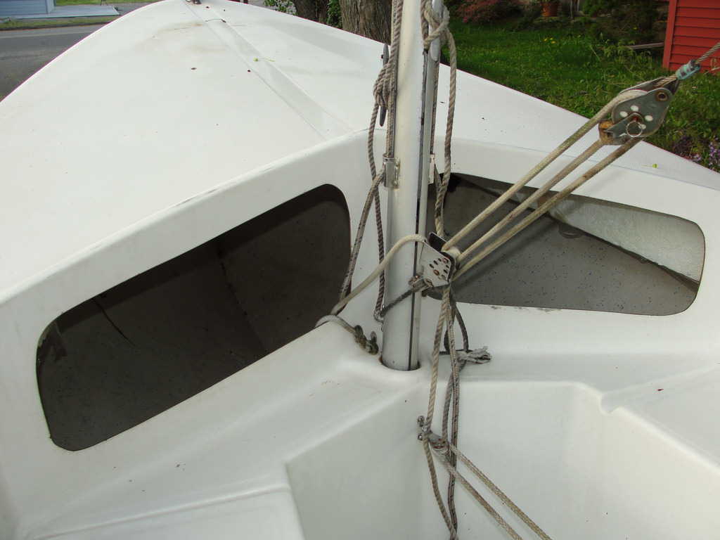

I'm wondering if anyone has any clever ideas for replacing the 'hatch covers' that cover the access holes in an enclosed 'cabin'? In the later year boats, there was a foredeck storage area and there were optional teak covers to cover the holes. I don't know if my boat ever had the teak covers, but someone made plywood variants before I bought the boat and they're not in great shape anymore. Just wondering if anyone had any luck with a composite material, ready made replacements, or a sealed hatch that might work. Thanks!

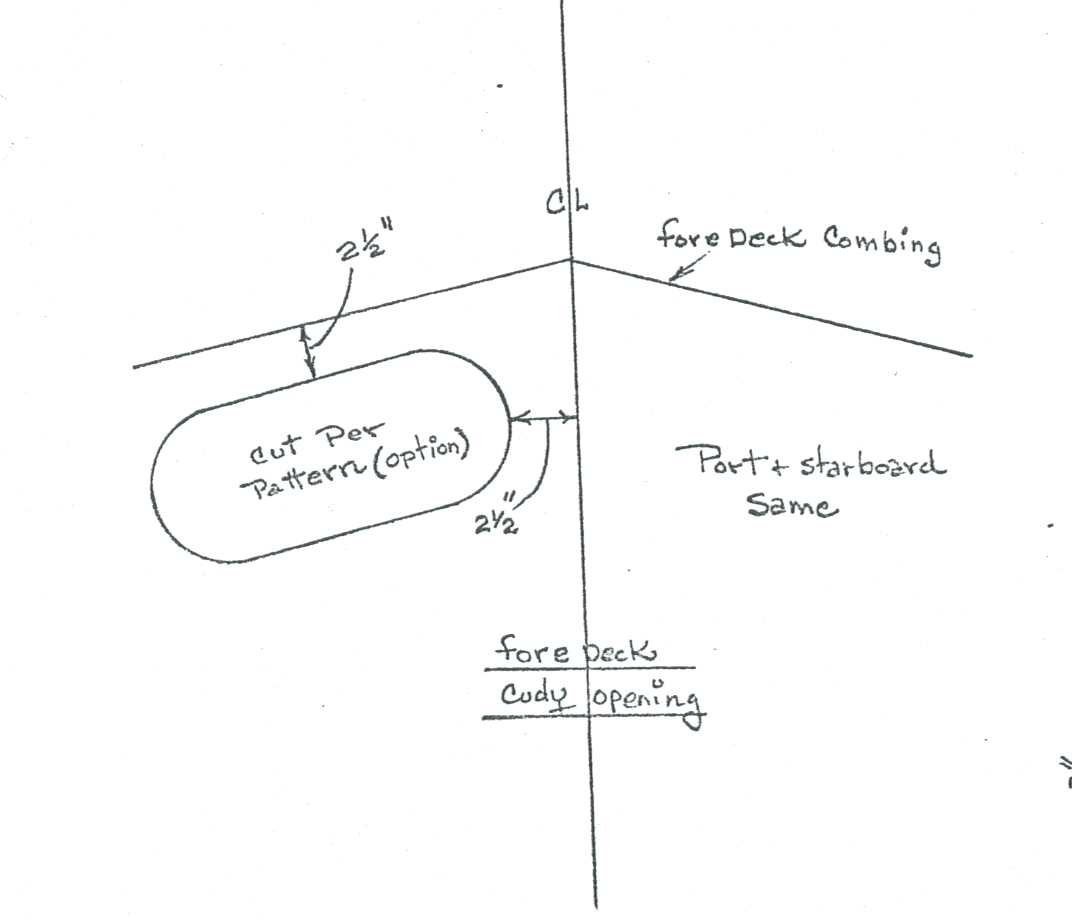

I would think that making replacement covers out of Starboard or other similar material should be fairly simple as it can be cut and shaped just like wood. Those covers were an option on the 1971-83 models. I personally like the look of wood better and find the plastic too "sterile" although using a teak colored material would look better. I think finding an off-the-shelf, sealed hatch for that area of the boat might be hard due to the small choice of sizes and I think there may be some curve to that bulkhead which the ready-made hatches won't fit. BOAT OUTFITTERS.COM in Florida could make you a nice set of custom hatches out of Starboard, but at big $$$$$$.
