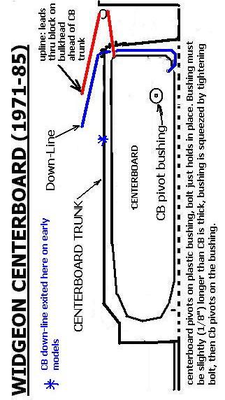

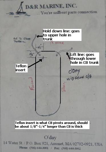

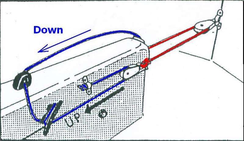

how about this?? The loop of line that controls up/down is actually a little longer (loops about 6-12" past cleat) the bullseye fairlead on top of the CB trunk may or may not be on your boat, but it isn't apparently needed if O'DAY eliminated it.
These are images from the Widgeon Owners Manual that I created with help from Rudy at D&R Marine.
