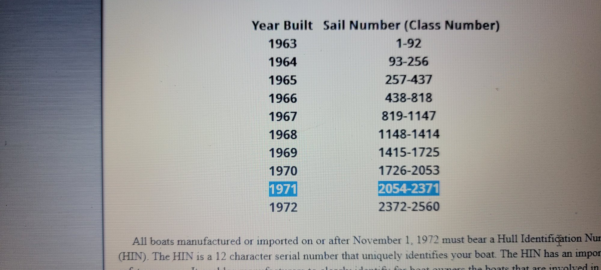

Sure looks correct.
I suspect the manual for most, if not all, of the boats will be nearly/exactly the same.

Where did you get that list of Widgeon sail numbers cross-referenced to the build years? That would be a SUPER GREAT addition to the Expanded Owners Manual that I created and sell copies of! It also confirms (if accurate?) my recent discovery that my Widgeon (Hull# 22691, Class# 17910 was a 1970 model, not a 1969 model as I had always thought.

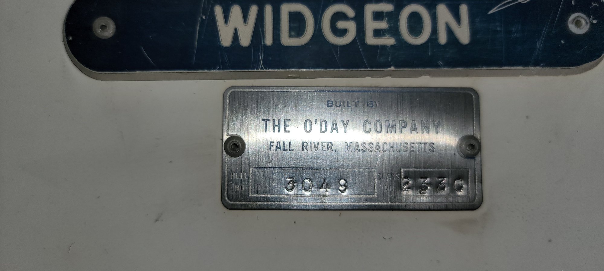

I will tell you that the very fact that your boat has that plate tells me that she is an early 1973 or older model. A picture would further narrow down the year (I have the list of standard hull colors for most years). The manual for any year of the Widgeon may help, but there were changes in the rigging setup over the 1963-89, 1990-2004 production runs.
Interesting that your ID plate is missing several digits in the Hull#, for some reason, that is very common, Class#s are usually accurate on all models, but O'DAY Hull# is often shortened. Obviously, Class# is the important number as that indicates how many WIDGEONs had been built, where as the Hull# is refering to total O'DAY production of all models, if it was complete it could be compared to the Hull# of any other O'DAY at the time and if the year of that other boat were known, it helps narrow down the year of your boat.

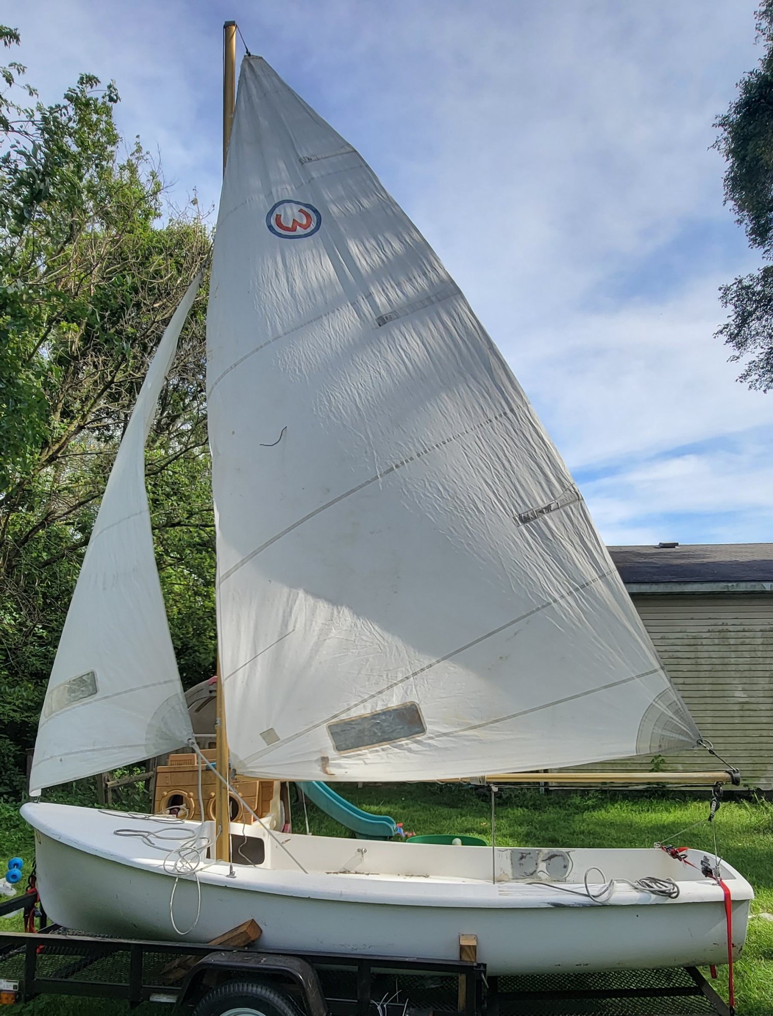

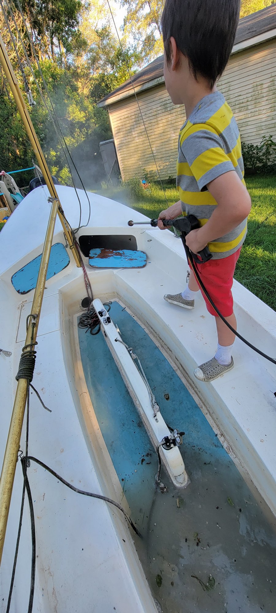

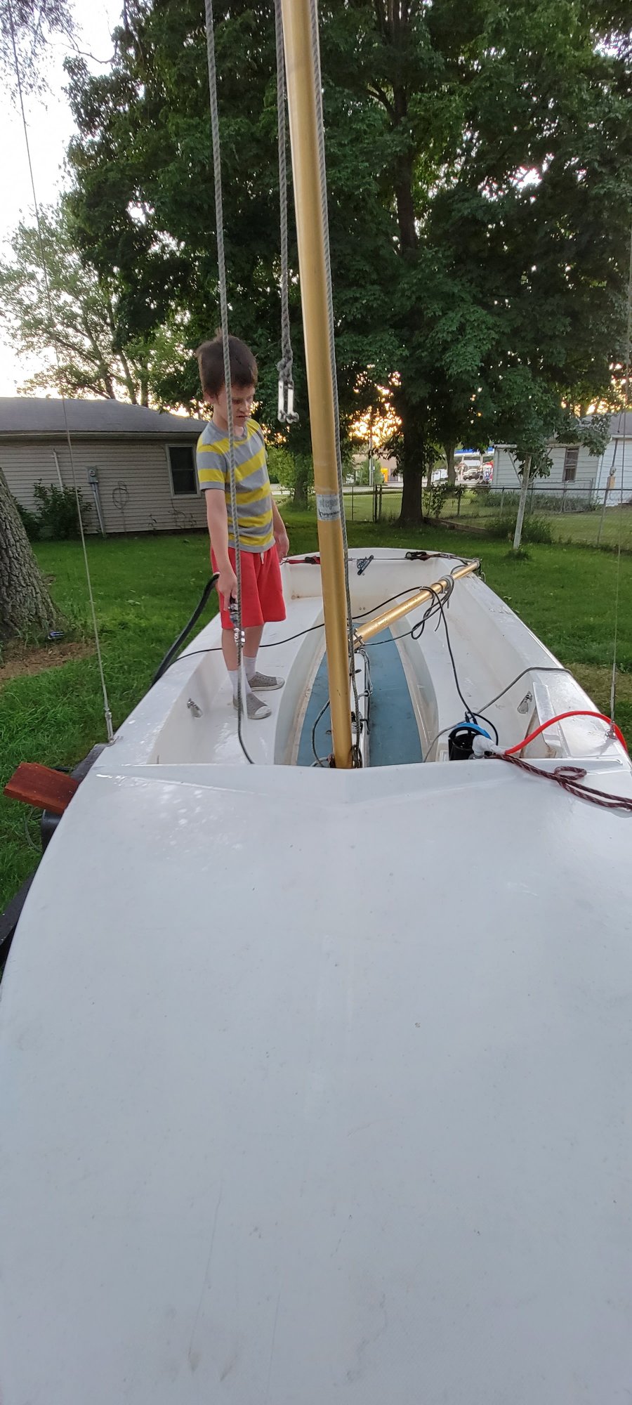

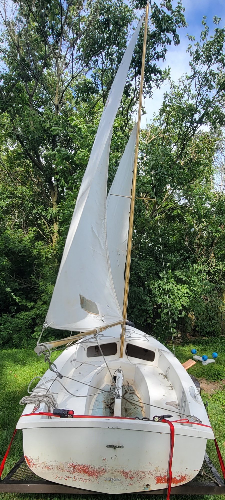

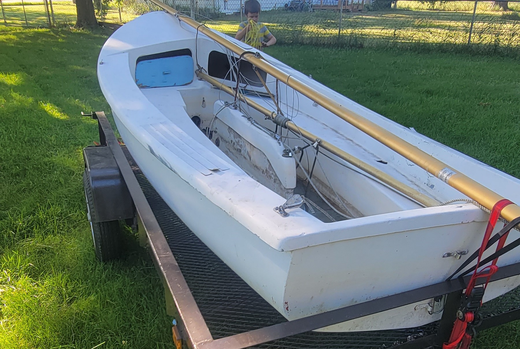

Sorry for the delay, work is busy. Thank you all for the feedback!
Had some technical issues with the cart on their website, but sent an email.
I am still learning all the terms so sorry for the lack of proper terminology, its a learning curve.
Once I can figure the ropes I should replace this year, I plan on getting some more. I had to cut one, it was to frayed and rotten.
I am looking for that website, but didn't save it; I think it came from a Florida marina.

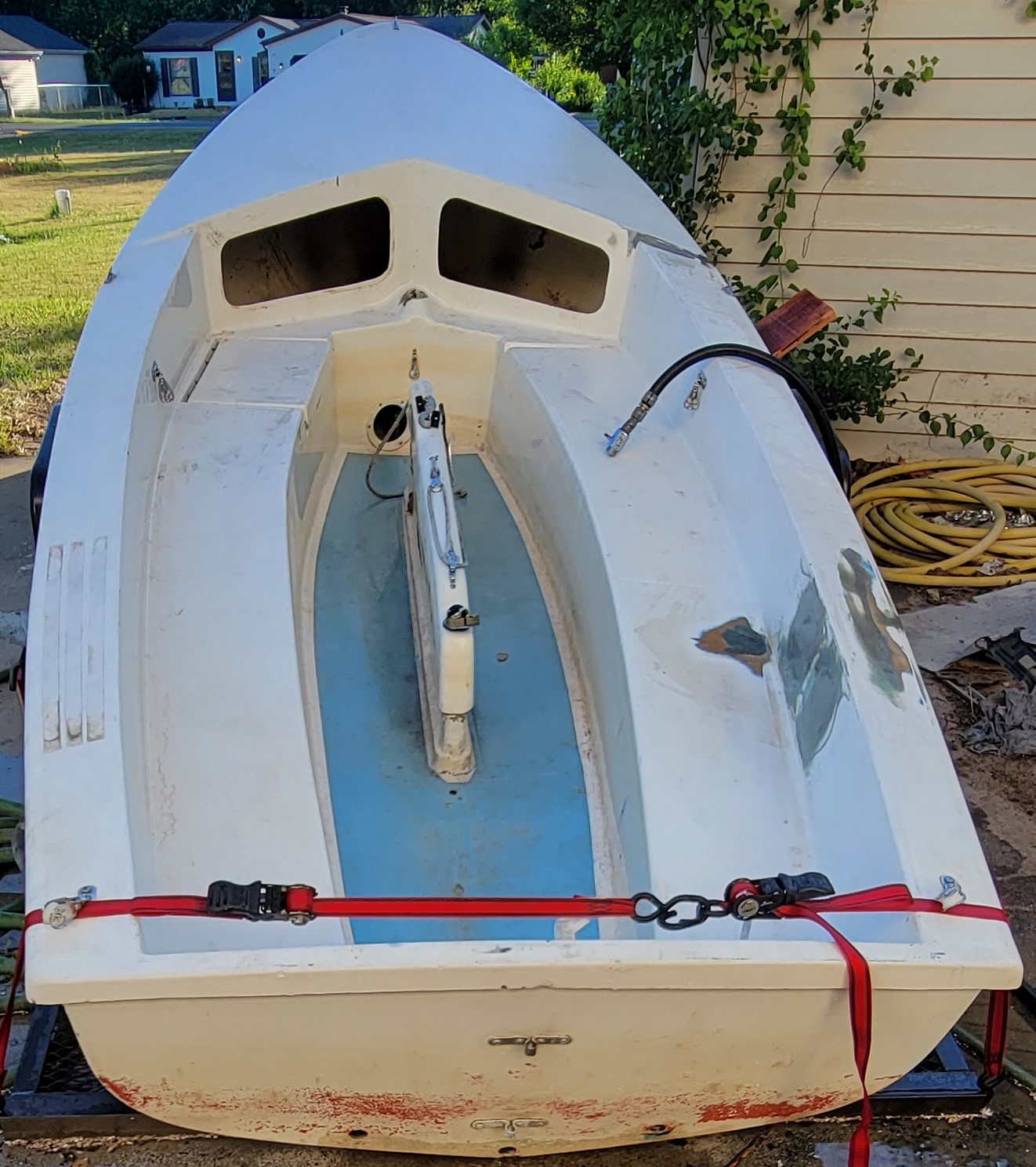

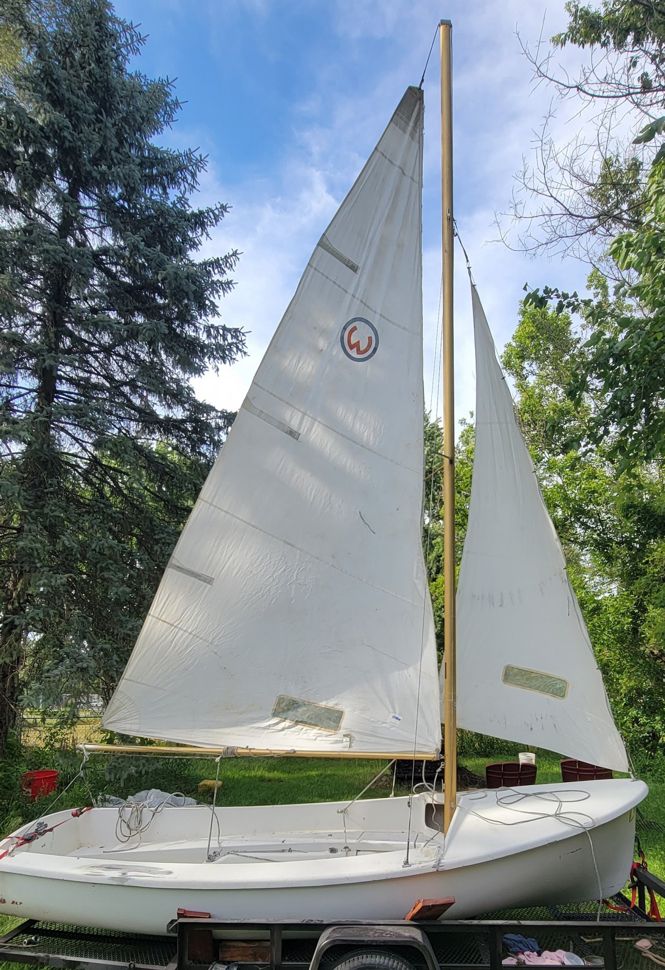

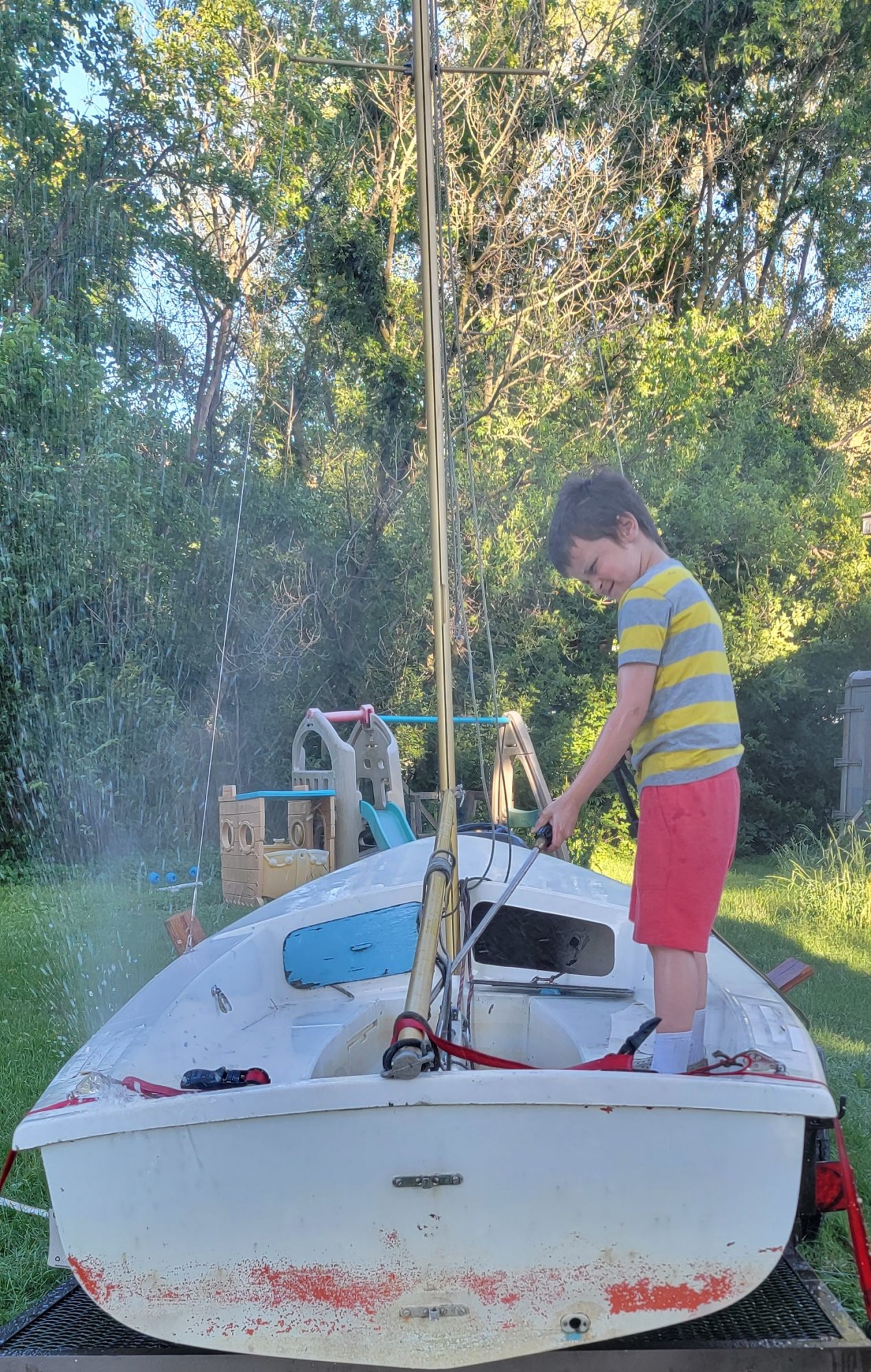

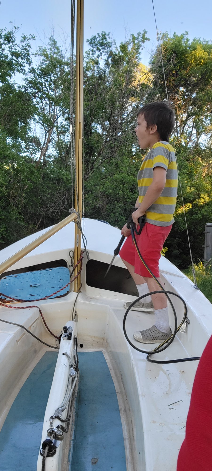

I have attached some pictures, most are my son and I working to clean it. I am in the process of fixing some of the fiberglass that has cracking and sprawling. I am also trying to sand off some sort of paint some one put on it likely in 1997 based off the registration stickers in the layer. It appear to almost be a latex or some other non gel-coat paint on the hull, but the rest appears to be a gel-coat. I have more on the way. Plan on just rolling it on, I have not worked with gel-coat before so I don't want to total my guns to shoot it. 20220617_211930.jpg20220617_184513.jpg20220617_194803.jpg20220617_200003.jpg20220617_202850.jpg20220620_174619.jpg20220620_174637.jpg20220620_174651.jpg20220622_195451.jpg

The pictures seem to confirm the 1971-2 model, the blue cockpit non-skid, jib blocks on seat backs with cam cleats on cb trunk, and built on n cooler/stowage compartment, with white hull and deck all add up to 1971-2. Can't argue with the Class# being within the 1971 range though! I suspect that the non-skid was painted blue, as it seems to match the covers for the bow stowage compartment, they would have originally been clear varnish. That would explain the 1971 Class#. BTW: I like the blue better than the "standard" Fern Green!!
I had to edit this after looking at my O'DAY Brochures again and the colors for each year. Boat could be a 1971, that was ordered with a white hull instead of the standard choice of "Fern Green" or Yellow, but all Widgeons had a green cockpit non-skid sole that year. 1972 had the blue non-skid, but standard hull colors were either Tangerine or Dark Blue, again boat may have been ordered in white as a custom color. Possible that hull or cockpit non-skid have been painted. Everything else that I stated as clues still match either 1971 or 1972, but in theory do not match 1973 or later, and this style of Widgeon (deck design) was not built before 1971 Model year.
