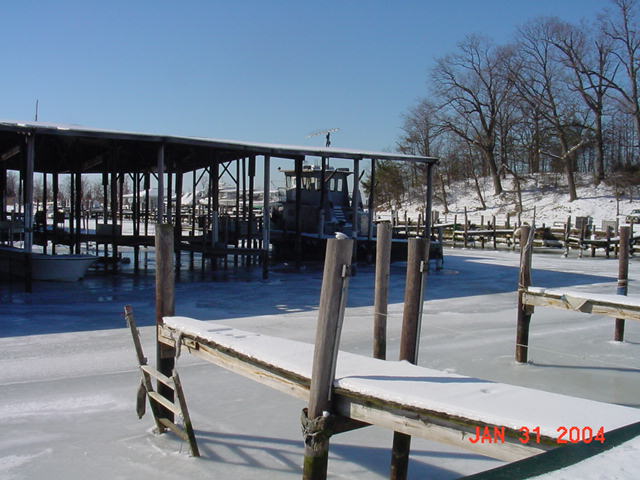

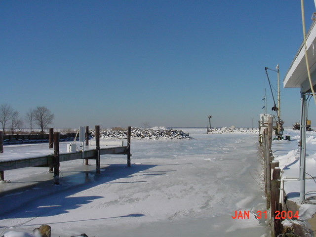

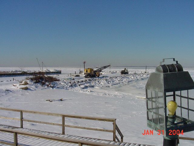

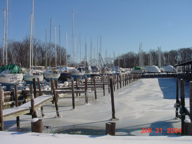

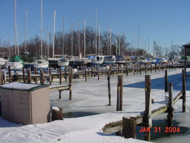

This year is again shaping up to be a quite cold winter on the Chesapeake with probably again of lots of ice. On the upper eastern shore, when the bay is thickly frozen, its not uncommon to have huge flows of drifting ice choke the harbors and creeks, especially after the NW'er winter gales.
The reason I dont store my boat in the water on the Upper Chesapeake is that during wintertime storms, power is easily lost ... and that includes power to the 'bubblers'. If there is a severe 'ice storm', the power may be out for more than a few days.
I can remember one winter season (2004?) that the upper bay froze so hard and thick, that the CG had to daily break open the shipping channel to the C&D Canal .... and of course the power was out several times for more than a few days. The ice breakup in late winter/early spring that year caused a lot of damage to boats and exposed dock bulkheads at Worton Cr.; last year the same ice damage occurred but not as severe.

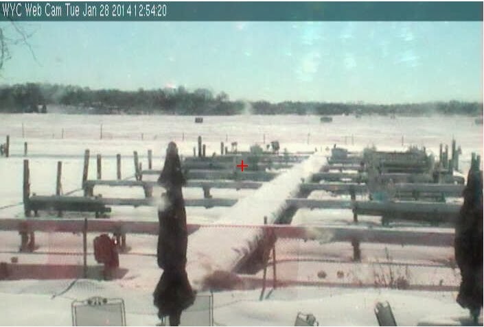

Obviously, this is a regional thing but.... here in MN. We have our reasons to haul the boat for the winter. ;)
