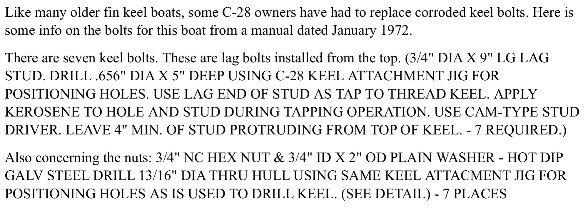

Welcome @themotorman. I found this site which tells us you have one of the 553 built and that there is detail about the keel bolts, their construction etc.
“553 C-28's were built from 1967 to 1975. There is no mention of any change from a C-28 to a C-28 MkII is indicated on the sheet.”​

This is from the link @jssailem made above
So if the original bolts were lagged into the lead would it be feasible to drop the keel, exposing enough of the existing bolts to “unscrew” them from the lead?
