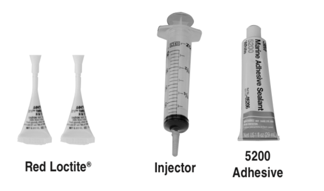

These supplies are required to assemble the Harken furler.
5200 is recommended for the foil connections. Perhaps Hood suggested something else.

5200?! Now you're in torch territory for disassembly! My last hood furler didn't have any goop inside of it

Furlers are a dealer option provided as an add on to enhance dealer profits. Dealers can offer various products to meet the buyers desires. There are various ways to install. Since the furler extrusions are not expected to be a service item, 5200 is not an unusual choice. When the furler extrusion is damaged, you need to question if the forestay has been damaged. This usually involves mast removal. The damaged part is removed and a new measured piece is inserted.

The foil extrusion’s need to react as a solid single piece as torque is applied to one end. The caulk/adhesive helps this happen and limits water entering the foil.
