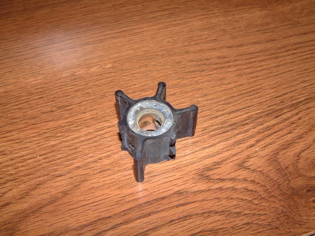

At 2010 layup, I believed my raw water pump on my Westerbeke generator was just fine. However at startup yesterday, there was no water flow. Impeller inspection revealed that two blades had broken and were gone.
This failed impeller was installed on 7/20/2010 and had only 69 hours on it. The previous impeller had 245 hours on it when I replaced it last year.
The entire pump was replaced on 9/13/2007, so it has about 450 hours on it total. The shaft was tight with no discernible play so I don't suspect bad bearings. No pump leaks at all.

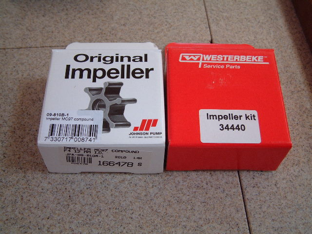

Looking at my maintenance records, the original impeller in my 2007 new pump went 245 hours and I changed it before a cruise to Maine last year. The replacement impeller that just failed with 69 hours was a Westerbeke genuine part but it was purchased in 2005. It is the Johnson 810-B-1 impeller. So the pump has a total of 314 hours on it.
I have not clogged the strainer for sure and have not air-locked the pump to the best of my knowledge.
When I replaced this impeller, the shaft was snug in the bearings, no sign of leaks, and the cam was secure. I never found the two blades, but I passed a cable tie into the intake and output of the pump and felt nothing, so I think the pieces got pushed into the heat exchanger. Access is a real problem for both impeller changing and getting the cover off the end of the heat exchanger. I have good flow that looks to be perfectly normal in volume, so I doubt the pieces are causing any restriction in the heat exchanger.
In the past I have used older impellers with no correlation to shortened life, but age of the impeller has occurred to me also.
The only other anomaly is that this new Westerbeke pump uses a different drive pin than the older pumps. Consequently the older impellers need to have the drive pin replaced before they can be installed. I can't see how re-using a drive pin would affect the impeller life as the impeller is exactly the same size and the pin is merely the drive from the slot in the shaft. See the pix below for the new and old pumps, the new and old drive pin (the old drive pin had threads the entire length), and a modified old drive pin filed down to fit the new pump shaft. The newest impellers I bought were not Westerbeke but Johnson branded.

The OEM impeller from Westerbeke is just a re-boxed Johnson 810-B1 with the Johnson part number molded right into the rubber hub..;) You can pay more from Westebeke or just buy it direct from Johnson as they made the pump and the impeller anyway. Of course the pump was built to Westerbeke specs so you can't buy a replacement pump from them, or the re-build kit, but you can buy the impeller.
I put a Globe in this spring to see if they can redeem themselves in my eyes. The last few Globe impellers I used were horrible and worse than the Johnson impellers, but that is not saying much. Of course at nearly double the cost of the Johnson impeller the Globes ought to have double the life...right...? :) Hopefully Globe has their issues straightened out but I'll know in a few months...
