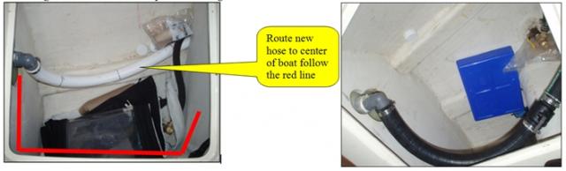

The following pic shows the before and after setup. Stuff always back flow during port tack.
The after setup routes the hose to the center line of the boat. Nothing flows back now. I added a connector (from farm supply shop) so I can use a compressor or garden water hose to clear out the hose if any thing get stuck in the 90 degree bend. I rather remove the 90 degree band but the size of the locker won't allow it.

Alex, your "before" and "after" have me a bit confused...it appears that you've run the head discharge hose all over the boat to accomplish what a simple loop in the line would do.
