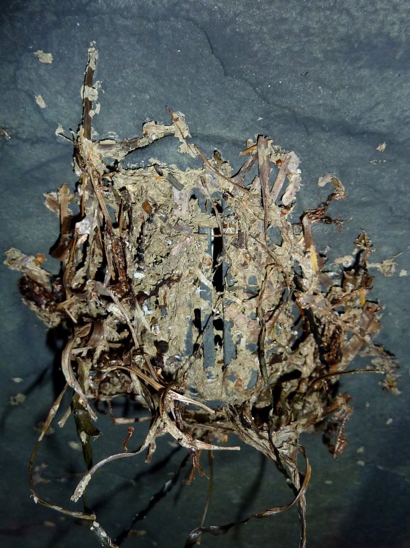

Over the years I have really grown to distrust and dislike external intake strainers of either the scoop type or the non directional round type. The real danger in these devices comes when you have a blockage and can't get to the crud to clean it. They often require a dive over the side with a coat hanger but that does not always work.
In areas with high barnacle or muscle growth these creatures know no bounds and often take up residence in the "no mans land" hiding behind the screen. After spending nearly three hours one day, in really, really cold water, even with a wet suit, trying to get eel grass out of one, I vowed to never, ever have one again. Any time you dive in your risk goes up.

Some reasons why I don't like them, some operator error, and some strainer error.....

External strainers are absolutely not clog proof or growth proof. If they can't opened it may be next to impossible to clear without removal of the external strainer screen. The worst of the external strainers are where the strainer is actually integral to the thru-hull fitting, and can't be opened, or even removed, without physically cutting it apart......:doh:

in response to the photos...
nature will take its course, and we cant do anything about that except find a way to make our job easier when nature gets in our way, and we have to remedy it.
BUT.... the number of photos that show operator error out number the ones that show nature as being the problem.
just another lessen to be remembered.... people, in their careless and ignorant ways, commonly cause more and greater problems than what nature causes us..... in almost all things we do, and even those things we dont do while knowing we should.
I count 2 in operator error (paint) 1 in error for wrong orientation and 13 caused by nature....;)
Course if we really want get picky sailboats use non-directional strainers, usually round with holes, not directional strainers whether backwards or forwards........
well, upon closer inspection it would appear, technically, that you are correct... but it cant be denied that most of the photos show a lot of the open area of the strainers have been reduced due to carelessly applied paint, which can hasten further restriction.
