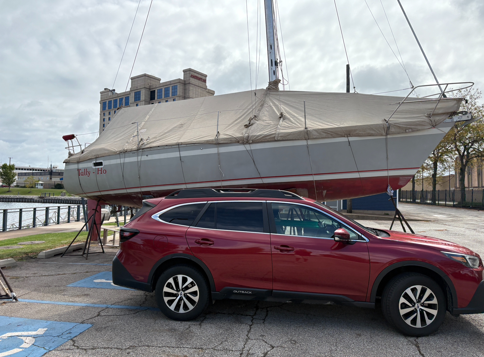

I'm also a big advocate of a winter cover. With over 100 holes in the deck, it's a guarantee that at least one of them is leaking into the core. If it's leaking into the cabin, it may be quite some time before we discover it during winter layup. Lot's of damage can occur in that time period.
As an added bonus, it's shockingly warm under the cover. You can actually get some deck work done
