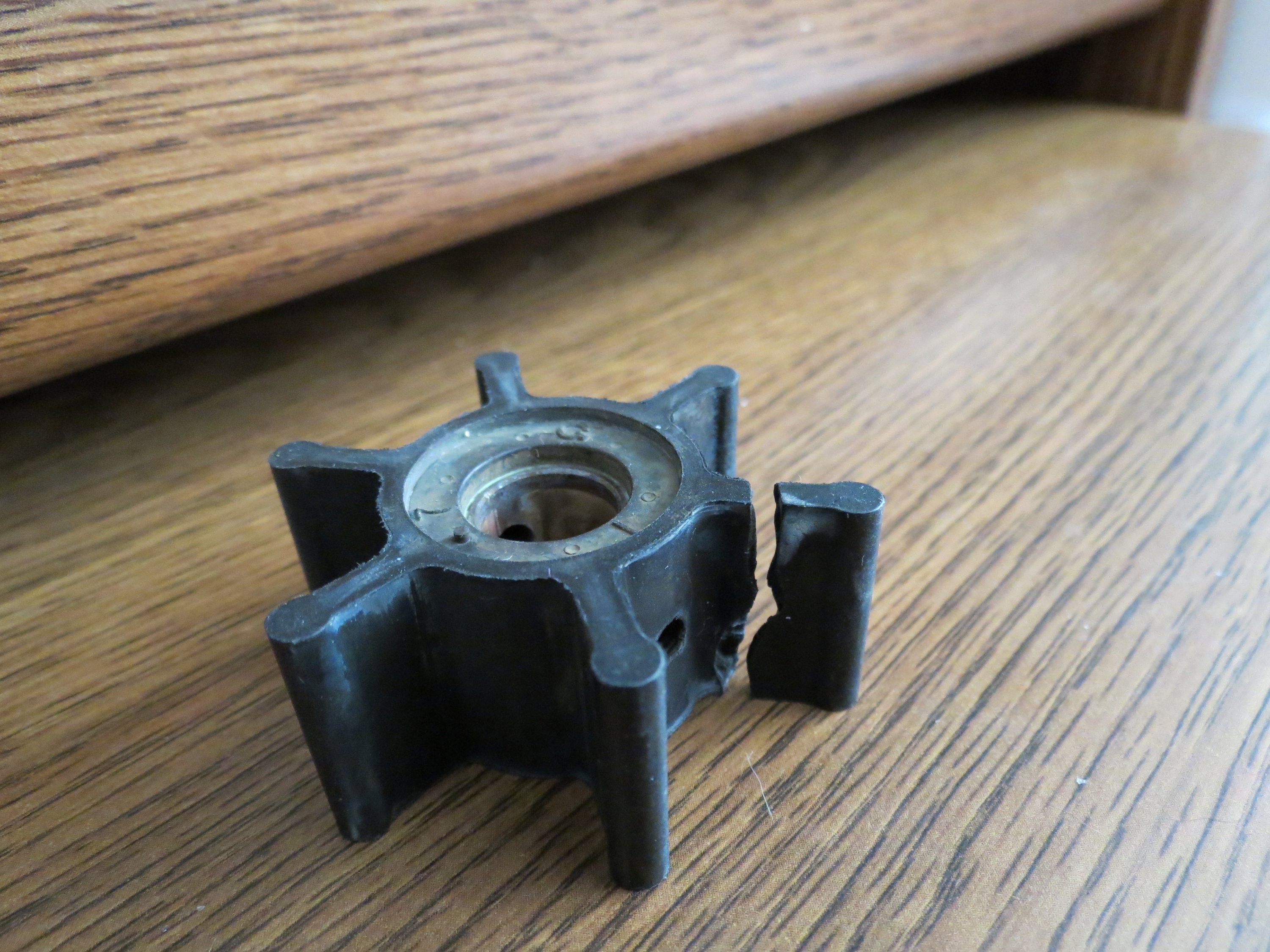

I have a Westerbeke generator that uses a Johnson 810B-1 6-vane impeller. This year I put 131 hours on this machine starting with a new impeller at the beginning of the season. Sometime during September I noticed that the discharge water flow seemed to be less volume than normal. No over-heating, or any other symptom of a problem. Absolutely nothing in the strainer, and strong flow into the strainer from the thru-hull. Checking the pump shaft I found no play that would indicate bad bearings. No pump leakage either.
About a month later at the end of the season I pulled the impeller and found one blade missing. I located that piece in the discharge port of the pump.
So I am wondering why I see impeller failures so frequently. Hardly a year goes by without a broken vane. Looking at my maintenance data, 12 out of 16 impeller changes over 2591 hours showed one or more vanes missing. I can attribute 3 of the 12 failing impellers to a severe seaweed plug in one case and bearing failure in the pump for the other two cases.

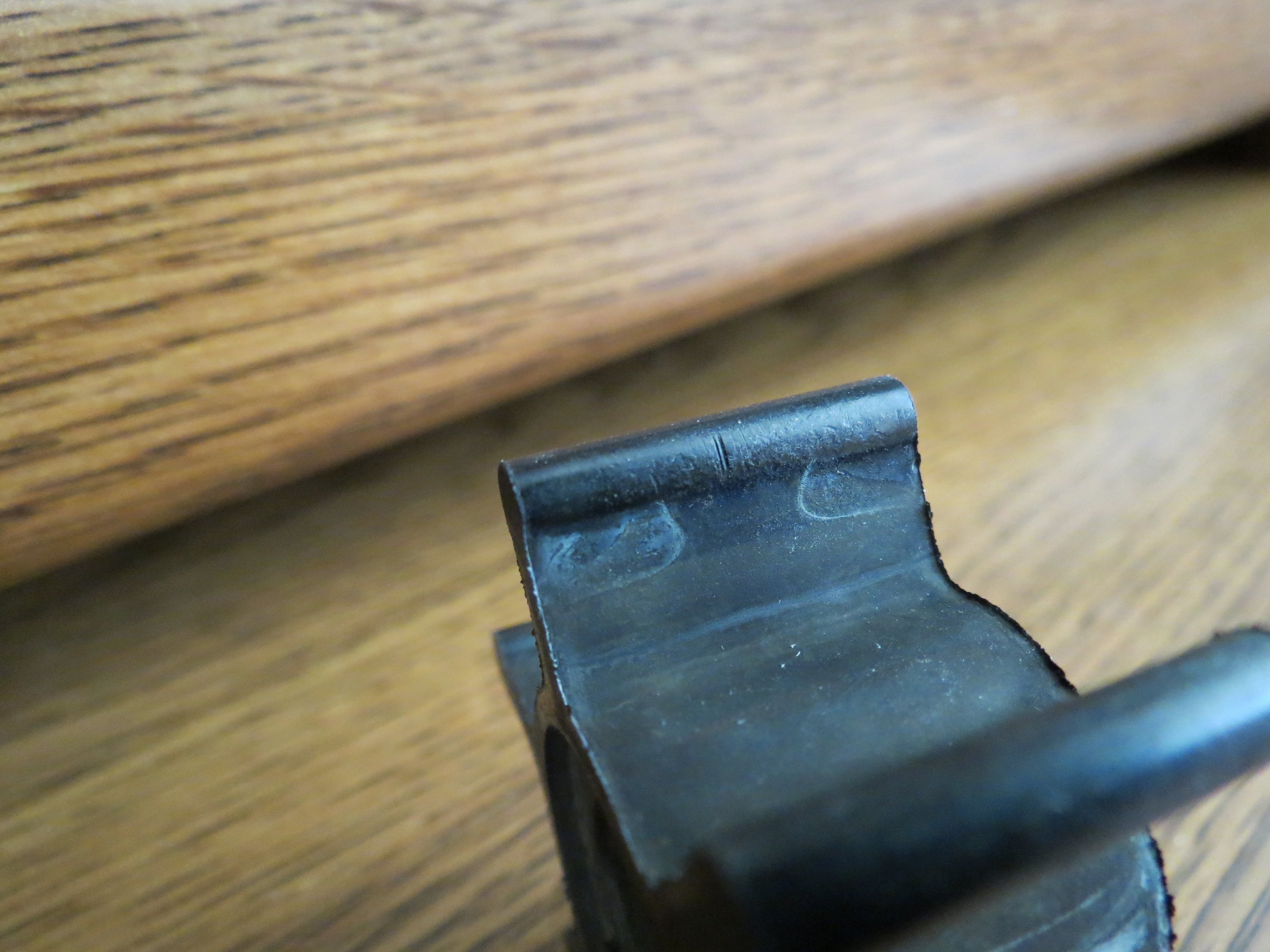

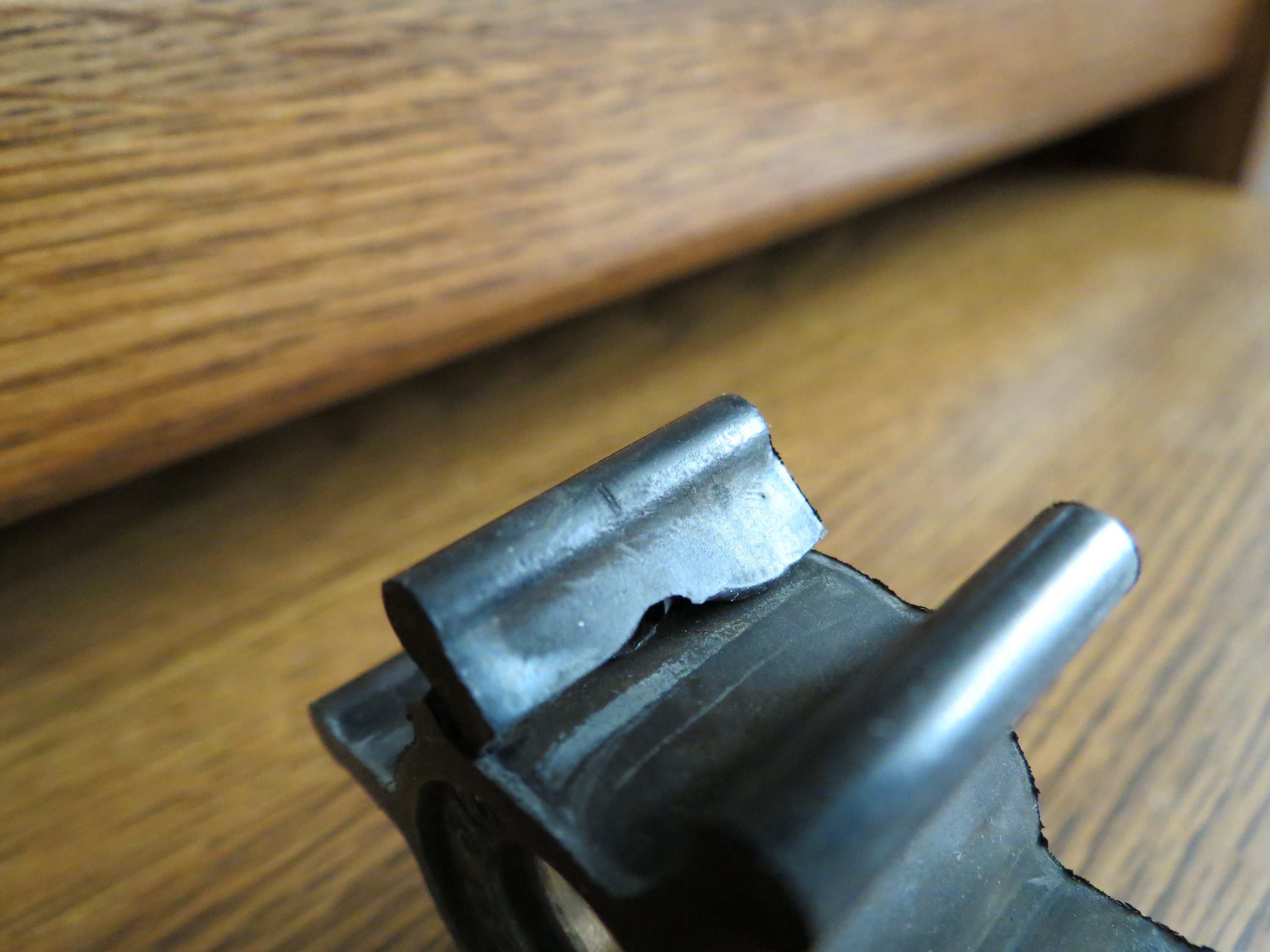

OK, taking your suggestion I looked closer at the failed impeller. All of the vanes including the broken one appear to have no wear or flat spots. There were no cracks at all in any of the intact vanes. I did see a small vertical notch in the center of every vane - see the attached pictures. When I get back to my boat in the Spring I will look closely at the pump internal area to see if I can find an edge or reason for this notch. There are about 1090 hours on this pump, in service for 8 years.

Jerry, I agree the Speedseal Life is a great product and will protect an impeller from the heat and failure caused by friction with the cover plate BUT looking at Rich's photos I see none of the tell-tale heat stress cracking from that kind of failure. There do appear to be cracks at the base of each impeller blade, like it is flexing too much. Mystery to me. Maybe try those Globe urethane impellers...
