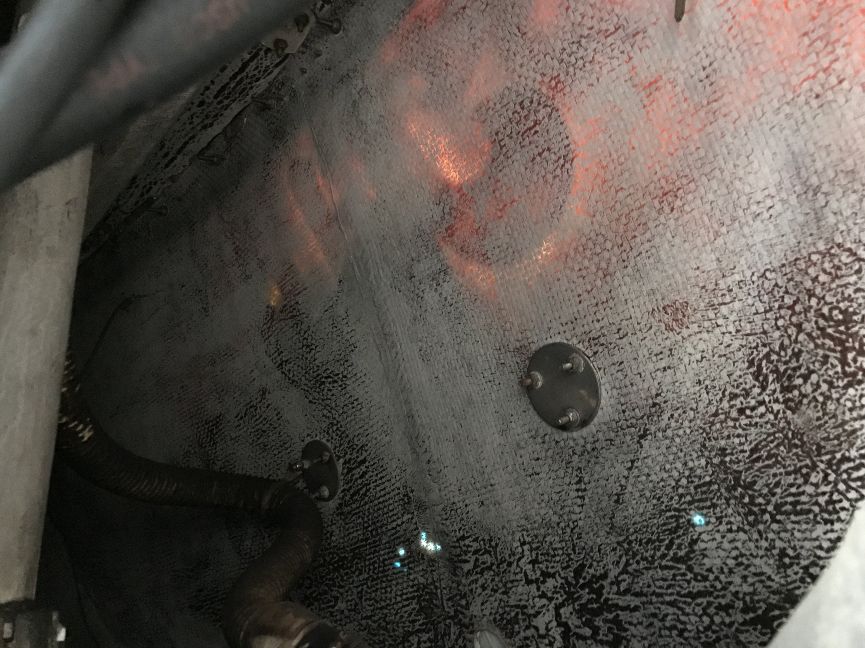

Why can I see the boat lettering through my transom?

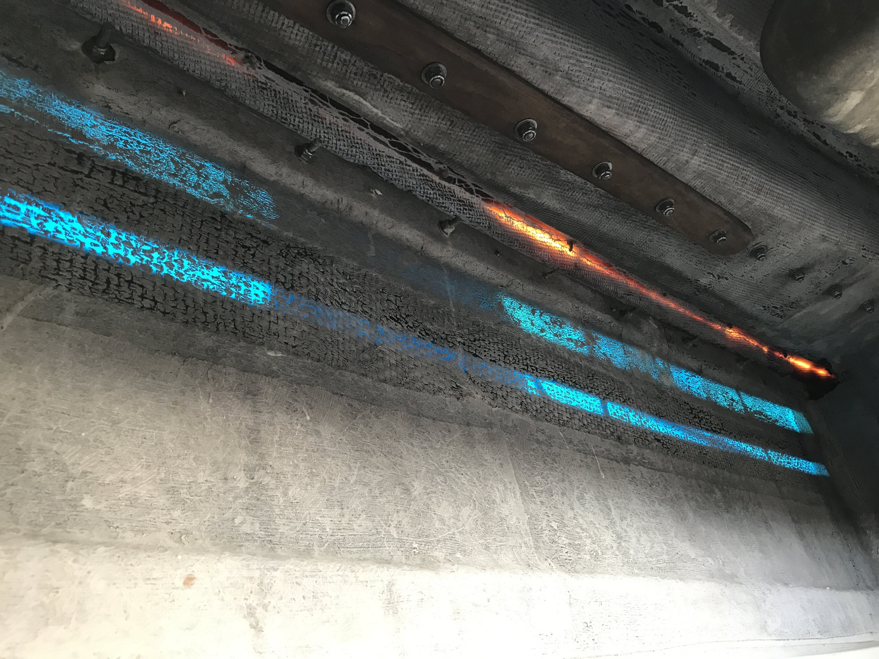

Glass Reinforced Plastic, aka, fiberglass, is normally translucent. Gelcoat reduces light transmission, but on old boats the gelcoat begins to oxidize and through polishing and buffing it gets thin and allows more light to be transmitted through the hull. The thicker the original fiberglass, the more opaque the hull is. Coring, such as end grain balsa or foam also increases opacity.
As Ned said, painting the interior of the hull will hide the translucent areas.
Hull thickness also varies, low stress areas will have thinner fiberglass and allow more light transmission. You can see this at a big box hardware store, take a look at the corrugated fiberglass roofing panels, or the roof of a UPS truck that has a fiberglass roof.

Thank you all for the quick response with great info. So clean/ prep for painting, a little 3m 5200 on the spots that are through to the gel coat and paint. Thank you all again.

What are you trying to fix? And what is the adhesive for?

There are some very small holes that go through to the gel coat. If you enlarge the pic you might get a look st what I'm trying to fix. Also, What's up with the 5200?

if you just need to cosmetically repair some small holes why not use MarineTex?
The white would be a close match to white gelcoat, and it is also available in gray.
Forget abut 5200 unless you want to permanently stick a swim plaform onto the transom.

5200 is an adhesive and sealant. It is absolutely tenacious in its holding power, being nearly impossible to remove. It should only be used to secure things that will never need to be separated. On a boat, the only application that seems reasonable is to attach the deck to the hull. Some might argue that it is appropriate for the keel, but sometimes keels need to be dropped.
MarineTex or a gel coat patch kit can be used to fill in the chips. Unless the repair is going to be painted or otherwise protected from UV avoid epoxy it will degrade with exposure to sunlight.

If the voids are inside in the fiberglass, use thickened epoxy to reinforce and fill them. It will stay in place on a vertical surface. If they go through the fiberglass and gel coat, you should fill them inside with thickened epoxy and then apply some gel coat outside. Leave a little dimple on the outside in the epoxy, so you have a small dimple into which you can dab the gel coat. You could also use Total Fair, AwlFair, or 3M Marine filler in place of the thickened epoxy. Those are 2 part thickened epoxy fillers. You can also tape them inside and apply the epoxy from outside, leaving a little dimple. No 5200 needed in this situation!

Marine Tex is also an epoxy. Totally agree on no 5200- that's NOT what it's meant for

If you are going to fill holes from the inside I would us West Epoxy. As for the thin fiberglass, painting will help you forget it, but it still will be thin. ODays are decent coastal cruisers and if that is what your going to use the boat for, you will be fine painting it. If you want to beef it up you will need to add more fiberglass cloth from the inside.
