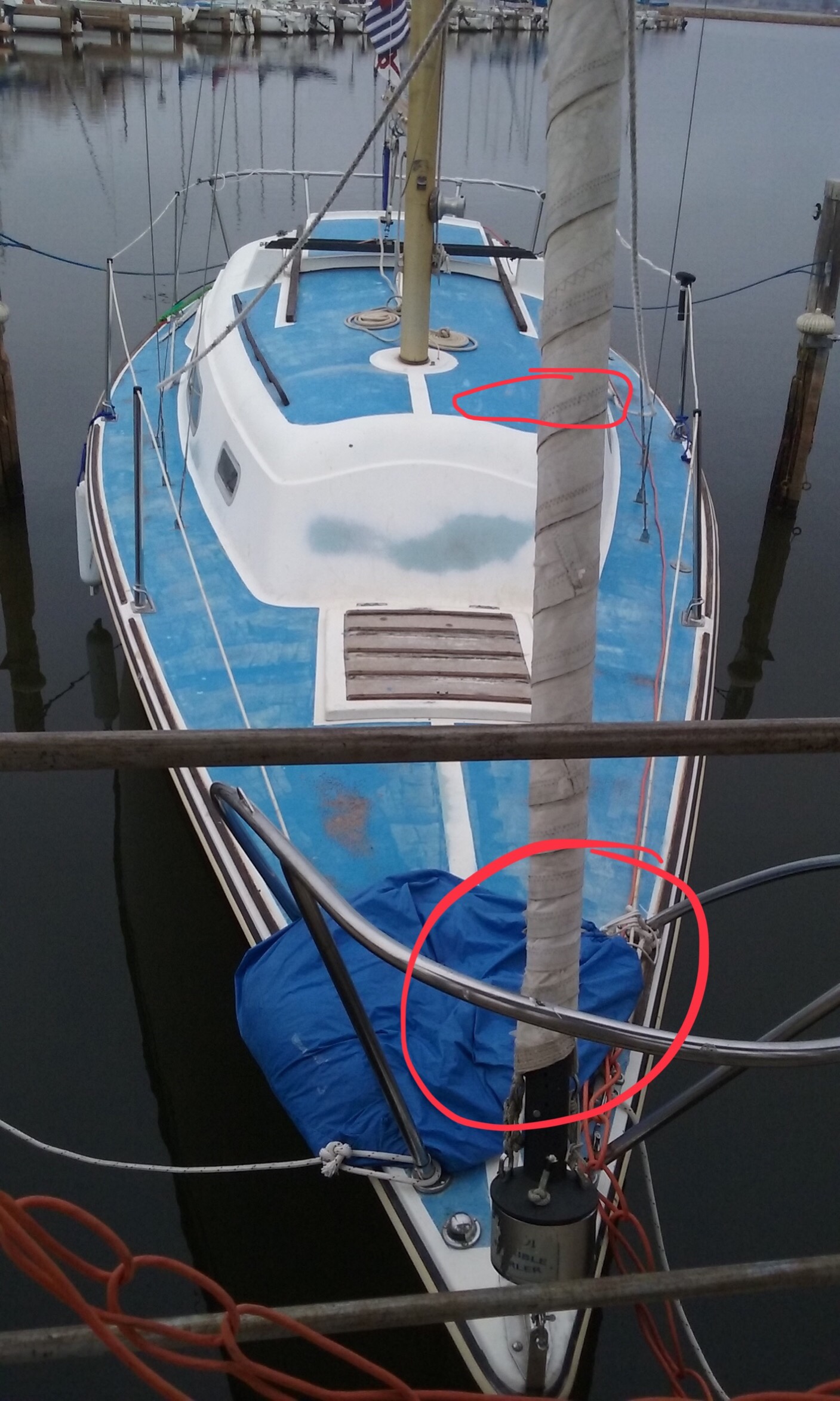

I recently bought an O’day 27. Anyways I got a really good deal on it. It’s in good interior condition and needs a new top paint job. I know there’s two soft spots on the deck and above the cabin otherwise everything is solid in my opinion. A guy that’s been around sailboats all his life and nearly bought mind before I had the chance is the one that pointed it out to me. Anyways a guy that makes a living fixing boats was out by it today and new it was mind so went onboard and said the complete deck, above the cabin and complete cockpit needs to be replaced. Who do I believe?

It's your boat now, so you don't have to spend any money that you don't want to spend. Is it soft around the mast? Can you see the roof flex around the mast? What happens when you tighten shrouds? Do cracks appear around the mast? Does the bulkhead underneath seem to flex? On the deck, around the areas where it is soft, do you see cracks?
Make your own observations and then make up your own mind. If you got a really good deal on an O'Day 27, that probably means that you didn't spend a lot of money to begin with. If the boat has defects, it's a pretty good bet that you can live with them, unless you see flexing or movement that looks like a pretty obvious problem. There isn't always a real need to throw money at an imperfect boat.
I bought my 27' boat almost 14 years ago, not knowing really anything about soft cores, etc. I hired a surveyor and he probably wrote something down such as "soft decks", which I could feel underfoot on my own. There weren't any cracks so I didn't worry about it. 14 years later, they are still soft and I still don't feel much need to worry. I might get around to doing something about it someday, but in the meantime, I'll just keep sailing.
I've fixed leaks, stiffened bulkheads and done several improvements when it seemed like there was an obvious need.
To shorten a long story, don't let somebody tell you what you need to do on your boat. If you can sail it, consider yourself fortunate. Make your own observations and then make your own decisions based on what you see.
You can always come into this forum to get clarification if you see things that bother you. Take photos! There are a lot of guys in here that you can believe (but I may not be one of them!) ;)

Ok, I spoke with the guy. I miss understood what he was saying. He said all I need to get it sailing is a bit of new rigging. He said the decks are soft but nothing cracking. He sail it’s pretty already so there’s a few winter jobs that we can do. He also said I got a good deal. So I’d say my decks are about like Scott’s. I panicked based on his text. As for the soft spot on the top of the cabin it’s not that bad. He said it’s sail worthy now. Just need to buy an outboard motor. Oh and I would always believe you Scott :0)

I have no cracks. There is a spot that in the boats past life the forward tip of the boat got ripped open and sat ripped open for weeks unattended. So there’s a soft spot near their
IMO if the repair was done well enough that the stemhead fitting can take the load of the forestay it should work for a long time. Later models of many of the O'Days opened up the deck in that area of soft deck and put in an anchor locker. On my 23 I saw no extra reinforcement for this anchor box. If the area just aft of the stemhead fitting (first 8") is soft you will probably want to repair it due to the compression load there. In the slip loosen the forestay turnbuckle and re-tighten and see if anything is flexing. A cardboard template made when it is loose will help with the visual, of any movement. I'm with most people here and wonder where Jackdaw is coming from with his O'Day comment. Hey #Walt he's not the one bashing Macgregors is he. :) Hey Jackdaw, "I still love you man" :ass:

Regardless of who is right, I think you need to drain it. drill small holes and dry it out. That should give some perspective on the size of the problem. Water doesn't stay in one place. It seeps. Get it dried out, so it doesn't get worse. You may be able to back fill it with Wood Hardener from Menards if the areas are still small.
