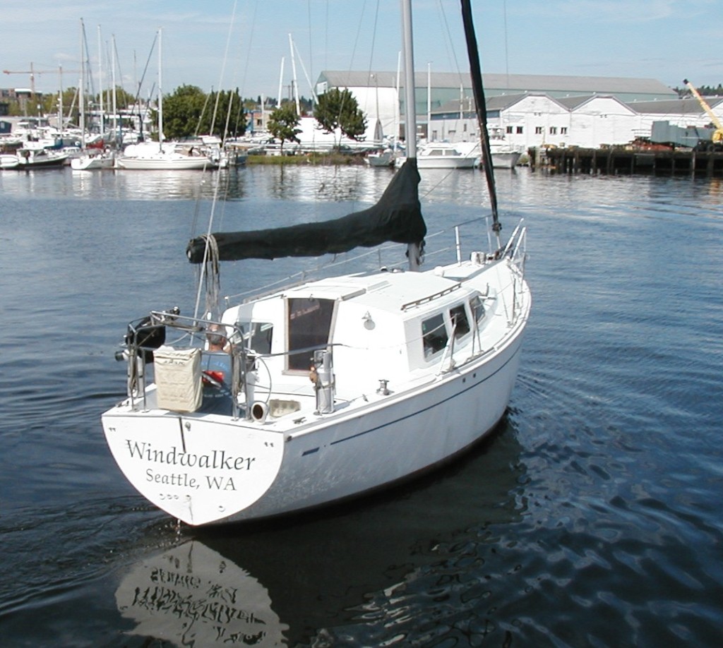

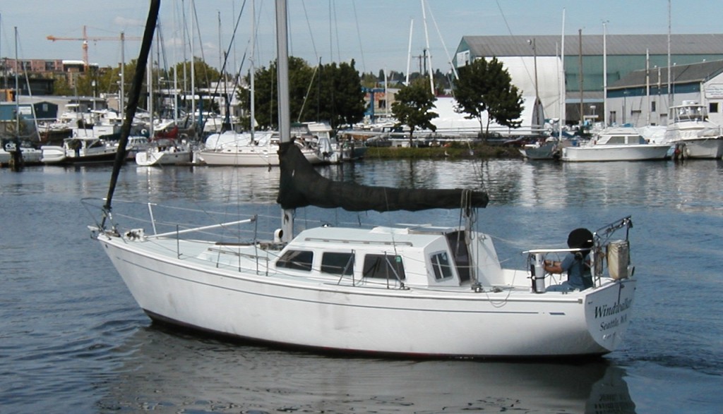

Ok. Thanks Ted. I have what looks to be 1.5 inch ID pvc pipe running from the floor drains to the transom. They are through hulled there and are above the water line in normal conditions. If I crank up the engine the hull does sit about 12 inches and the through hulls dip below the surface. I usually back off because I'm uncomfortable with them being below the surface and I'm not moving any faster through the water.
Is there any issues with PVC pipe as drain lines?
23,049
PVC is OK, but we use wire reinforced hose to our cockpit drain lines in the hull above the waterline just forward of where the transom meets the hull. I think you have pretty much the same boat "lines" aft there in profile.
