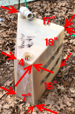

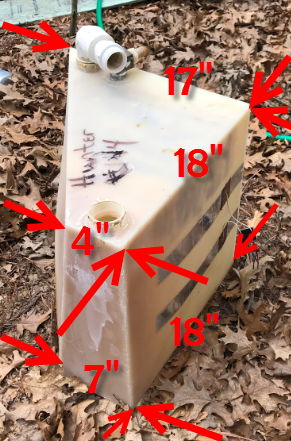

Hi all,
I"m currently replacing all components in our 1989 Hunter 30's head. The last piece of the puzzle seems to be this Waste tank which I cannot seem to find. I contacted Ronco and a few other manufacturers with no luck. Waiting to hear back from Dura-weld Plastics.... Does anyone know where I might find a similar tank? If not - perhaps recommend someone that makes custom tanks?
The problem with this tank is that it is giving off some type of chemical odor. We removed the tank and power-washed it, scrubbed it, etc. I put the old tank back in the boat with all new pluming, head, etc. I removed all of the rotted wood, and cabinets and made new.
After a day with this old tank back in the boat the head started to smell again. We hadn't even used it. We tried spraying it with different deodorizers with no luck. Finally I took the tank out - the next day the odor was completely gone.
I'm not sure what the odor is - but it's on the outside of the tank and I can't get rid of it... Perhaps the outside of the tank could be "sealed" with some type of paint or epoxy?

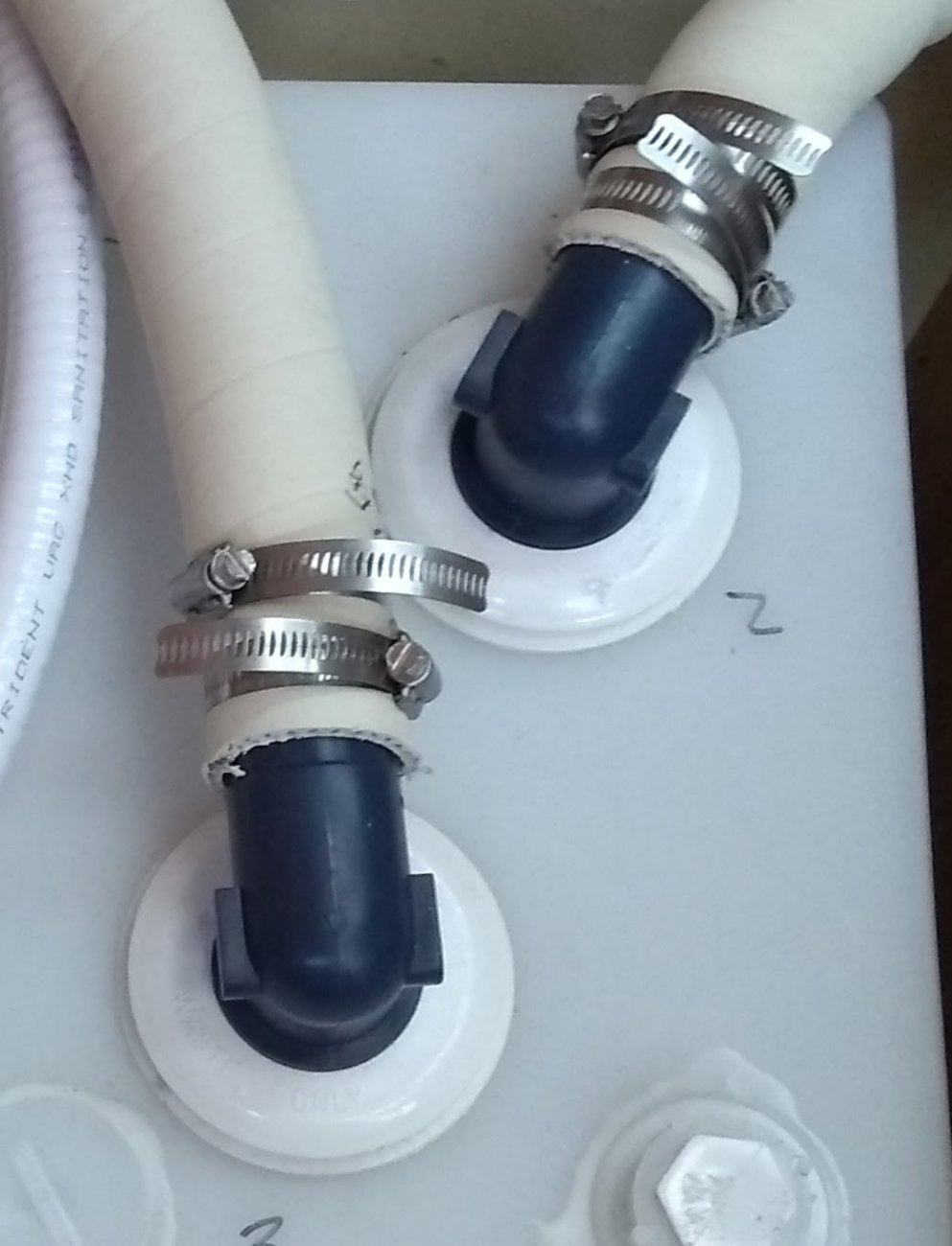

ALL fittings on the top is my favorite way to do it...IF you have enough clearance above the tank for fittings. At least 5" is needed for 1.5" 90, which you'll almost certainly need on the inlet from the toilet. The "diptube" on the discharge fitting should actually touch the bottom, but cut at about a 25 degree angle.
I had very limited space on the top of my new holding tank but was able to get things to fit using one of these for the elbow:
https://www.marinesan.com/Tight-Elbow-p/600342806.htm
wrapped in teflon tape and screwed into one of these:
https://www.marinesan.com/Sealand-1-5-Flanged-Fitting-p/385311252.htm
which was then pressed into the 2" Uniseal
In total it required less than 3" above the tank.
You can use the same setup for the discharge fitting by gluing the 1.5" PVC pipe to the bottom of the flanged fitting.

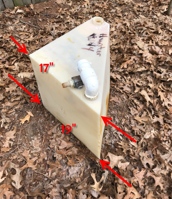

We bought a 1994 Hunter 30T this spring, and have been struggling to figure out where exactly this little leak... and stink is coming from. I'm pretty sure now that the metal tank has corroded and is seeping..... a nice slow problem, but so foul!!
It looks from these photos, that there is certainly space for a larger tank that what is there. I haven't cut into the aft berth bulkhead yet, but I guess that's the first step.
I was hoping to have a new tank in hand, and get the job done in one visit.
Many of the tanks that I'm looking at have the openings on the side, not the top.
Anyone want to comment on this.... pros/cons
(Original tank that is there, has both. One on top, and two on sides.)
Not the best way to do that 'cuz it made the diptube impossible to remove without also removing the Uniseal. Make the diptube long enough to stick out high enough able the tank enough to attach a 90 if you need one...make it a little longer to use as a straight hose fitting. I hope you did use a dip tube long enough to touch the bottom, cut at about a 25 degree angle. Any flatter, undissolved solids or TP can get caught under it...any sharper leaves too much in the tank.
