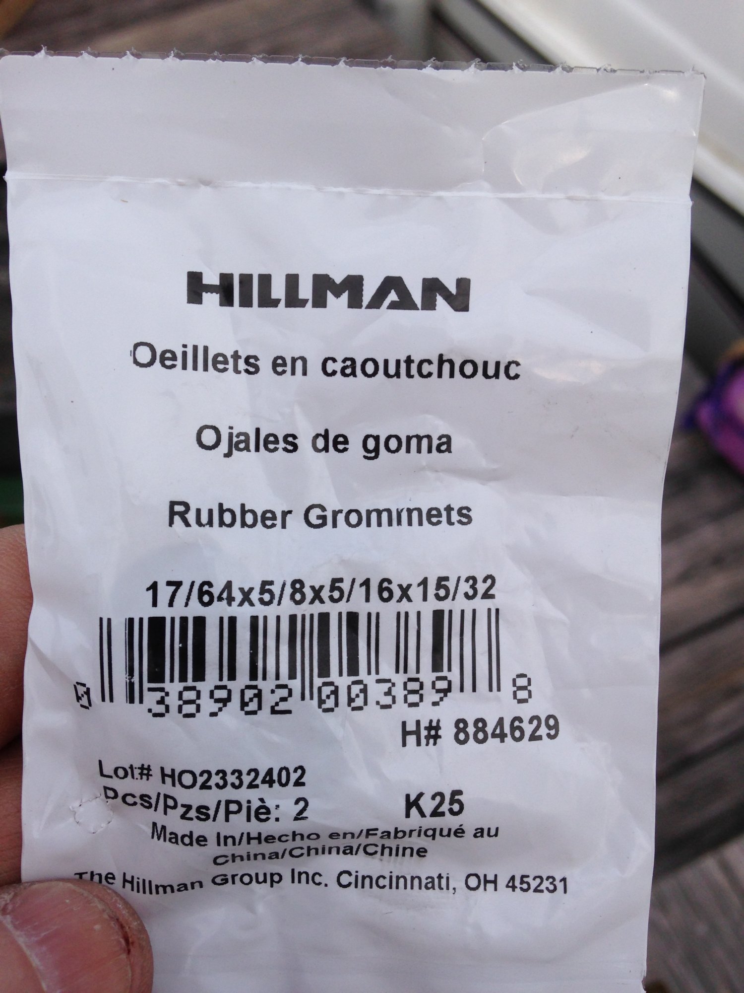

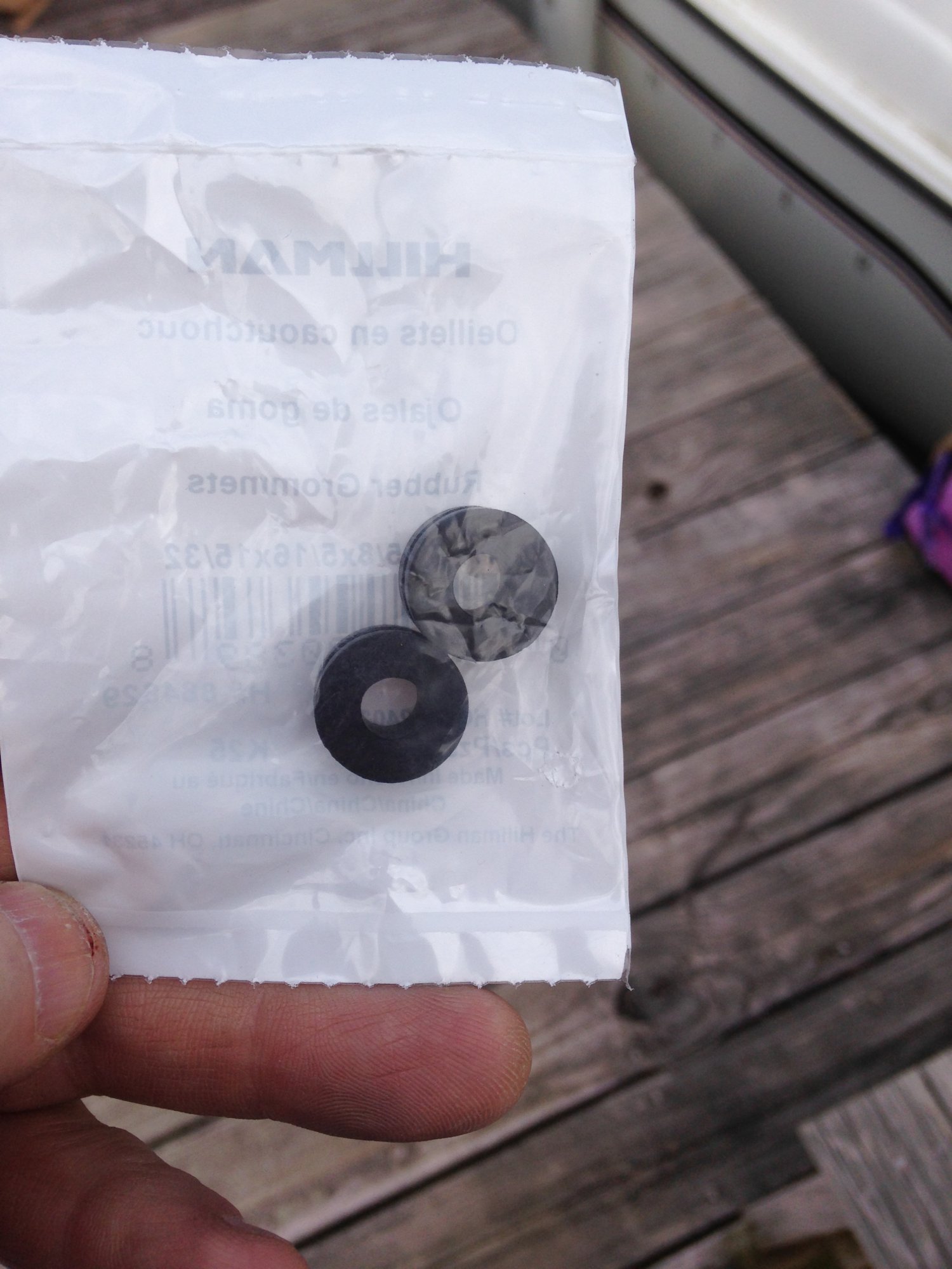

Also... if you opt to mount it on your mast crutch pole and run the line in the pole, I recommend getting these grommets (available at Lowes) to keep the edges of the holes you drill in the aluminum pole from nicking your insulation.

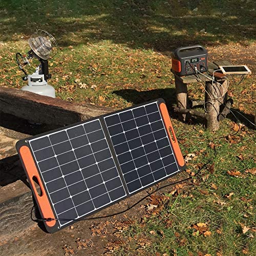

Cal Cal 33-2 cape cod
Not sure if this helps? Or perhaps different solution to similar issue? I use a Jackery 100w solar panel with the Jackery 500 full power station. My onboard battery's stay lit, because they are charged when motoring then left alone. The panel can be secured to mast, easily folded and stowed. I've got 5 people aboard with all types of devices, cell phones, ipads, fans, Gps, computers, USB rechargable devices (shower, flash lite) cabin lights ect.... The benefits 1) Jackery 500 comes home for off season (great for outages) 2) Available for camping 3) Is portable, light weight, charges in 3hrs full sun 4) Can run many devices. 5) If run down, I can still start boat.
