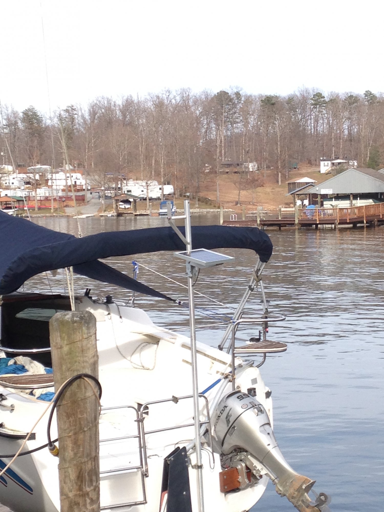

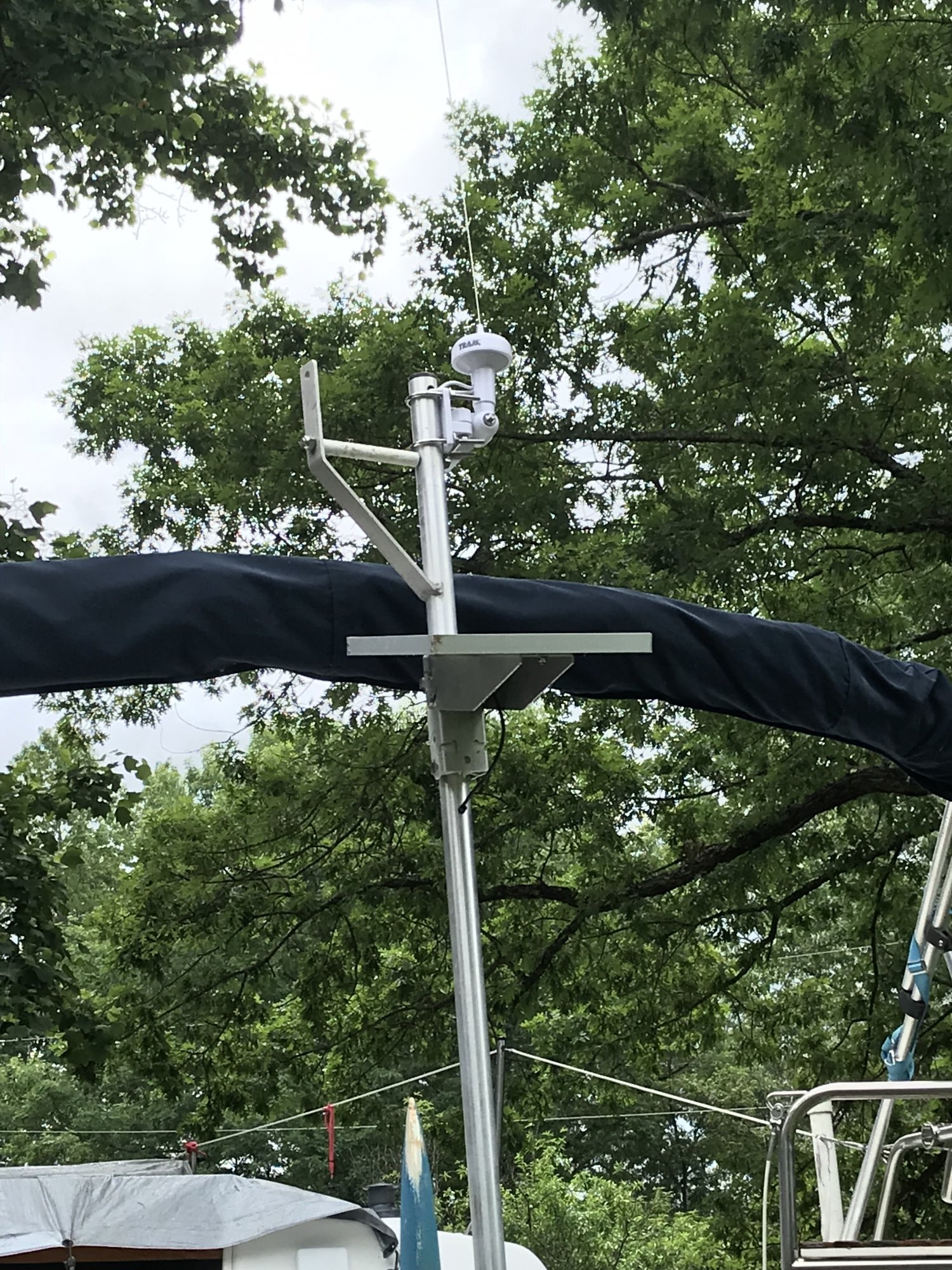

Not sure what you're definition of 'successful' is, so I wont make that claim. I still haven't found the time to write up the project - but based largely on the article found below, I built a similar system (BTW, if you find value in the information linked below, please consider donating to Rodd's stroke recovery fund @ https://paypal.com/donate/?hosted_button_id=NLBJAT2KVK4RQ&source=url).
Maine's small solar panel article
I used a 30 Watt monocrystalline Renogy panel, a 4A Genesun MPPT controller and appropriate connectors/wiring/fusing. I also fabricated a collabsable stainless steel bracket to mount the panel to. This setup has done a great job at keeping 2 'Group 31' batteries topped off on a mooring for the past 2 seasons.

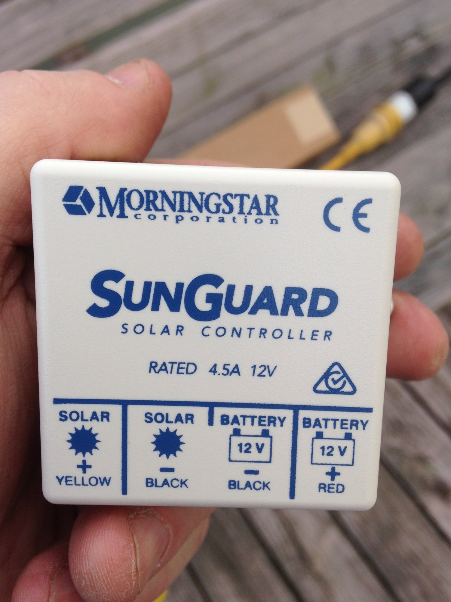

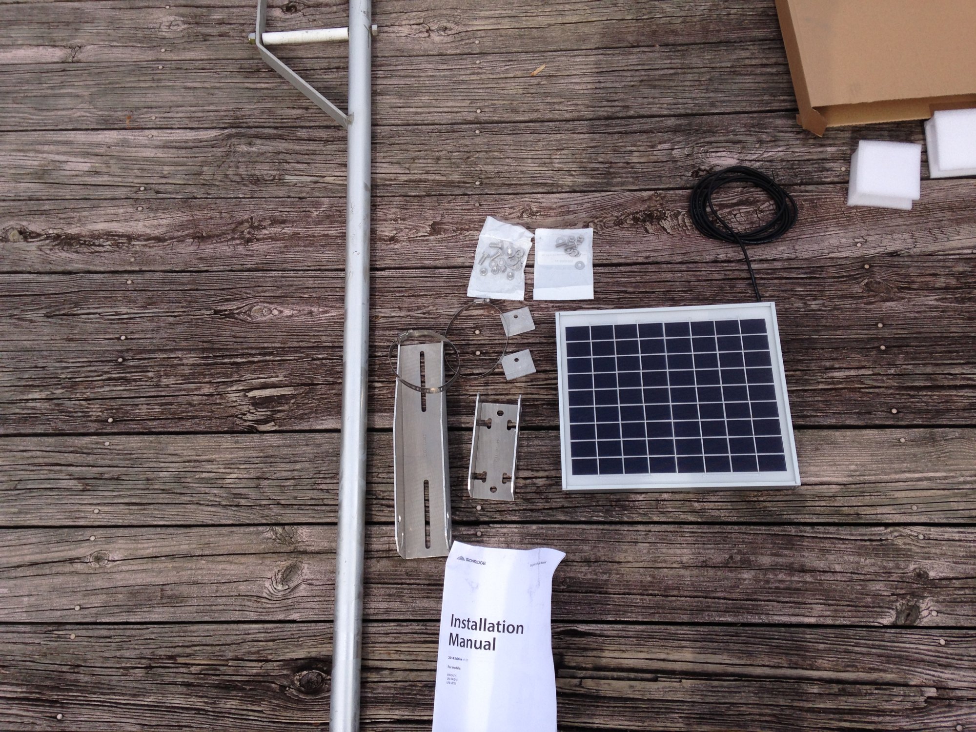

So what is that - 10 watts or so? What is your usage and how does it do keeping your battery charged?

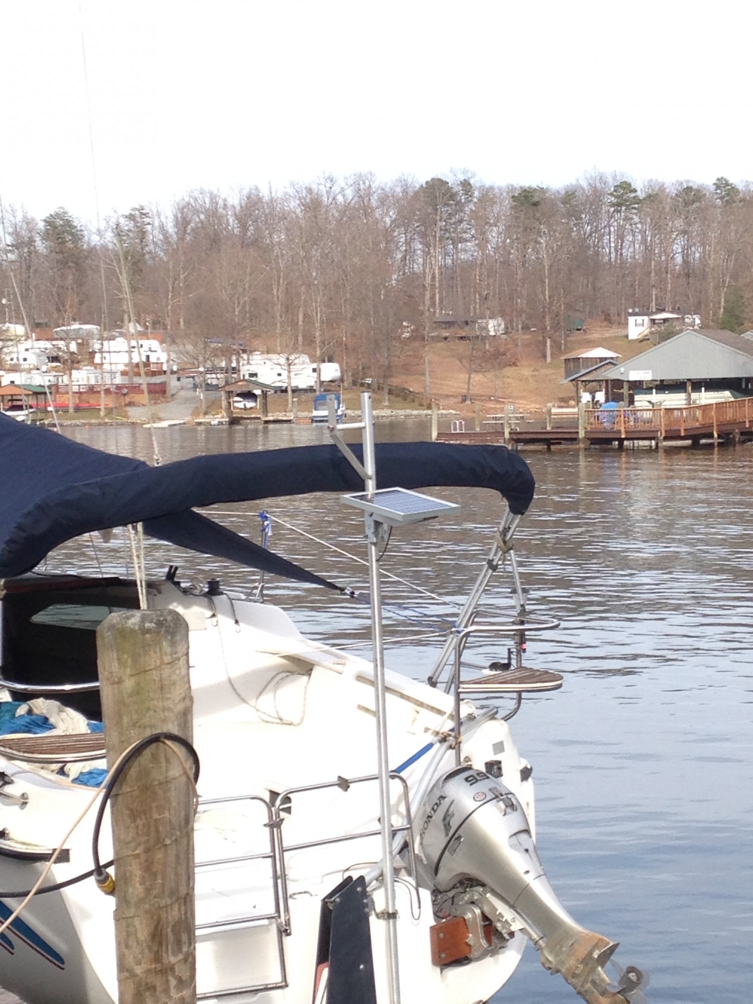

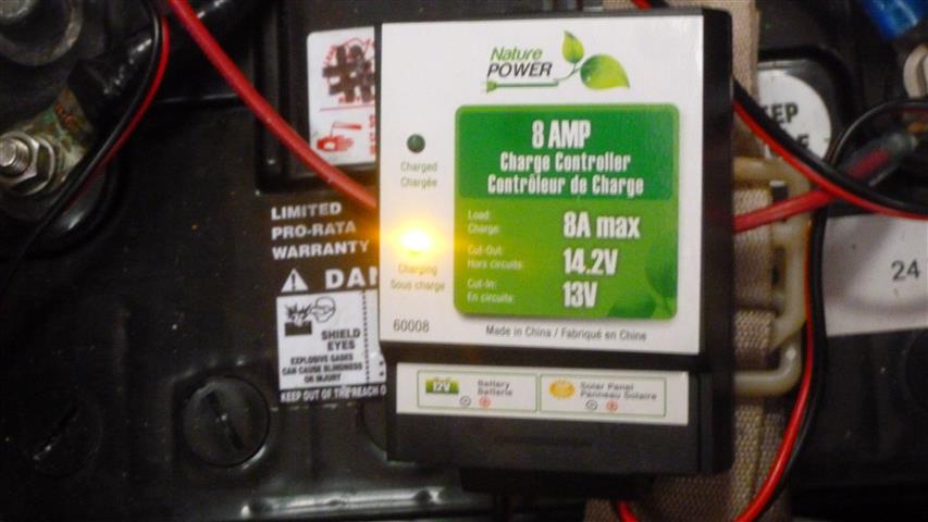

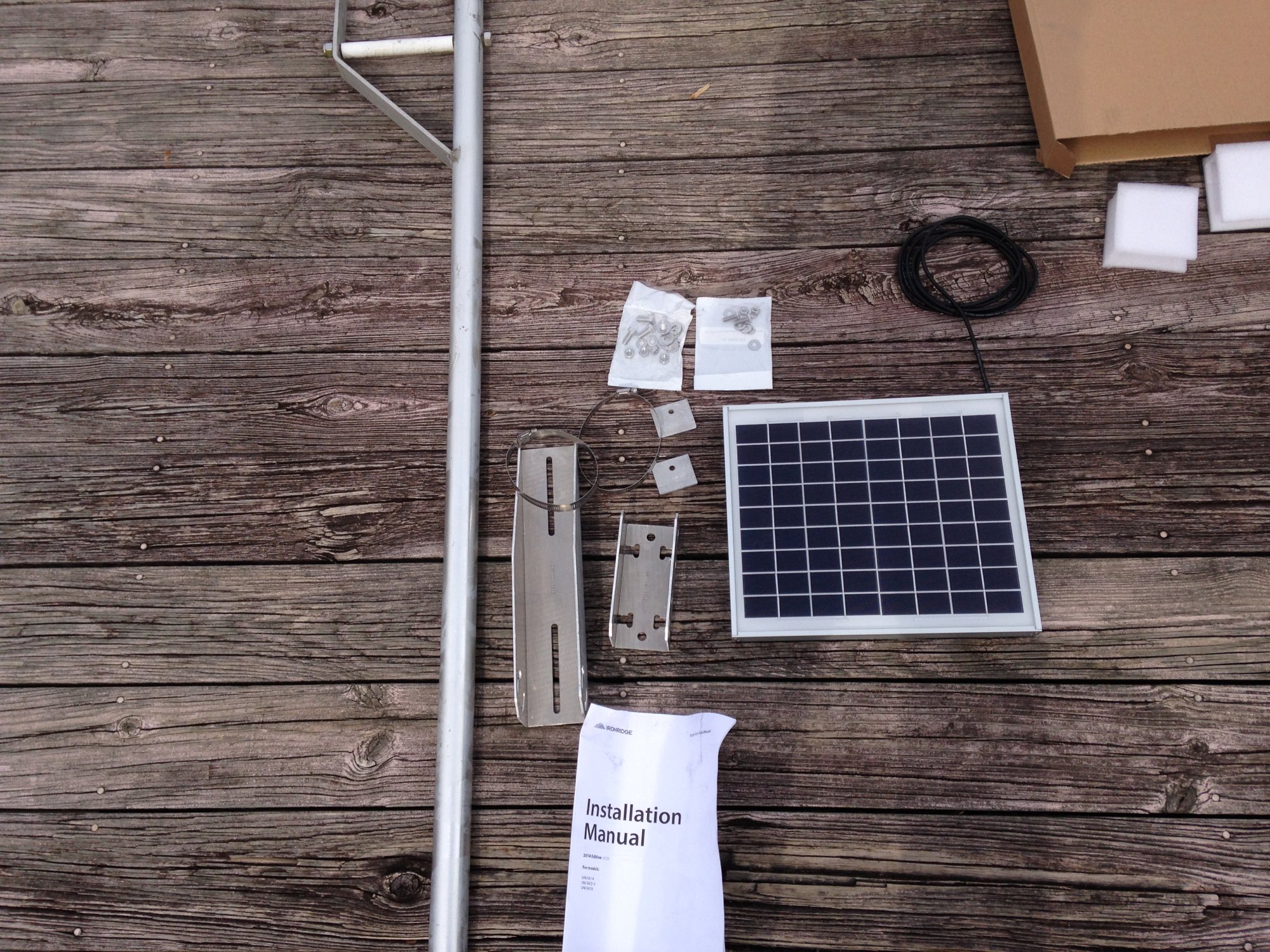

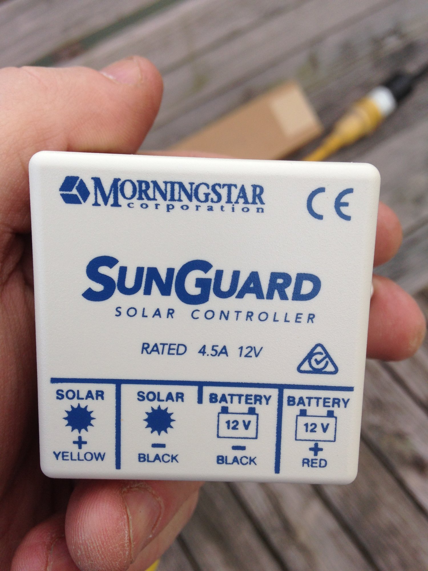

I think it was a 10W. I also had a 6A alternator on the Tohatsu so between the two sources, I never had issues. All of my bulbs were switched to LED and I had a VHF and some fans. The only other thing that I used the electrical system for was to charge my iPhone. That is all of the electrical I needed. I had two deep cells (probably overkill) so... it worked just fine.
Here are some more pics
  • Helpful
Likes: JamesG161

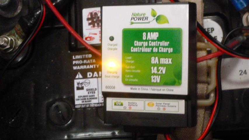

I have an old 11W (gasp!!!:)) panel. When I left SF to move to BC in 2016, I bought a $20 controller and hooked it up to my house bank. When I returned month later, all was well.
When this panel finally dies, and it will, I will just get a bigger one. The controller is good for 20W.
Otherwise, Dave, you're right about learning how to know your battery bank actually got FULLY charged. Unless one does the math, one simply won't know. But it's rather simple math, after all, like balancing a checkbook. :)
Very helpful - thanks! That sounds pretty close to my power needs - but no VHF and only one battery. I'm starting to lean toward just getting a 10 or 15 watt panel and some alligator clips. It's a slippery slope. :)
